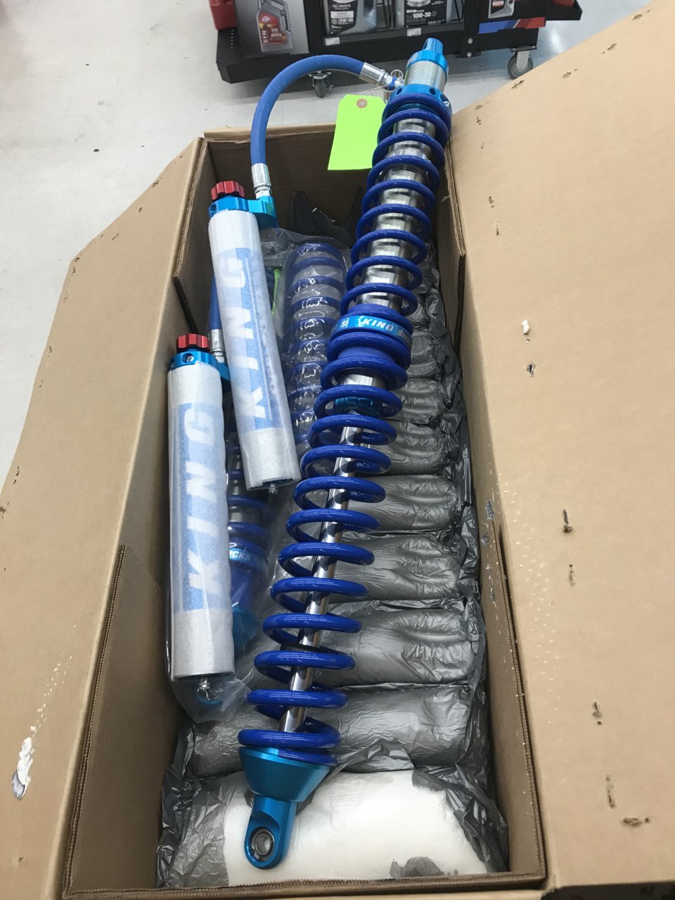

    1997 t4r has super duty axles, 5.13s locked front and rear. 3 link front with 14" kings. Rear 63s.
    I feel all warm inside

    Bruh what size DB lift that fit on
  12. Jul 20, 2018 at 7:04 PM
    Toyoland66
    Toyoland66 Well-Known Member
    May 10, 2013
    #103918
    416
    Colorado
    09 GX470
    Mostly stock on 35s
    Kings bruuuuuuuh!
