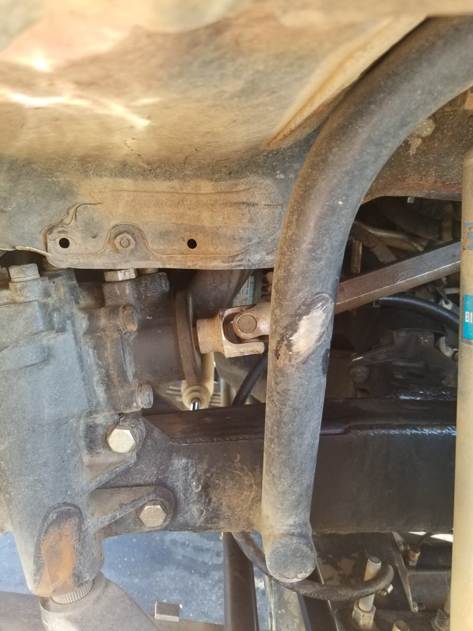

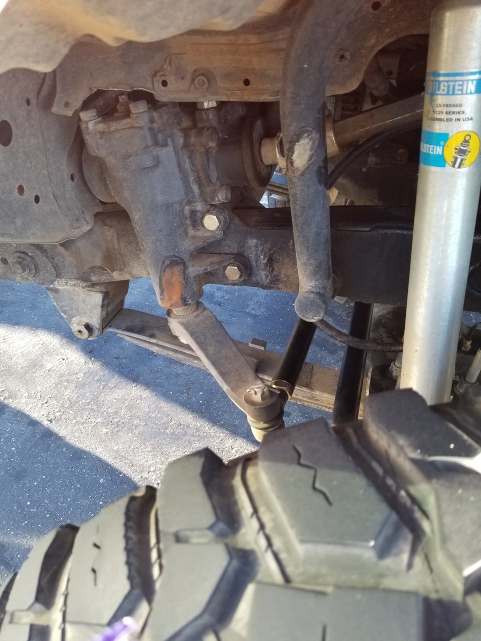

    Hey guys, I hope I dont get roasted too bad, I just bought a 2003 2.7 5spd with a trail gear sas, everything is fine with the truck except the steering is pretty bad, I've never been in a sas vehicle before but is that normal? Has a trail gear ifs box and axle, the guy didnt say much of what else, it has almost a quarter turn each way before the truck moves and likes to drive with the wheel to the left, but drives straight and doesnt pull so not alignment, really not sure what it is, my power steering pump moves a little while turning the wheel

    37's are fine. Steering sounds funky... Post pics

    Probably a steering box with a little slop in it. Not a big deal. Put an 1/8” of a turn on the adjuster if you want to snug it up. If you’re on leafs with not brand new bushings, the axle will move a little side to side under the truck when you steer and make it feel a little sloppy too.
    Just adjust your draglink to center the wheel. 37’s are fine like Supra said.

    Will do, also turned out it did have a stabalizer, I just didnt look good enough

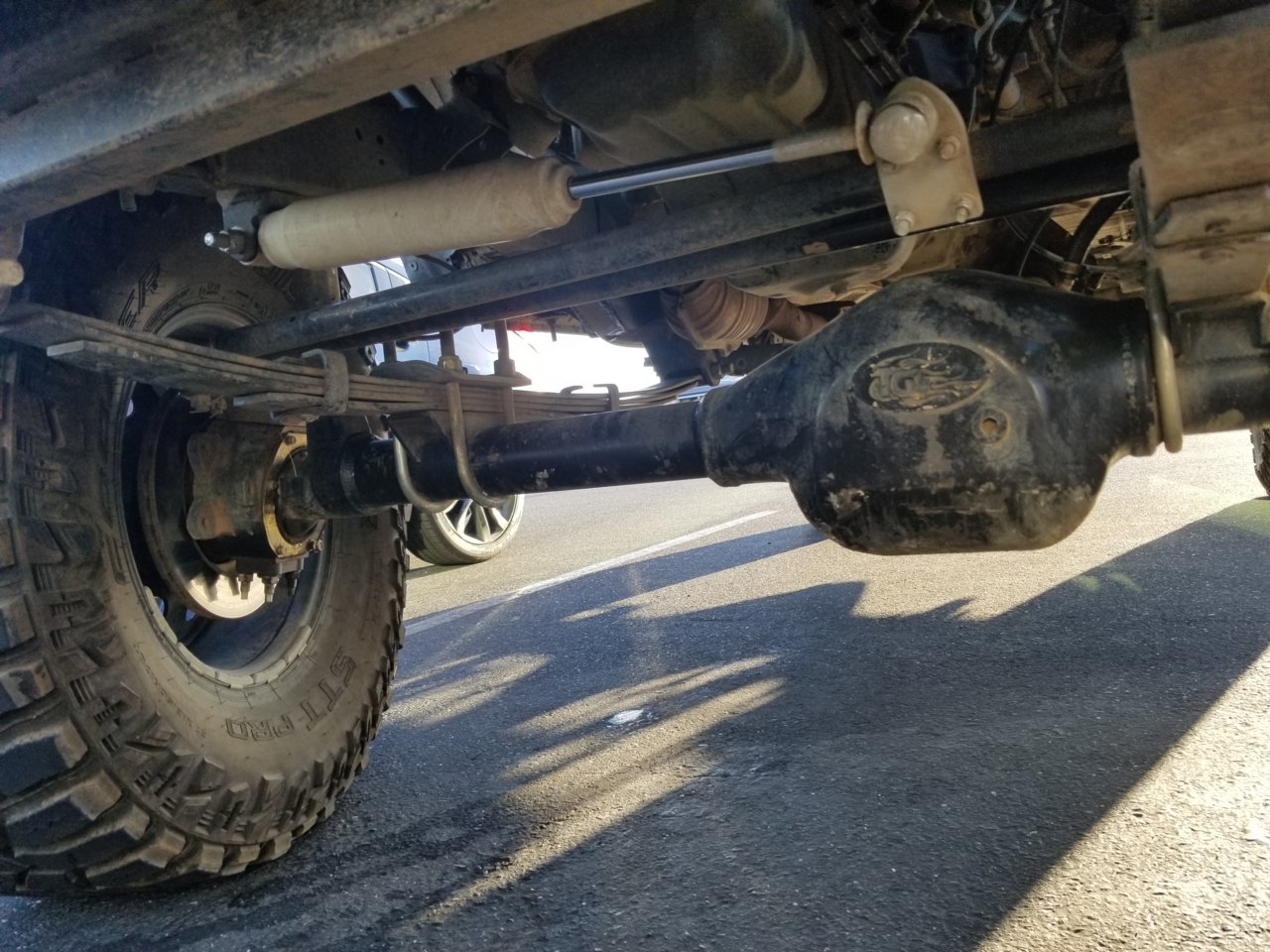

    Tire looks like it rubs the steering box too, hits the front bumper, u bolts aren't trimmed, suppose to have 14" shocks has 12, every single leaf pack is funky lol might have made a mistake buying as a daily

    Have someone wiggle the wheel back and forth with the tires on pavement and inspect each TRE, u-joints in steering shaft, and trunnions on the knuckle for movement.

    This is just the fronts too. The rear chevy 63's overloads are all crooked and funky, the driver side front main leaf is arced the wrong way at the end, the passenger side fronts leafs are crooked too
