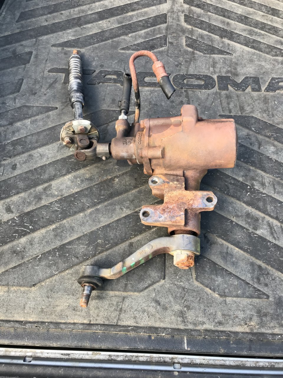

    How many of you have drilled and tapped a toyota ifs box for hydro assist? I have read/watched some stuff and it seems pretty straightforward but would like to hear other's opinion whether the level of effort versus saving $$ is worth it.

    I just got tgs pre drilled and tapped box. No core charge. No buying all the tools and parts and free shipping. It just made sense and wasn't worth the time to me and gave me an extra box. No issues going on a year now with it. No leaks etc.

    Ditto as @malburg114 I did the same because I spent so much time on the rest of the HA setup, just wanted to connect a box and go.

    Bought a 94 4Runner box for 70 at the junk yard. 33 for a rebuild kit, buying the tap and fittings is cheap. Less then 120 in it. Haven’t done the work yet

    There ya go, pretty much everything you ever needed to know for HA on a toyota. I got the parts from surplus center for around $200, damn inflation. Drill bit and tap are dirt cheap on Amazon, I think around 20bucks. Working on installing this, had to order a bunch of extra brackets and shit because I can't do anything the easy way and I built my POS with 2" of up travel.
