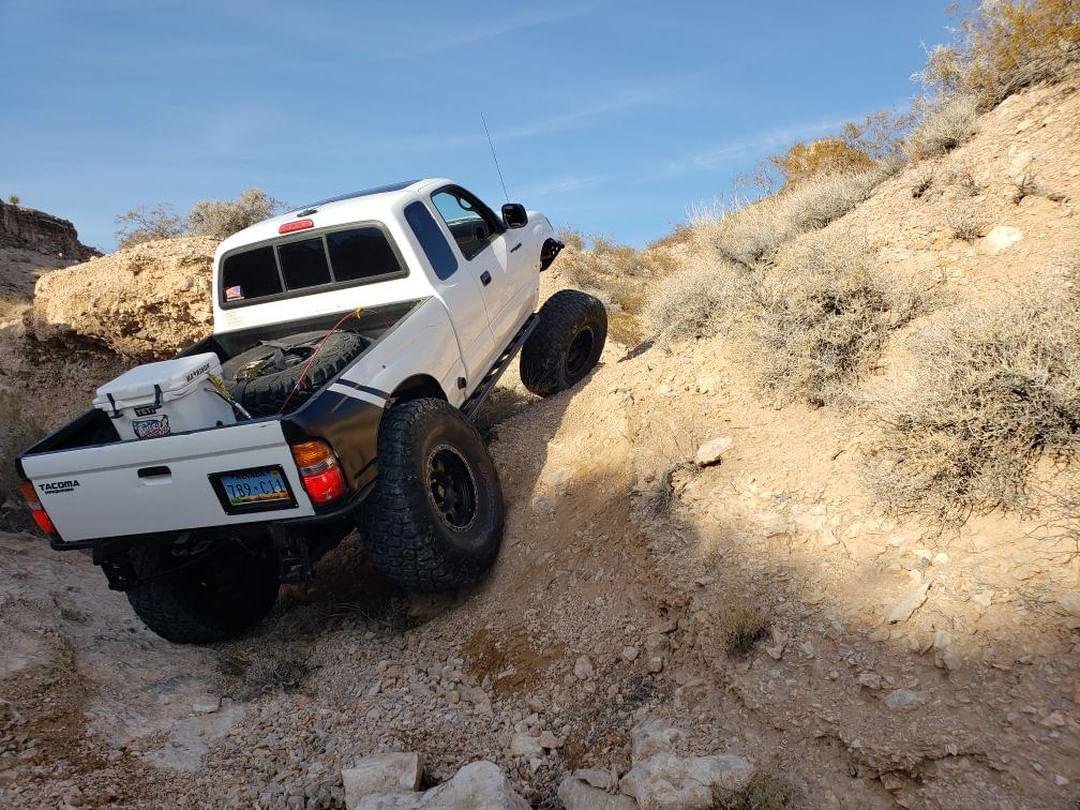

    Them tires look great on your truck dude.
    malburg114[QUOTED] likes this.

    Yeah haha

    Thanks man. Work decent as well I thought.
    Acerwin[QUOTED] likes this.
