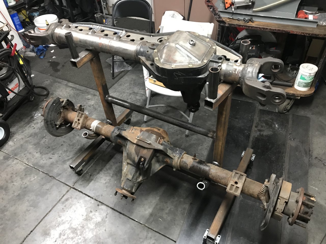

    1997 t4r has super duty axles, 5.13s locked front and rear. 3 link front with 14" kings. Rear 63s.
    Filling up with parts. Have 2 fj cases. One Has twin sticks and one is stock. Still have some more stuff to gather
    Nope. Gathering the parts pile for my one ton swap in a few months

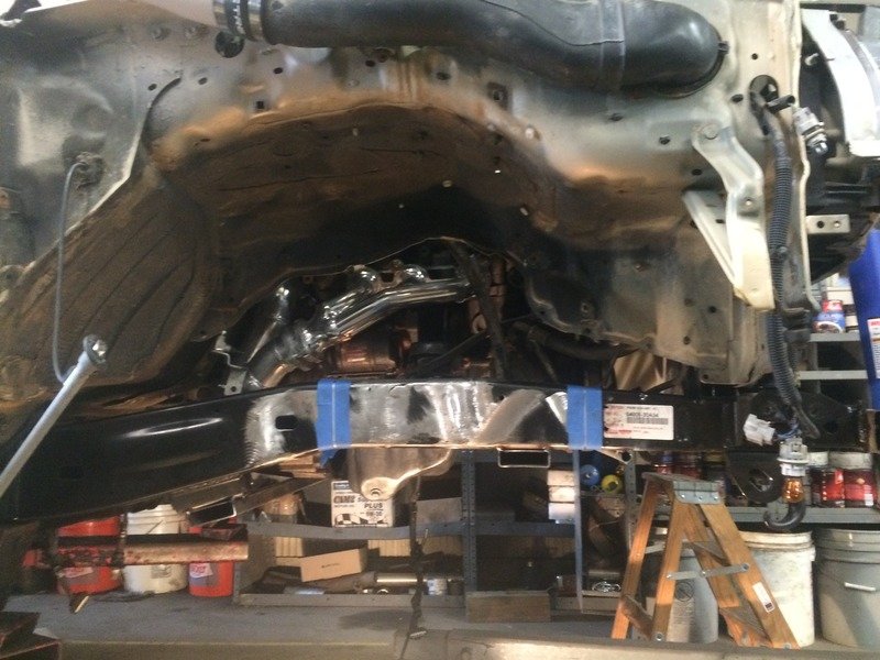

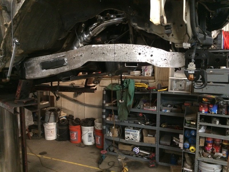

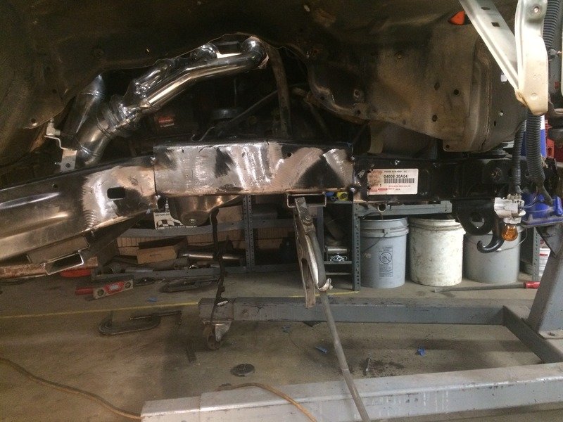

    If your leaves work fine then don’t fix what isn’t broken. That being said, the nice thing about links or radius arms is having the axle located under the truck by ridged bars and not floating under some bendy leaf springs. For me the handling improvement from that is the biggest benefit. Also I run an fj80 axle and use the stock steering setup with just a stronger tie rod and drag link. The tie rod behind the axle works fine with a 3 link.
    And don’t chop the front frame section completely off, just do this
    40568DE0-7BCE-4B6E-B799-96D011C18752_zps_585bfe3196c5a4dee5c0170bc295a97937aa2338.jpg
    2D46AB5A-BB00-49C9-B326-ADBBC997DB88_zps_b29056ed5ab88d45ece7647d51cd8c5745756b27.jpg
    2A98ED48-50B2-4B20-ACE2-E176752F7EEE_zps_d10bf2042b82655e0443cb1e428ffc92f7b4bac5.jpg
    Frame clearence and oil pan clearence In one shot.

    My frame needs to be chopped at the front to move the steering box more forward to push the axle up than for uptravel clearance. My tie rod and drag link barely clear each other as it is and I’d have to chop a ton out of the firewall to make a bigger tire clear.
    05-09 Superduty axles. 5.13s and Yukon lockers in both
