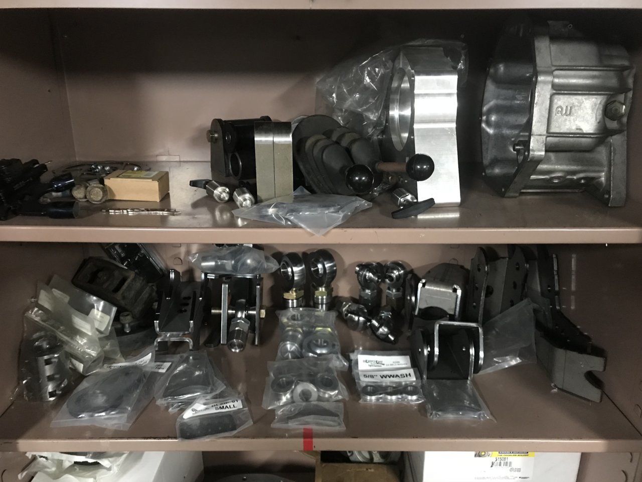

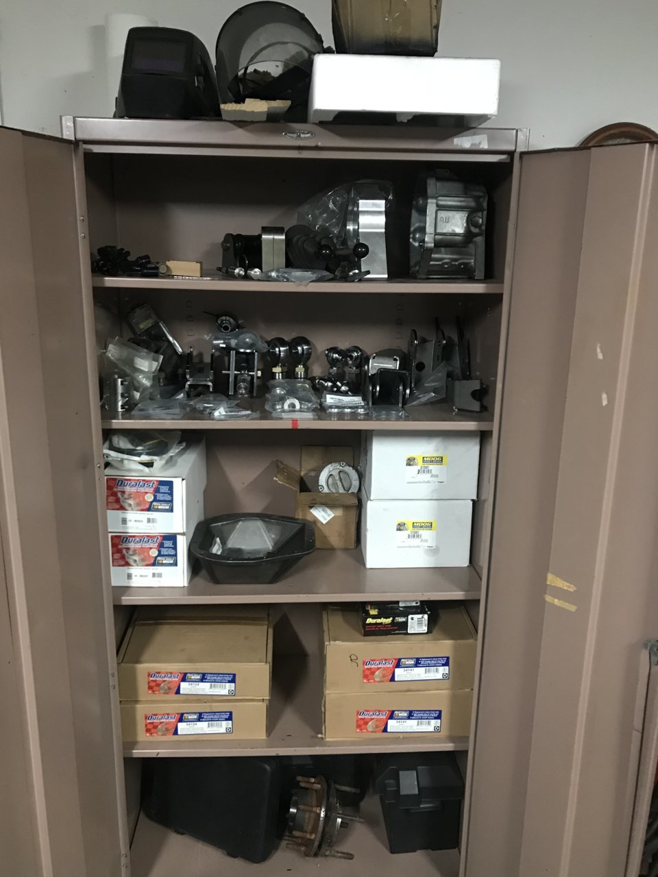

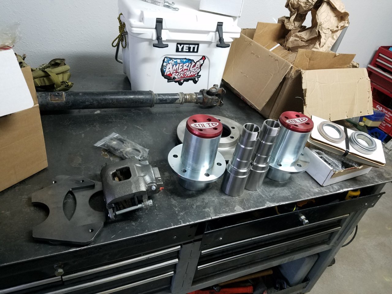

    Picked up a set of solid axle full float hubs and spindles with their brakes.

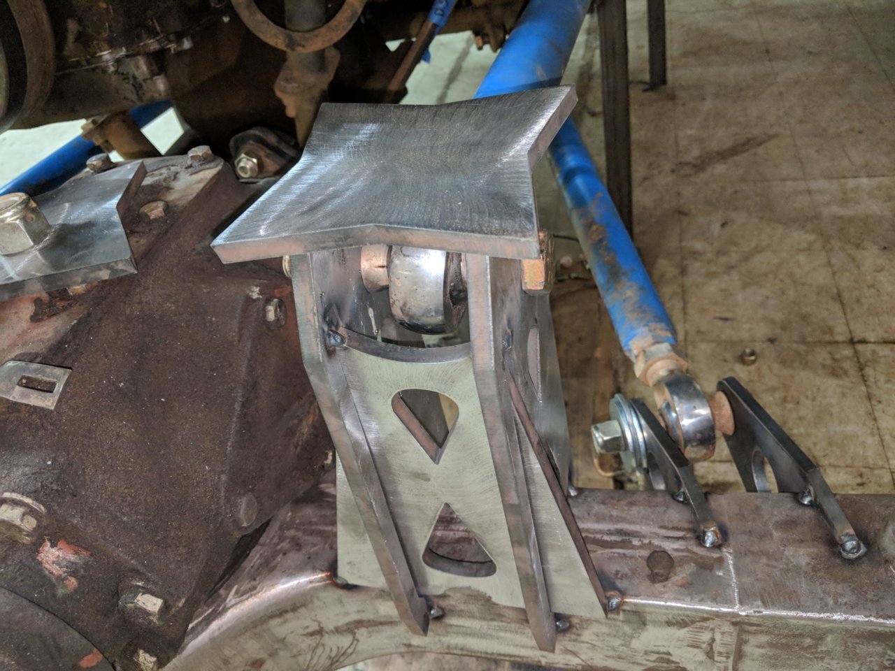

    2019 f250 6”lift 37s deleted 1997 T4r, tons and 4ds
    1997 t4r has super duty axles, 5.13s locked front and rear. 3 link front with 14" kings. Rear 63s.
    I bought everything separate. I didn’t want a 1.25 upper like the kit they sell has.
    My truss is Atrec, upper mount is artec.
    Ruff stuff I have both diff covers. All my Heims from them. Lower frame brackets. The upper adjustable bracket and panhard brackets. Steering kit from them also. Shock tabs from them and I’ll bend my own hoops and make my own tie in bar for the engine bay.
    As for the rear I already have the 63 swap done and will make a bastard pack to match the lift out of the front. And I plan to do 16” or 14” king shocks for the rear.
    Sterling 10.5 out of a 06 f250 5.13 and Yukon locker for that axle also.
