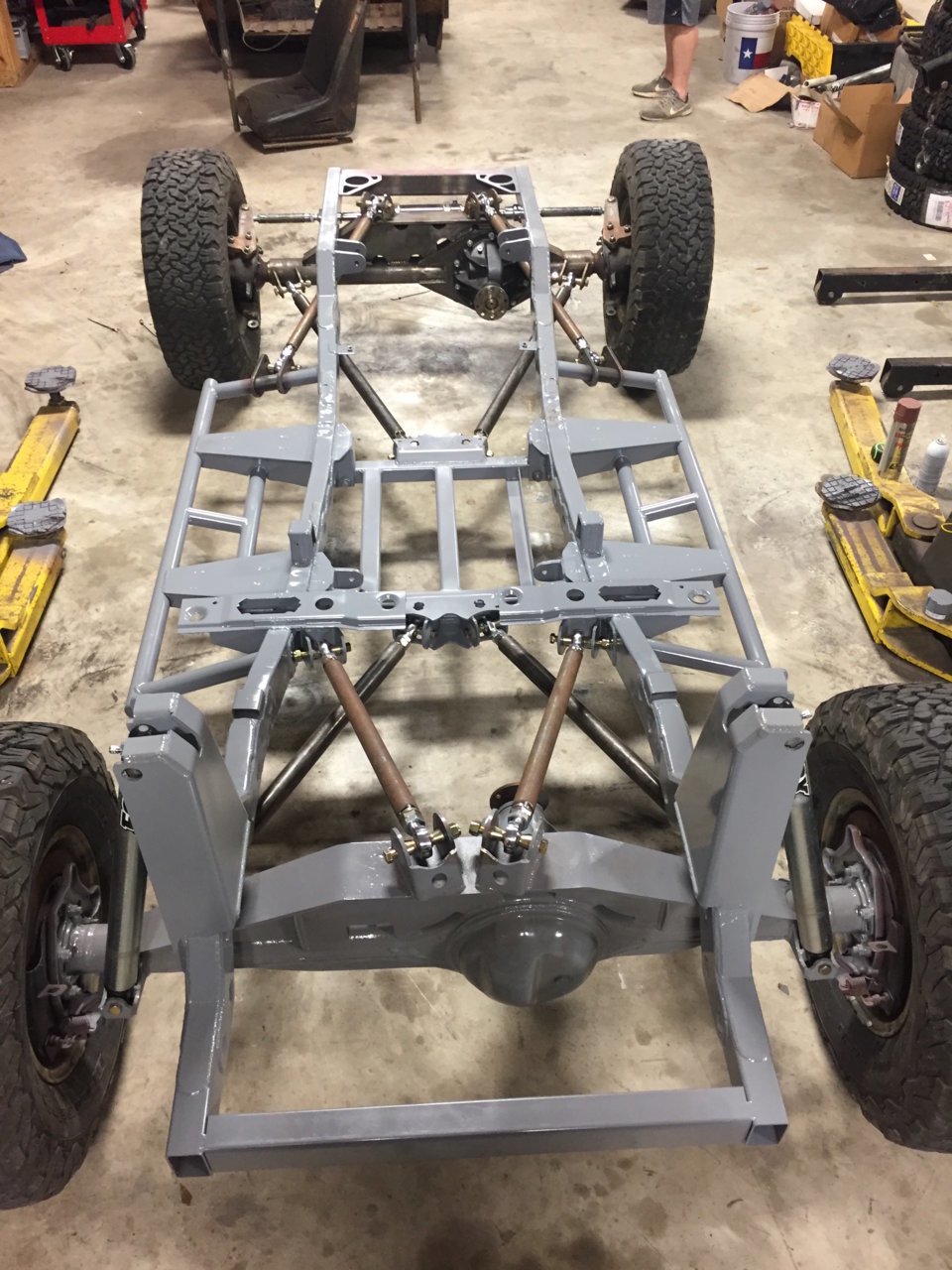

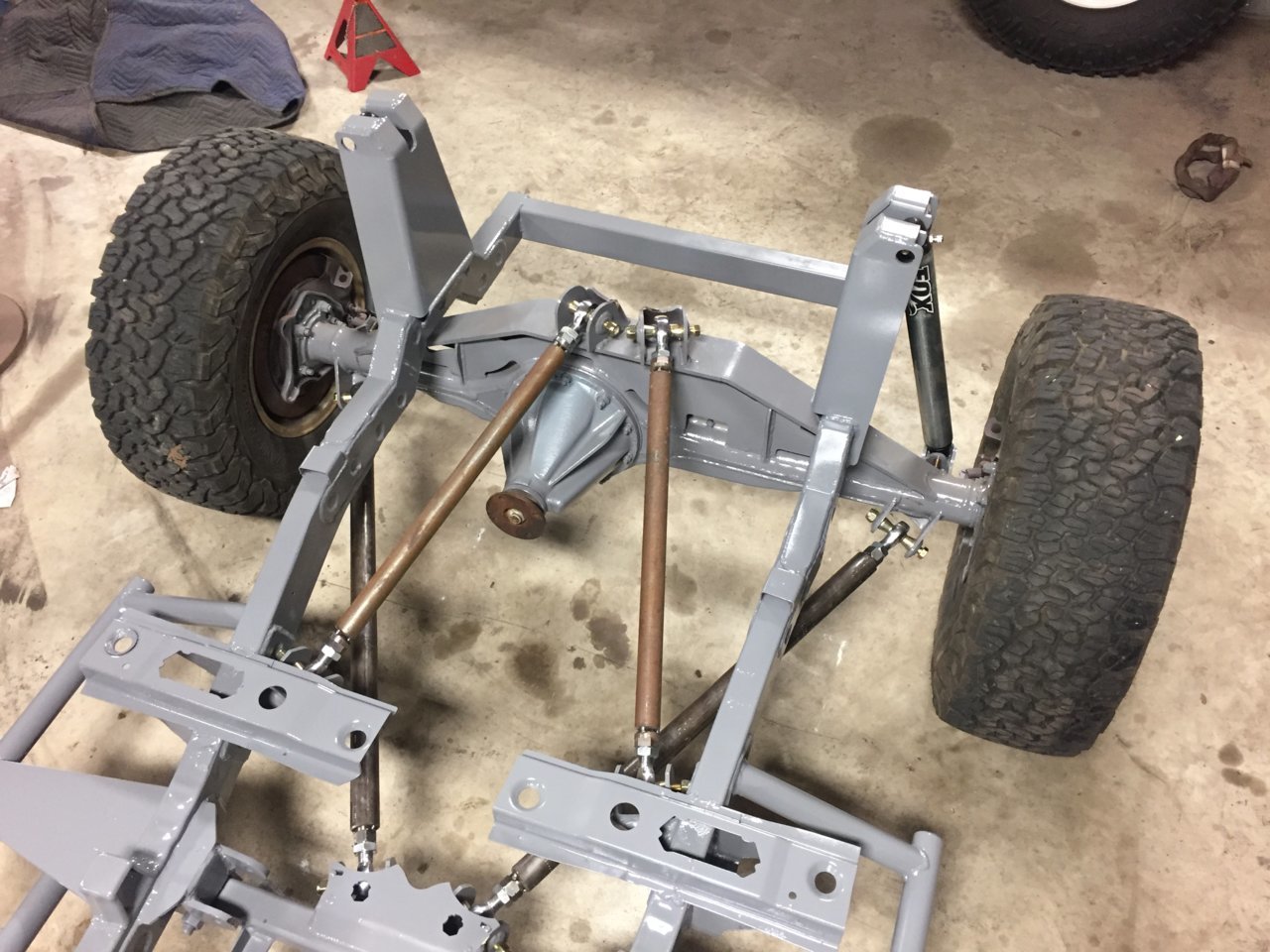

    Not much tacoma left.. But haven't been on here in about a year

    holy mother of god. rock on :mudding:
