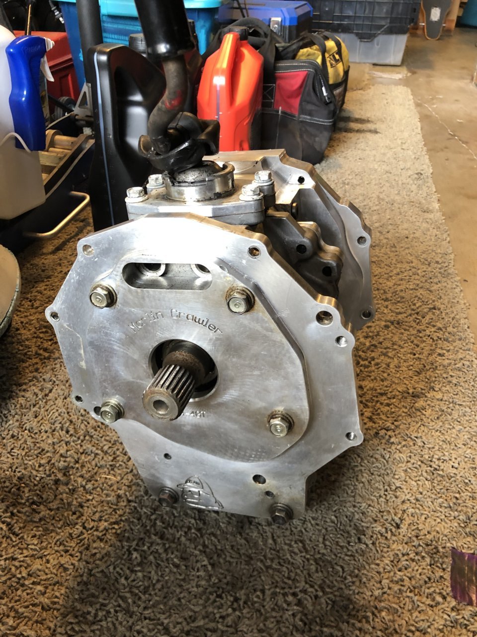

    Picked mine up off Craigslist a year ago. Just now getting the time to piece together the hardware I need. And resealing it of course.E830C4FA-CE6B-4419-94D8-F62081CAE102.jpg

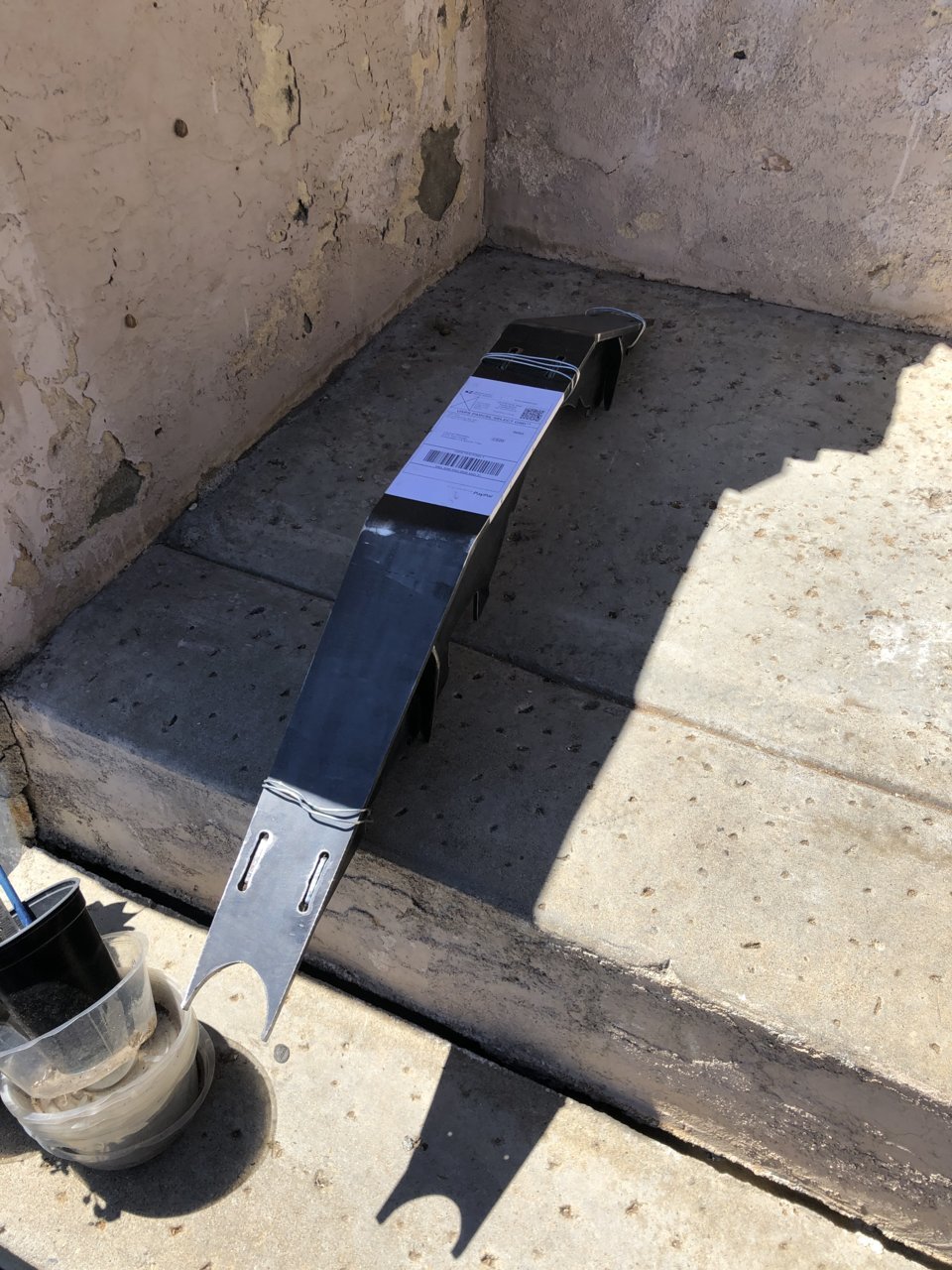

    Thanks to Trail Toys for getting this truss to me quickly. And grinding it all down so the tabs fit in the slots. I know how much of a pain in the ass that is, especially at this thickness haha
