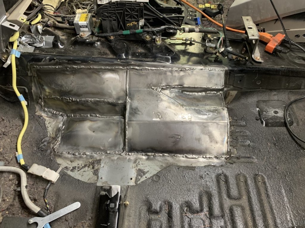

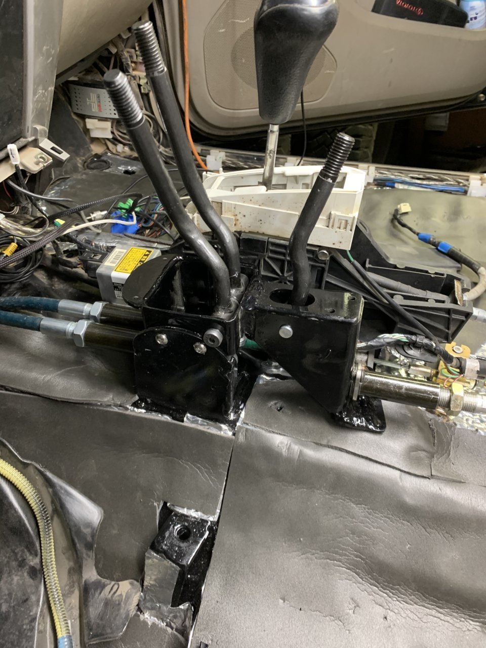

    Annoying yes, but not really that difficult, seat stayed in the same spot. In retrospect I could have left the right seat mount. 4th gen 4R, 4spd Atlas above the frame rails.
    Here’s what I did for the seat mount.

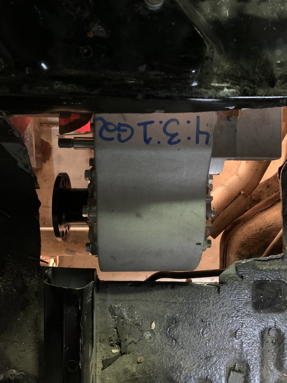

    I will add that with a 2 speed and clocking it flat you might be in seat relocating territory, the planetary pushed the main case back far enough in my situation to avoid that issue.

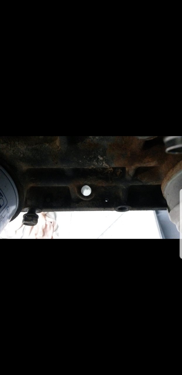

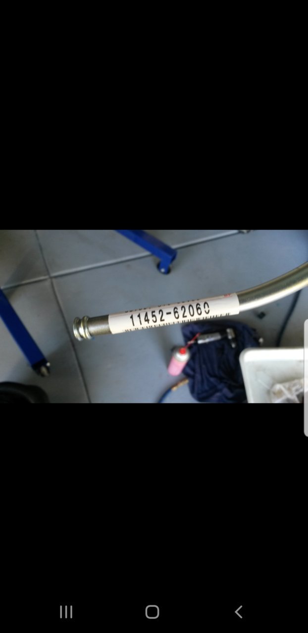

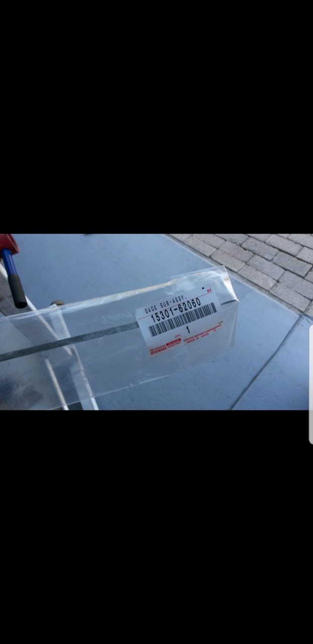

    By the way, where do you relocate the dipstick on a 3.4 when you change the oil pan? I couldn’t figure it out so mines in the stock location and it bottoms out.

    I just trimmed mine a bit.

    Same here.
    Mines trimmed alot as in I couldnt tell there is oil in there even if I wanted to. If the engine doesn't seize up, it's got enough oil, Life in the big city.

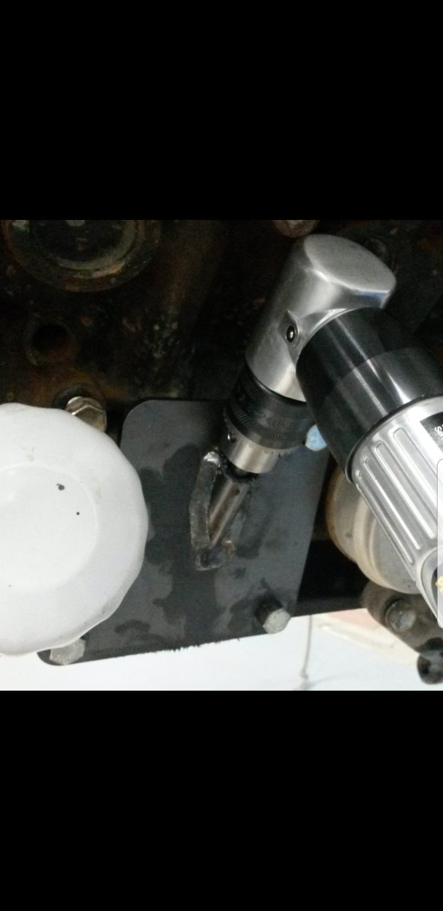

    Drilled the block and use t100 oil dip stick and tube. You still need the tube oring and sleeve/block insert. I probably have the part numbers somewhere.

    supercharged sas
    Thanks, you guys are awesome. Makes sense you have to drill, I was looking for a plug to pop out.

    1997 t4r has super duty axles, 5.13s locked front and rear. 3 link front with 14" kings. Rear 63s.
    My 97 had a plug in it. Knocked it out and put the adapter in. It came with a plug for the original spot and I knocked that one in.

    OTOH 95-98 have the plug, newer ones do not.
