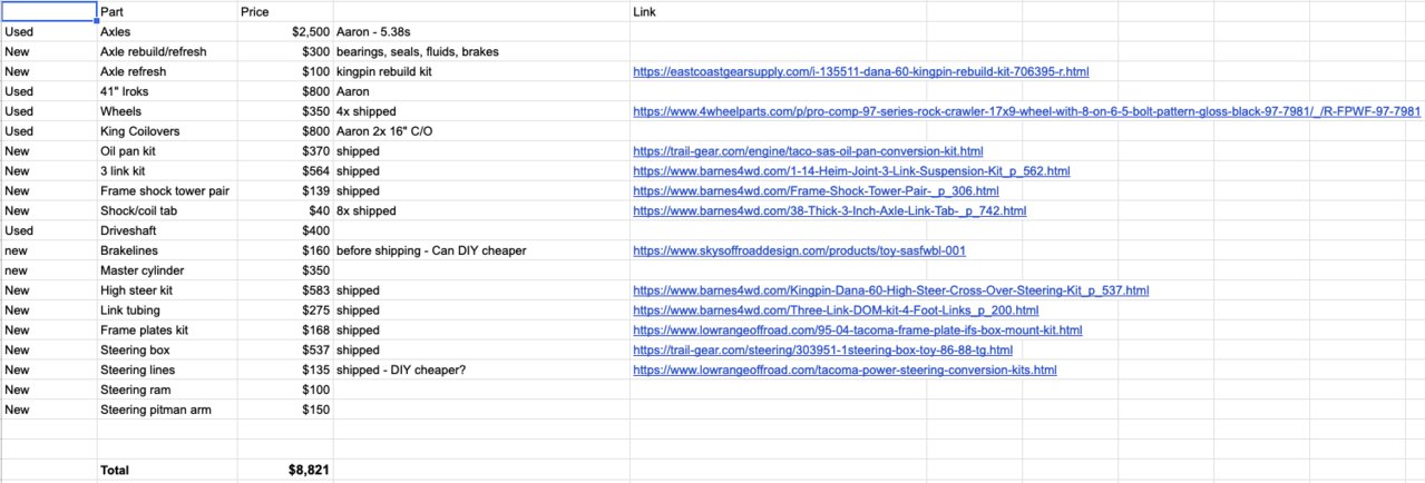

    From that other review of the 4WU kit it requires fitting and finishing anyways... for $1500 cheaper for barnes brackets/links/towers it doesn't make that much sense to me to go 4WU
    We'll see. Spreadsheeted $9k in parts alone (and I'm sure I'm forgetting somethings) so it's gonna be a bit

    Check out reckless wrench garage on YouTube. They setup a 3link on a ford ranger on a budget. Yea it's not toyota stuff, but some cool fab in a 2 car garage using tools we all have. 9k, jesus! I would just buy an already built truck at that point.

    $2500 of that is buying my buddy's geared/locked KP 60 and Sterling rear. I know a lot of this could be done cheaper (steering box, skip hydro assist, DIY driveshafts, have brake lines made locally)
