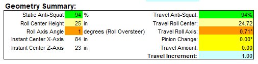

    I did SOA on my YJ and it would sound like a shotgun when it wrapped hard. I came up with a slip and twist design, but sold it before I got a chance to build it.
    Here's the numbers I came up with for my links, however, this changes with ride height significantly.

    I agree with slander. Let’s see those numbers. Not saying I think leafs are the greatest thing ever and not trying to do a dick measuring contest but a well set up leafs will out perform a decent link setup any day. Only area I lack in is uptravel but am more so still limited by the motor and frame than the leafs at 3 in. Will still drop a 39 in tire below the frame and keep going though.
    and I disagree with links being more stable. Think that’s more ride height and axle width. Screw up your anti squat numbers? Thing will unload on any climb. Have link separation or height wrong, will try to walk out from under the car under power.
    Next time you wheel with a jk or something linked, watch what the vehicle does when it’s put in drive. Does the suspension unload, when they pull away in dirt/sand does it leave little ripples like the axle is bouncing. Etc. all signs of a poor/not correct link setup.
