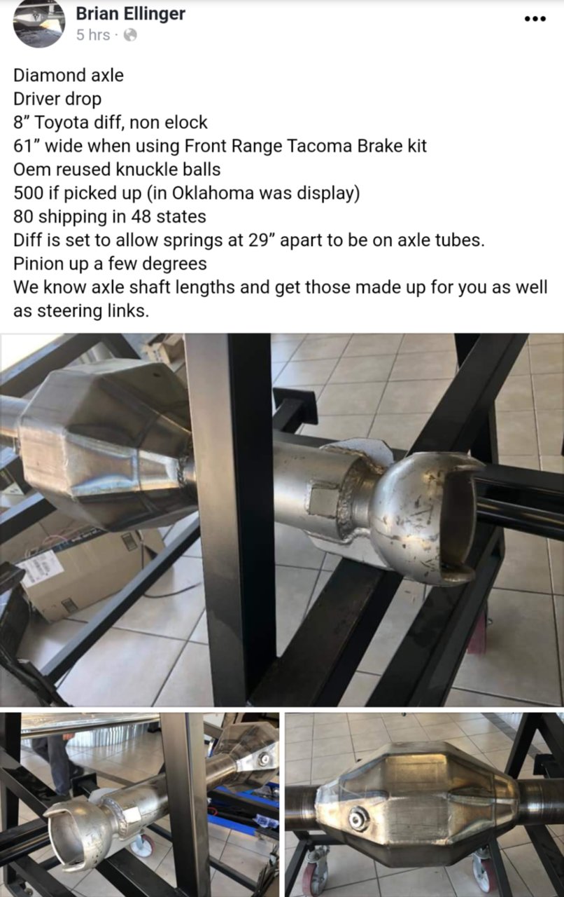

    I'll have to do the math again but last time I checked buying everything from Barnes was $1500~ cheaper than the 4WU kit for links/brackets/joints
    Of course a leaf spring hangar kit is gonna be substantially less than that :D
    slander[QUOTED] likes this.
  6. May 1, 2020 at 3:36 PM
    Wulf
    Wulf no brain just damage
    Jan 30, 2015
    #147523
    61,578
    rock raisin
    Sky's hanger with frenched shackle kit is what, $350?
    $100 for monotube shocks from the Monroe/Gabriel catalog, $150 worst case for junkyard leaves, $100 for shock hoops

    I thought about it
    After considering another $1500 for RCVs, $600 for a diff, knuckles, brakes, hubs etc it ain't such a good deal in my eyes
