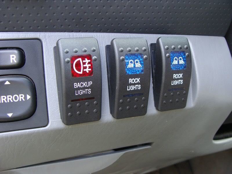

    Looking for some ARB styled switches that say (front lights/back up lights) anyone know a good place to get some?

    And getting the ADD to work ion the front diff. the lights are easy.

    Youo mean like these.... :D
    I'll try to find the link for you.

    Yes sir just like those.
