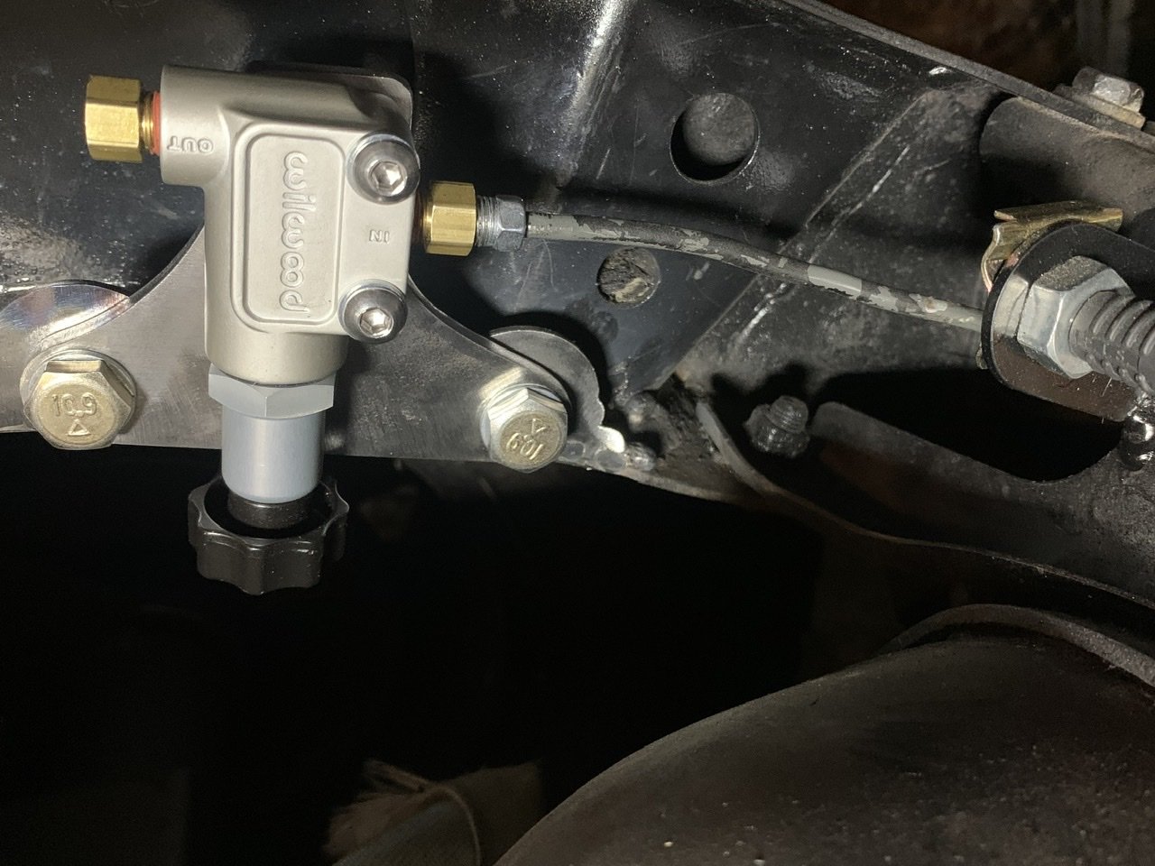

    Mounted my proportioning valve and put a 3/8 fitting on my rear sending hard line. Anyone with a 96-00 have rear disks - hard to find anyone with them and I’m curious what they felt like.

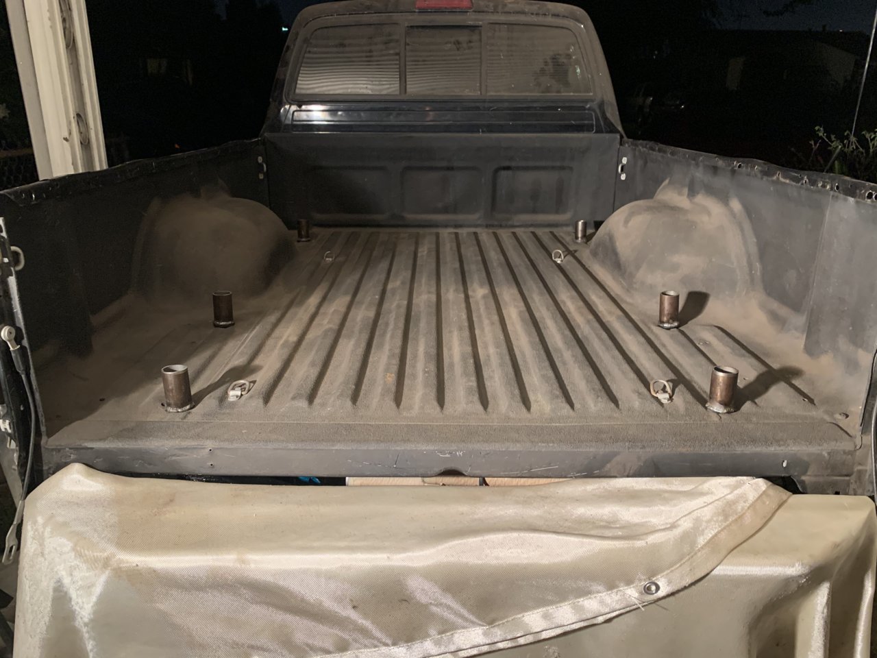

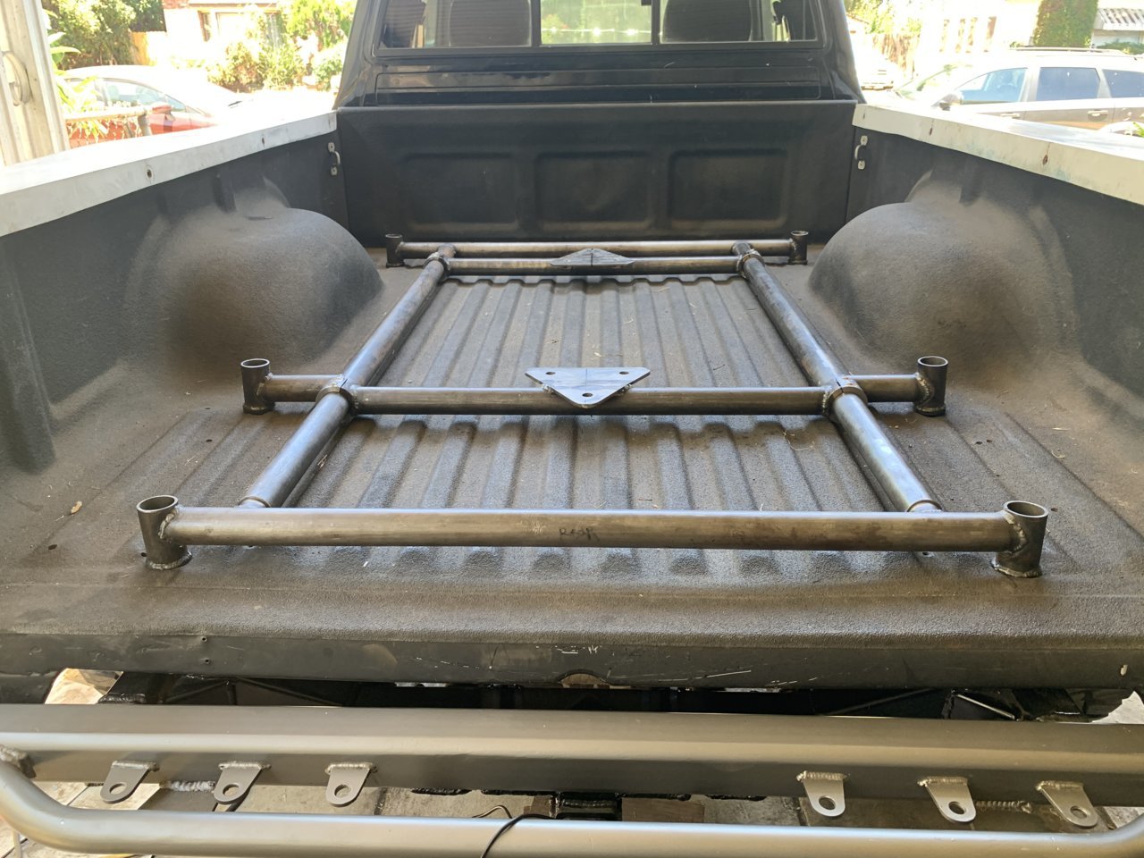

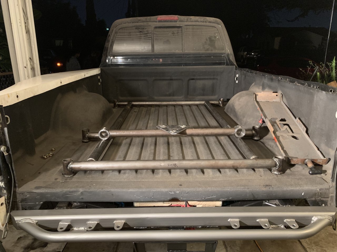

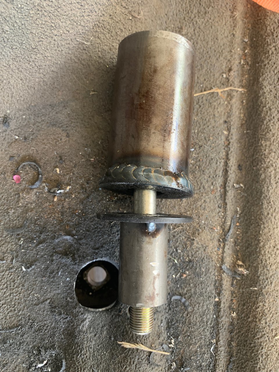

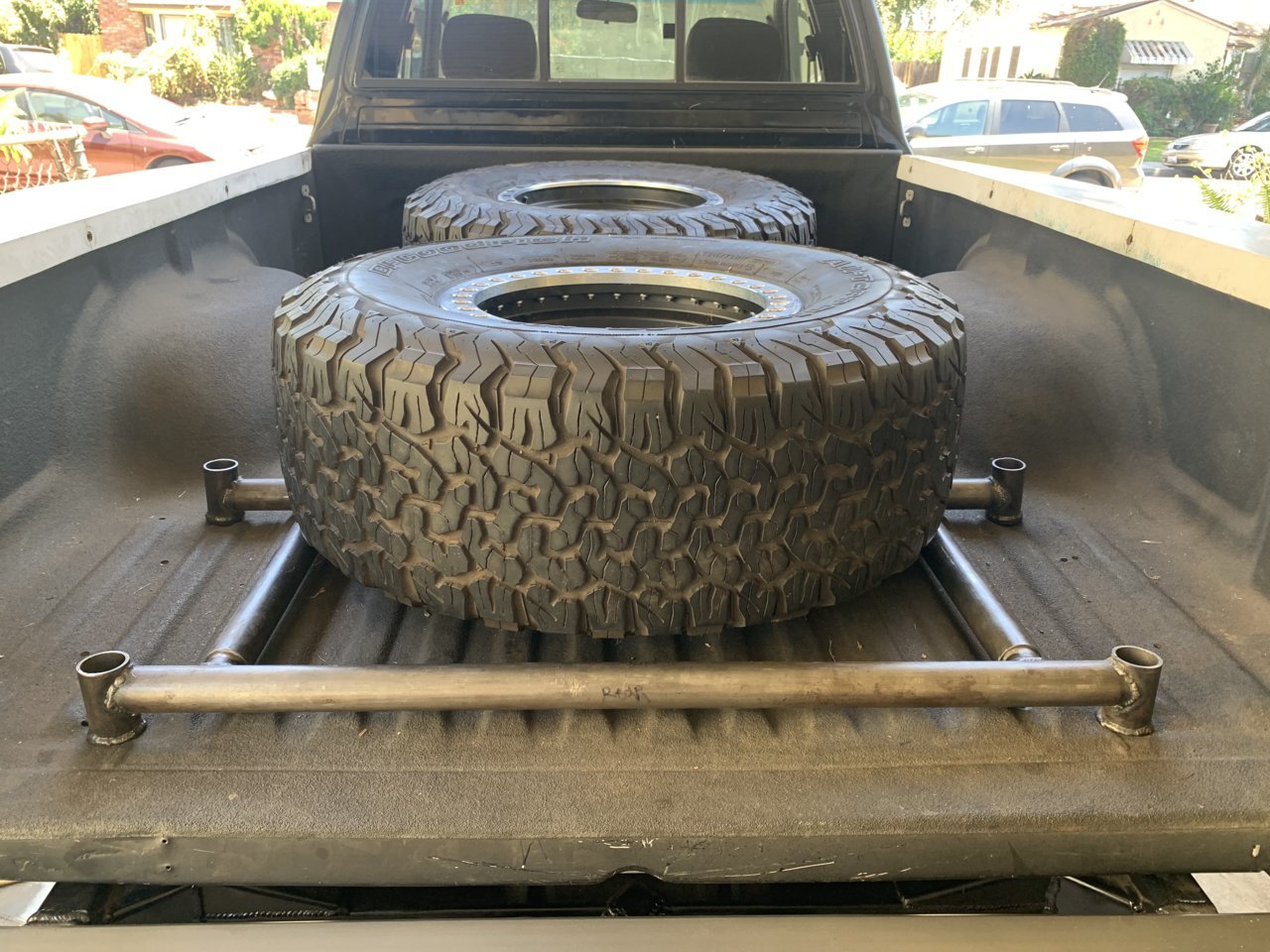

    Also may interest guys on here that like their bed but want more secure mounting points on it. Whole rack is completely removable and breaks into single tubes more or less.

    I'm running disks with the stock prop valve end zip tied to the pass side frame rail

    With tundra fronts and gm 3/4 4wd disks in the rear, nothing i did could get the pedal stiffness to come back. Had to swap to a gm master.
    Dalandser likes this.

    Pics? I'm thinking about getting a sequoia booster / mc to mate up to my brake pedal - have the tools I need to make a custom linkage, that said any savings I can get in sourcing parts / time / experimenting I'd really appreicate!

    I don't have any pictures but mine was the skys off road gm adapter, had to get a 95-00 booster (01 goes to a 4 post master vs a 2 post of 00 and older). I originally tried a master that low range sells for the skys adapter but was way to stiff of a pedal. Dad had a master from wide open design (1 1/8 vs 1 1/4 low range master) that i ended up using and was able to use the plunger from the booster if i siliconed a nickel over the master plunger hole to take the travel out. b
    bolted all up for the most part. was a huge pain though. brakes are stiff have a hard spot initially stepping on the pedal but they work well and now the rear cutting brakes will lock a tire up. At some point id like to try a different booster and a 1 1/16 master. I think that would be the sweet spot for what i have. No custom linkage or anything from mine. just had to trim down the threaded rod that goes from the booster to the brake pedal linkage to fit.
