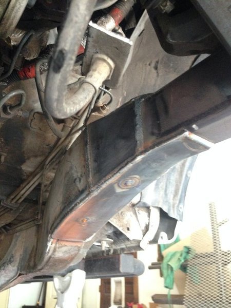

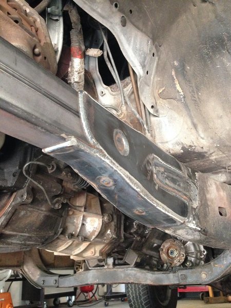

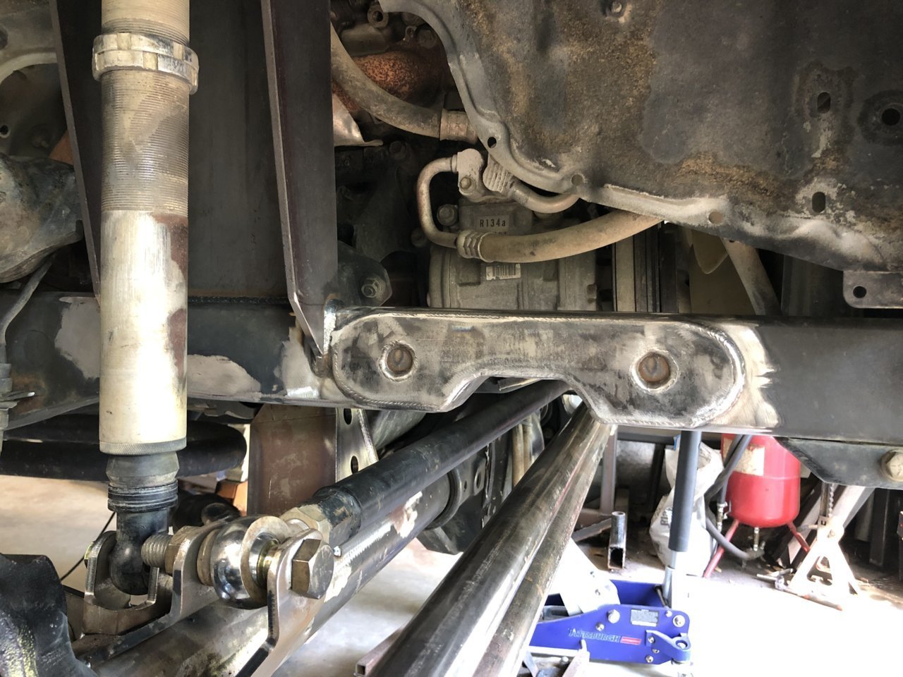

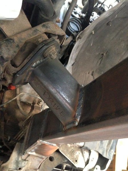

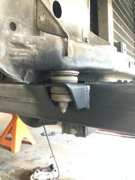

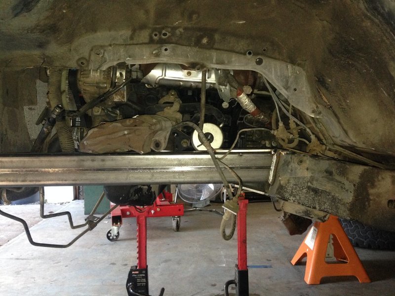

    Who has links/pictures of guys who cut the front frame rails off and remade them.

    IMG_2422.jpg IMG_2426.jpg IMG_2433.jpg IMG_2435.jpg IMG_2440.jpg IMG_2441.jpg B7A622F0-1930-41FD-8698-D47E3191CCB3.jpg
    ohcaltexscar, la0d0g, Pdugan6 and 4 others like this.

    Saw the alert and only saw this pic when I clicked
    laughed when that seemed to be the only pic that was posted (phone screen didn’t show others until I scrolled). Right on.

    Sweet thanks man. What size and thickness tubing you use? Assuming .188 wall?

    Check our my build thread, I also used Allenfabs and ZUK build on yotatech when I did mine.

    I believe I used 2x3 x 3/16 (whatever wall thickness that comes out to, cant remember), all my scab plates were 3/16 as well.

    Sweet. Does 2x3 slide in the existing frame?

    Yes but you have to pie cut the frame all around to get it to fit, I believe I have a pic of it and you can see it in allenfabs thread. You will see once you hack it off and stick the tube in there. If I had to do it again, i would raise the pax side up to clear the steering linkages when flexed. I narrowed my front frame which has some pros and cons to it.

    As slander said, 2x3 3/16” and it slides in loosely, so plating and all that will be needed
