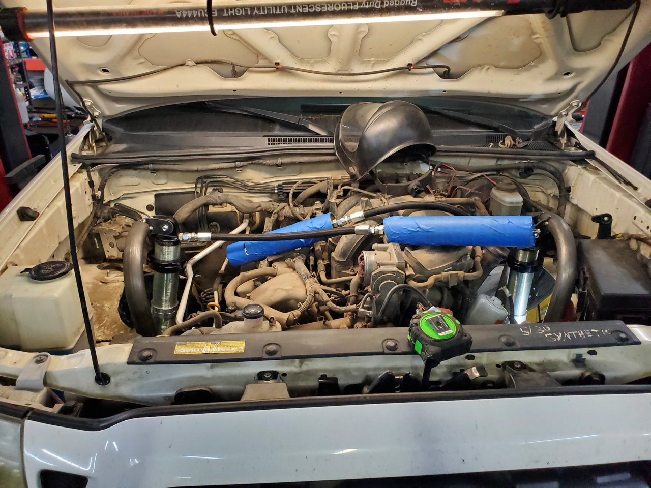

    About 2” of clearance.

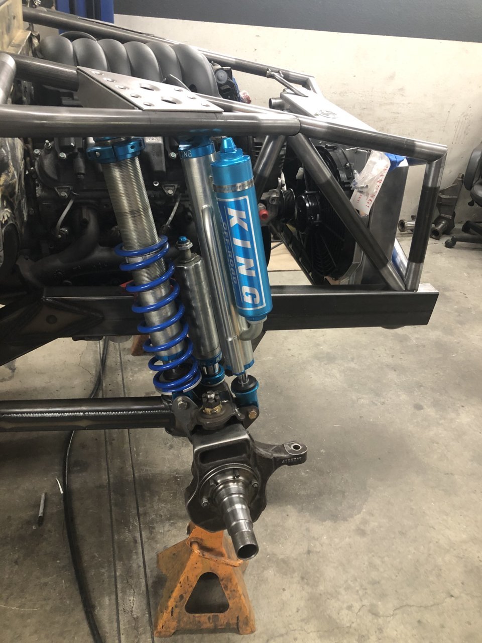

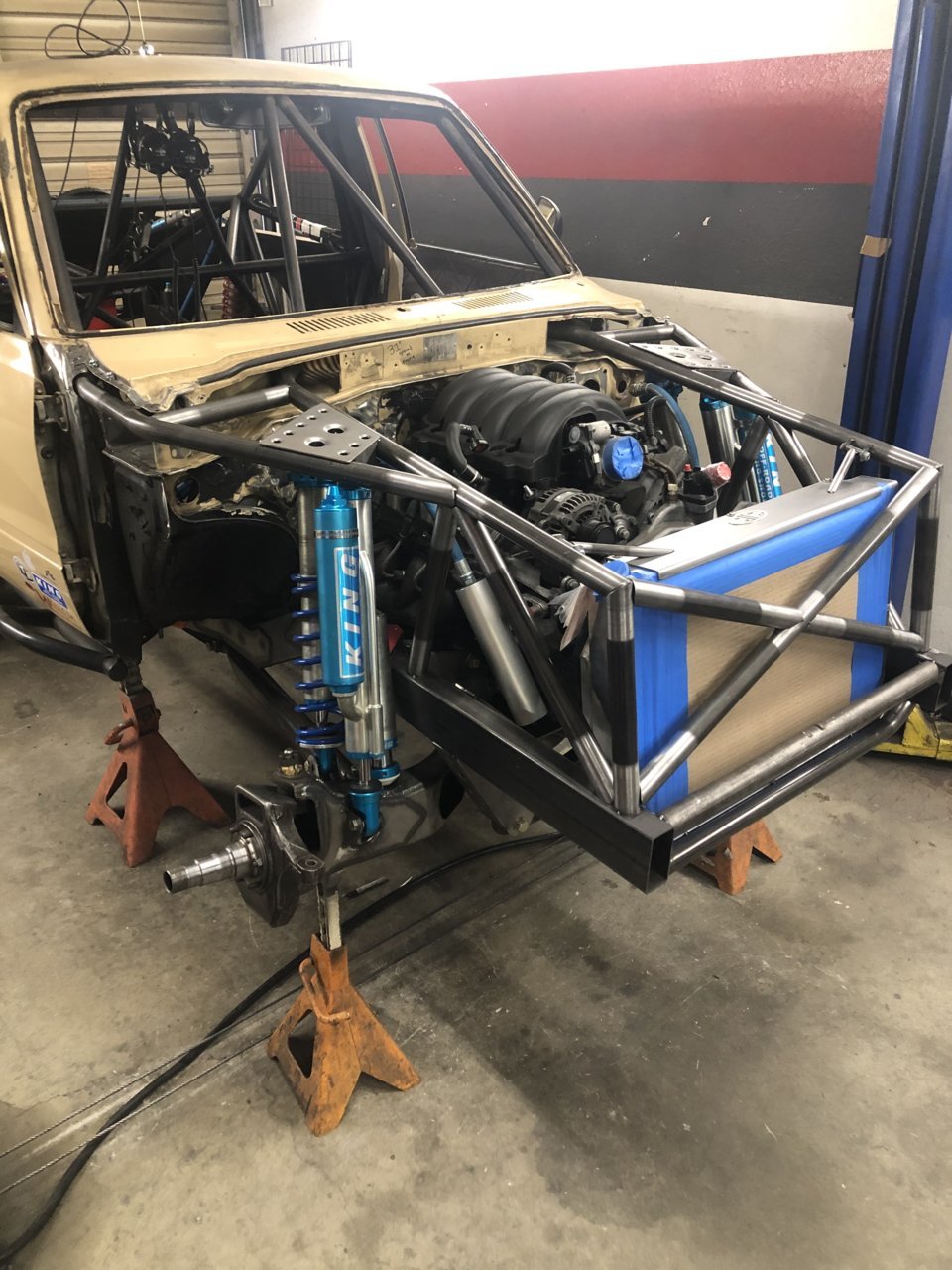

    I’ve seen very few Tacoma’s with a coilover and bypass mounted side by side on a front setup.
    here’s a photo

    So question. Why are they mounted on two different levels? Coil over seems to be lower than the bypass? Is it cause of the angle and lower mount is angled and they both still bottom at the same time?

    Because the shocks are angled rearward it appears they are mounted at different levels. They both bottom out at exactly the same time

    Are they mounted rear ward so at drop they are at 90 degrees? Or because of packaging restrictions.

    Changes the leverage ratio so I can get 18” of travel out of 12” shocks... also this is a TTB front end, not solid axle
