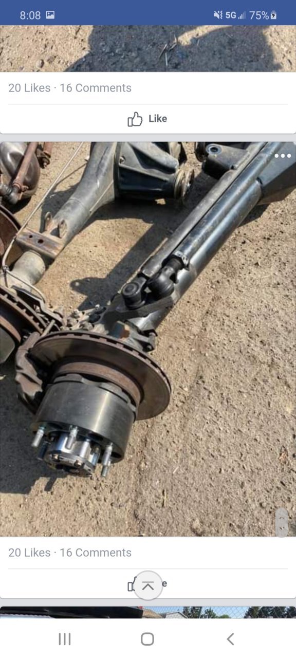

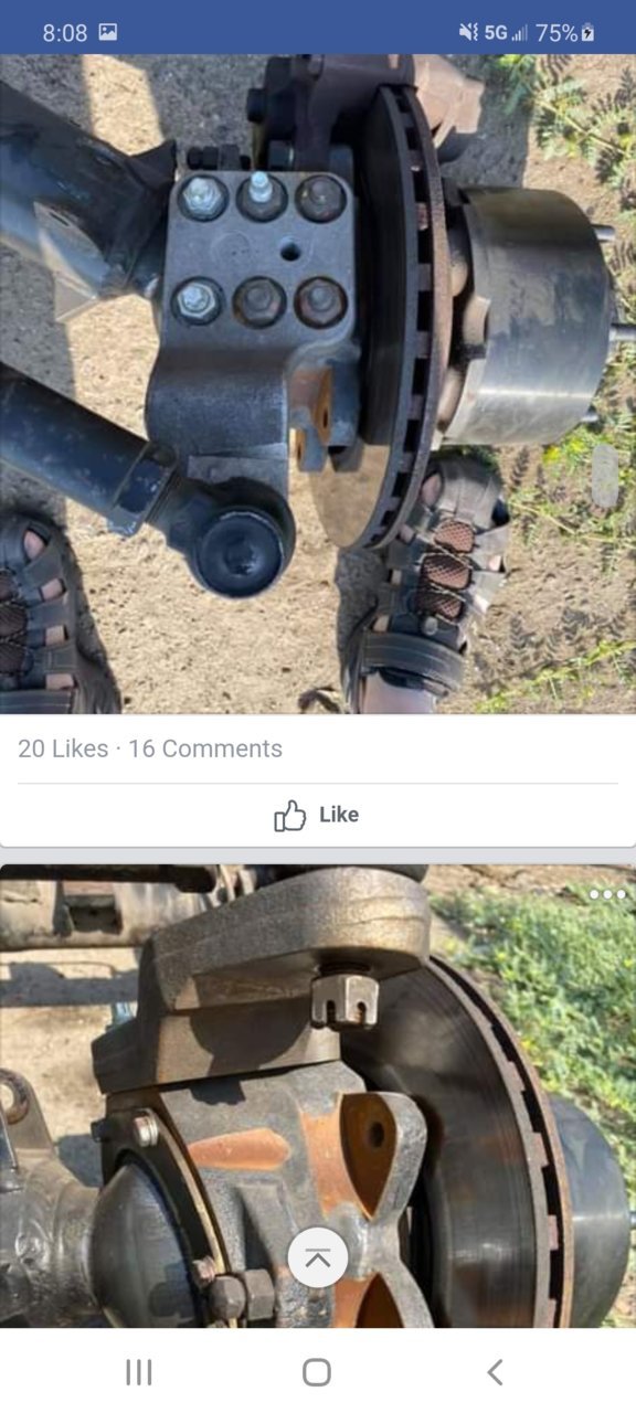

    The set at northside4x4 in Clovis, CA with 6 inch wheel spacer per axle for $4k?

    I would offer 2k and negotiate from there. IMO cost new doesn't matter at all, it's used and you have no idea what the condition is or if was even assembled correctly.
    I would keep reading about solid axles, it's like college level mechanical knowledge and not for noobs per se. It's a crap load of money and work and you have to maintain it and fix it when it breaks later on. Not a dig at all, just letting anyone that's reading this know that if you are not comforable wrenching on your own stuff, stay IFS and on 33s.

    Why the hell would someone use a custom housing then slap 6" wheel spacers on it???

    That's what I said, LMFAO. A mall crawler.....

    A dipshit that's who! I would offer them $400, who knows what other hackery is going on with that thing if they pull something like that. If I was a shop I would be embarased to even have my name near it.

    That’s California shit there widest wheels with spacers looks really cool in town haha

    You didn't know. The bigger the wheel spacer, the better it is to cruise the parking lot

    Yes this is it.
    Correct. I don’t know this area so I didn’t know what this axle quality is. I do know that I still have to source the remaining parts. Someone mention I could get most of the other parts from the TG kits. That and I don’t know how to weld. Even if I was learning I wouldn’t want to attempt this at a novice level. I asked someone how much they would charge for labor and they said $4k, I thought that was high?
    other crawler and fab shop chime in and said it was a good deal. Someone else poked at the spacers too but I didn’t think much off it because I don’t know better. Unfortunately this shop is one or the main one in the area for offroad/Toyota related work. They’re also swapping out for tons.

    4K for labor is low in my opinion. I did all the work myself so can’t really help there.
    That’s probably not a bad deal for front and rear axles considering I’m asking 5k obo for my front alone and sold my rear for like 1250 or something with a similar build sheet.
    front would definitely need to be gone through the knuckles. Those trunnion bearings are probably not happy with those spacers.
    those axles would be plenty strong enough on 37s and probably even a light 39/40. I made mine live with bad axle wrap and a heavy foot under mine with no issues.

    Aren't these axles from the black first gen double cab the current owner bought already solid axle swap few years ago and had his rear swingout bumper built by Brute Force?
    If you don't know how to wrench, I wouldn't recommend going the solid axle route. It is stronger and better than IFS but will do you no good if each time you have issue, it's going to a shop for repairs. Also, if you prefer having a quality ride, the front leaf spring and solid axle setup is definitely not designed for that purpose.
    A built IFS with 35 or 37, selectable front & rear lockers, sliders, etc can handle and go on almost all the trail without issue. I'd seen IFS tacoma picking the same line as solid axle guys and make it as well up as obstacle.
    For God's sake, someone please remove those fugly spacer! 3" per side, holy cow. Spend $4k on axles + $4k on labor + another $2-4k on parts is not worth it unless you can do the work yourself. Plus, with the disc conversion in the rear and no ebrake setup, you won't be able to run offroad hosted events. Most event host will check and make sure the vehicle have a functioning ebrake.
    If it's truly a good deal, those axles would sold quick. At the end of the day, it's still a TG axle with wheel spacer and a face lift.
