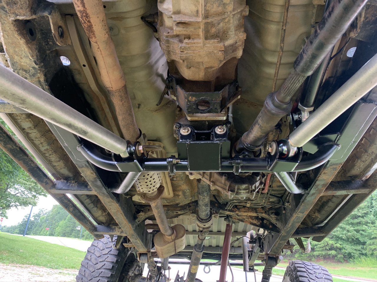

    Finally found the pictures. He ran a driver side upper. Thinking that’s my only real option if I want any real uptravel.

  2. Nov 27, 2020 at 4:37 PM

    You're gonna have to move the exhaust closer to the frame to get the upper to clear everything at full bump.

    I’m going to try to squeeze it over there. If it turns into a ton of work and remaking the exhaust I’m just going to truss the axle and build an upper off of that. Way more room on the driver but it may fit on the passenger with some decent placement. We will see. Cs come on Sunday finally

    I may have missed this, but why are you wanting to run it on the passenger side?

    Be easier to package and transfer cross member is in the way on the driver side. Transfer case crossmember is the main reason to prevent redoing it/moving the upper to far forward.

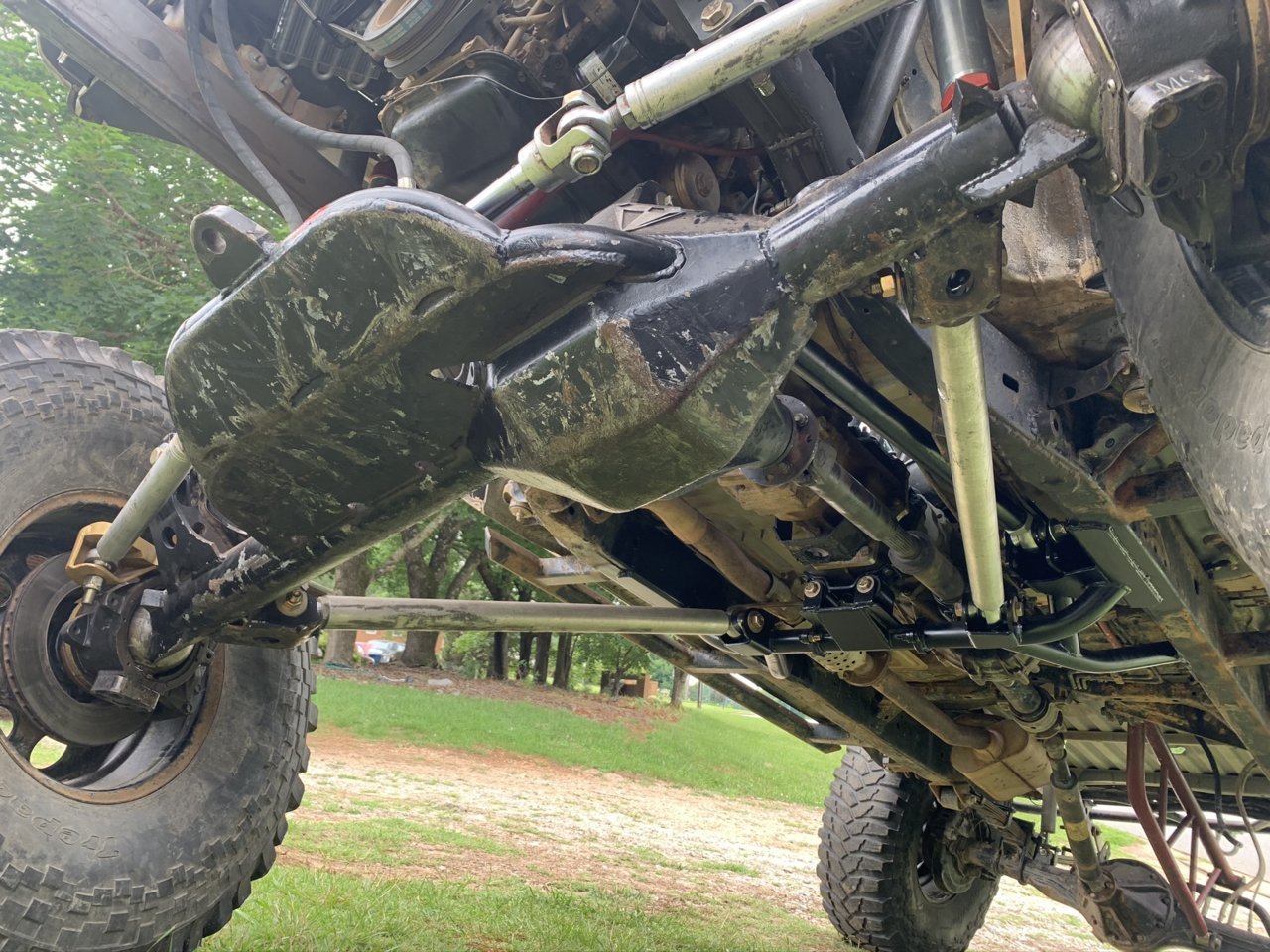

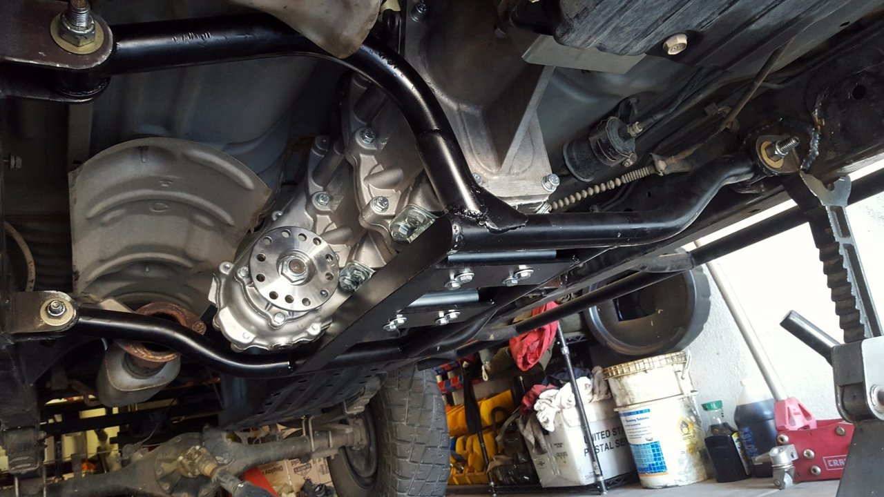

    Gotcha. Yeah we did one a while back and built a new crossmember and planned a drivers side upper all along. Made it much easier to package everything.

    It wouldn’t be a ton of work for me to make upper fit on the driver but I’ll try to avoid it for now lol. You can see the hoop we did to clear the drive shaft on the passenger vs the driver. But with all that I’m not willing to loose the uptravel so if it’s a big difference I’ll move it over.
    what’s the wheelbase on that and link length? There’s some holes in the frame I’ve been using as a reference but you have fish plates over them. Yours is the 3rd or 4th with thr lowers that triangulated on the frame side. What are you gaining by doing so? Would be a ton of work for me to do but if I have to remake the transfer case mount I may consider it.

    That was a buddy’s rig. We used my shop to do his 3 link.
    Triangulating lower links takes some load off of the panhard and lowers the roll axis, reducing flex steer. - paraphrase from Barnes 4wd.
    Iirc the wheelbase was around 125in and the links were about 40in eye to eye.
