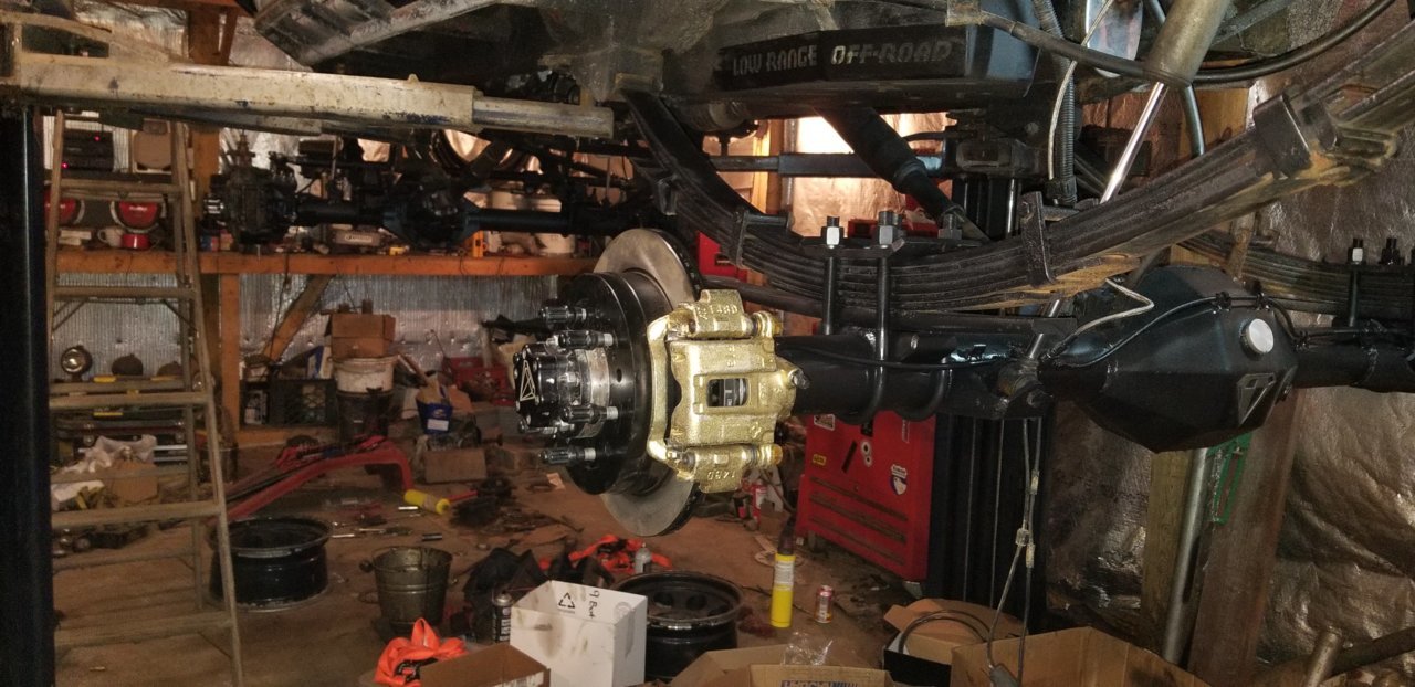

    I run a tilton clutch mater cylinder in place of the brake booster for shock clearance and then the booster and master is mounted under the seat. The clutch master is plumbed to a slave which drives the brake master. I use a 1” bore yota master

    2 degrees is nothing and will never be noticed. I just would never want the front shocks angled forward as it will look goofy, lay them back as far as you can

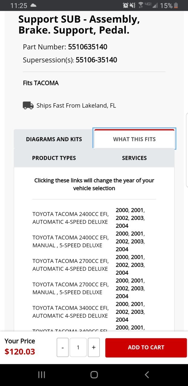

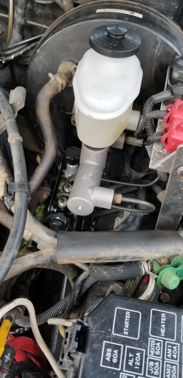

    When I ordered the parts online to upgrade to the T100 1" MC and dual diaphragm booster, I had no idea that my 98' reg cab 4cyl Tacoma came from factory with the T100 equivalent parts already :D.
    To be honest, I never even bothered looking at what I had before I ordered the parts. I just assumed it was the 13/16" MC and regular booster that most toyota trucks seemed to have.
    Out of curiosity I started looking online, even called a couple of parts stores to confirm. Sure enough....apparently some 4cyl Tacomas came from factory with the "upgraded" parts. Why not the just the V6s?. Dunno :confused: There's a lot of conflicting info online about what years/trucks came with what.

    Yeah all 95-04's w/o ABS had the 1" mc / dual booster. All 95-00 w/ or w/o ABS had the 1" mc / dual booster. Only 01-04 w/ ABS (which most were) had the single two bolt booster / 13/16 mc.
    So you have the 1" MC from a T100 and not the one ton T100 1 1/16" MC - beginning to think the stock setup should have worked on my new brakes...
