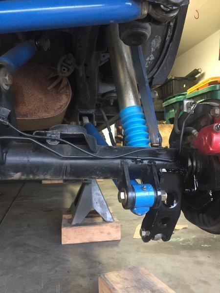

    Looking for some ideas: my rear lower link axle mounts are 5/8" hole/bolts on a 2" OD 1.5" ID tube bushing. The tabs are 3/8" thick. That results in a very thin bushing and bushing sleeve that get mashed pretty quick, it is also a "rare" part, the only place I have found them is Steinjager.
    https://steinjager.com/shop/5-8-Bore-2.50-Wide-Fits-1.510-ID-Tube-Black-Poly-Bushings-J0012859
    So, I am looking to reduce bolt size to 9/16" so standard RuffStuff and other manufacturer's bushing and sleeves will work. What is the best way to accomplish this? A weld nut will not reduce the hole size all the way through the tab (3/8") so the new sleeve would not sit flush and would likely get mashed. Sleeving the hole in the mount might work but would be tough as the sleeve would be pretty thin and short. Any other ideas besides cutting them off and starting fresh? They are offset bushings on the links so I can't go to a heim, I am also going to scrap it shortlyish and do a 4 link so dont want to put too much effort and $$$ into it.
    Like so:

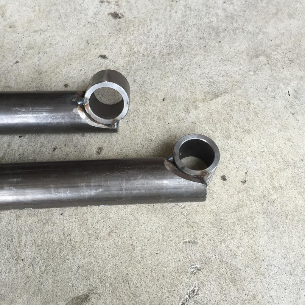

    Drill the hole out and sleeve with a piece of tubing/sleev. Can make it stick out a 1/4-3/8 in to have surface to weld and just use a longer belt. if you cut it straight shouldn’t be an issues

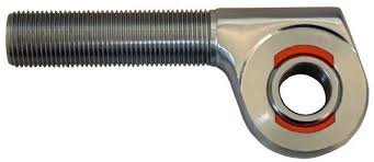

    I am considering throwing in an offset heim instead of the bushing, does anyone have experience with these? Would that become wobbly?
    The frame side is a 1.25" so the axle side would be weaker as they only come in a 7/8" shank that I have found. I could also just go back to a straight heim and deal with the bind.

    I’ve run them on a tie rod.
    Your bushing keeps the link from rolling. It will want to roll more being offset like that.
    Nothing wrong with a 7/8 heim.
    My buddy has them on his lowers on his buggy on 43’s.
