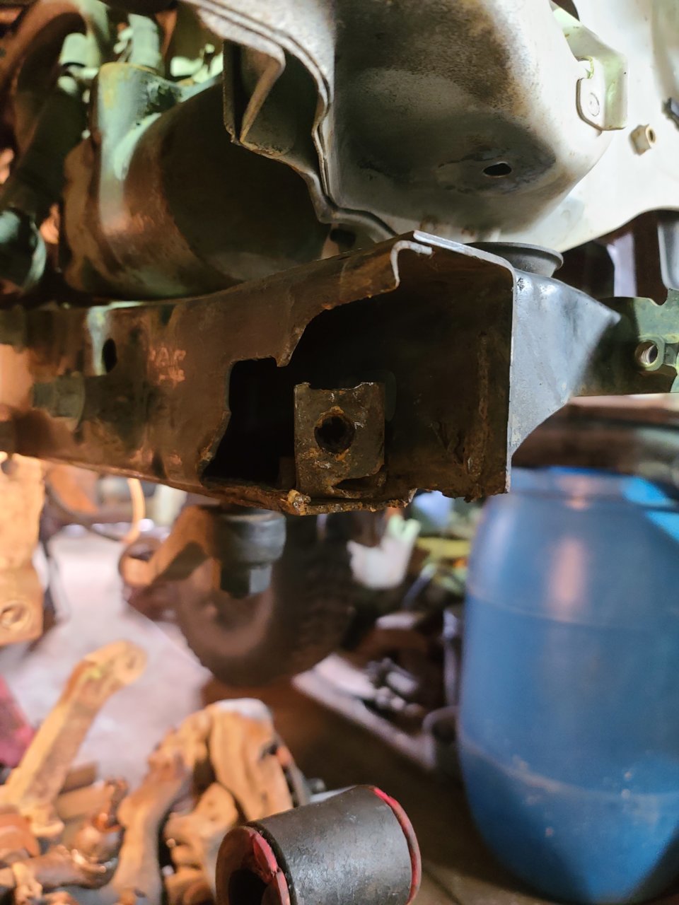

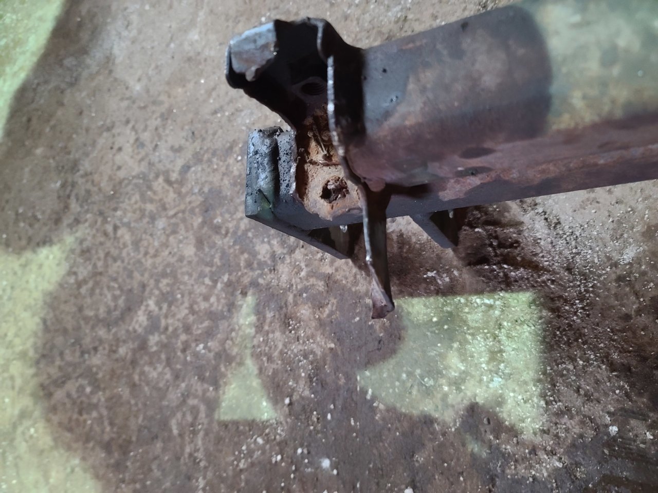

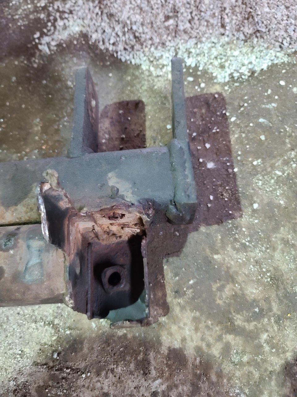

    I just wanted to give a heads up on anyone doing a SAS...if you have someone else do the work for ya you better make sure they know what they are doing!! I bought my truck already built but whoever did the welding should have reinforced the frame where they welded the front tube on. Ripped the frame not the weld.20210606_153517.jpg 20210606_153456.jpg 20210606_153517.jpg 20210606_153456.jpg 20210606_153446.jpg 20210605_164301.jpg 20210604_135902.jpg

    That’s a very common issue

    I wondered. There isn't much of a frame there anyway. What is the solution to the weak frame? Reinforcing? I am using C channel on both sides of the frame and running it back about 6"-8". Then welding it back in place. Should do the trick. Thoughts?

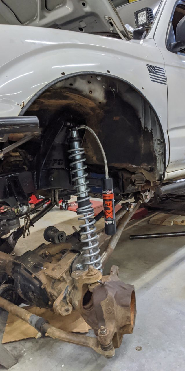

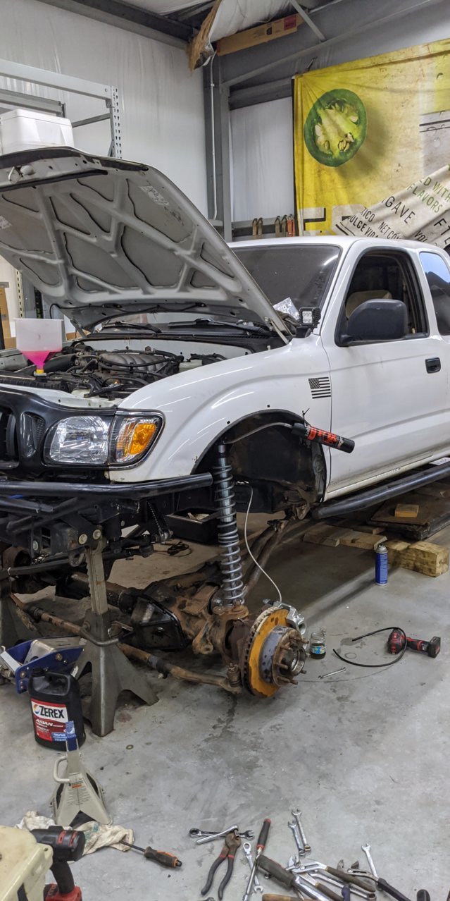

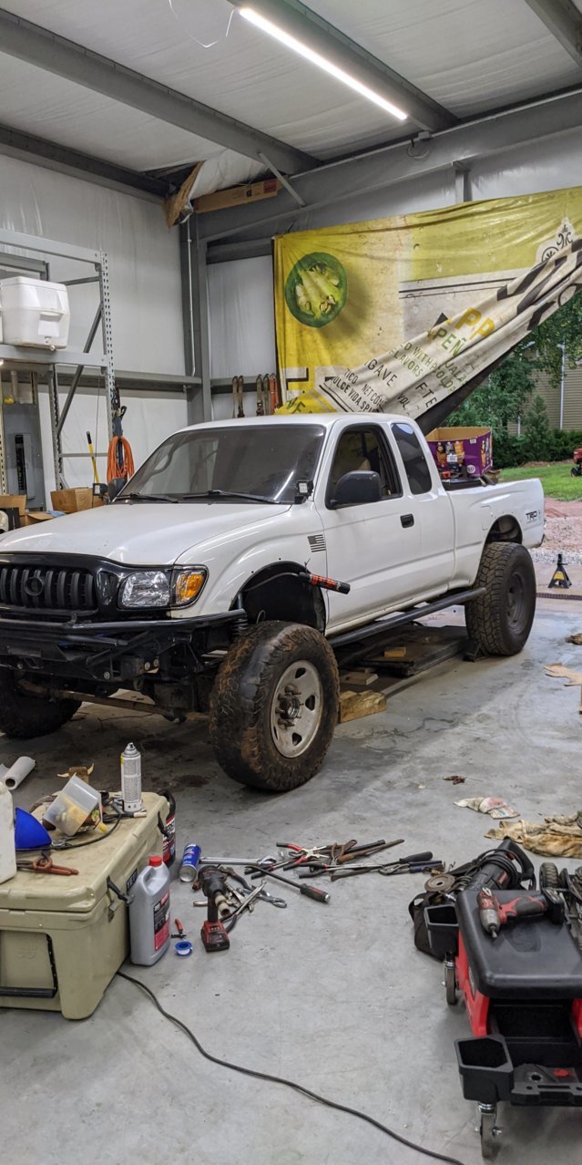

    7 days of work later, we have a roller.

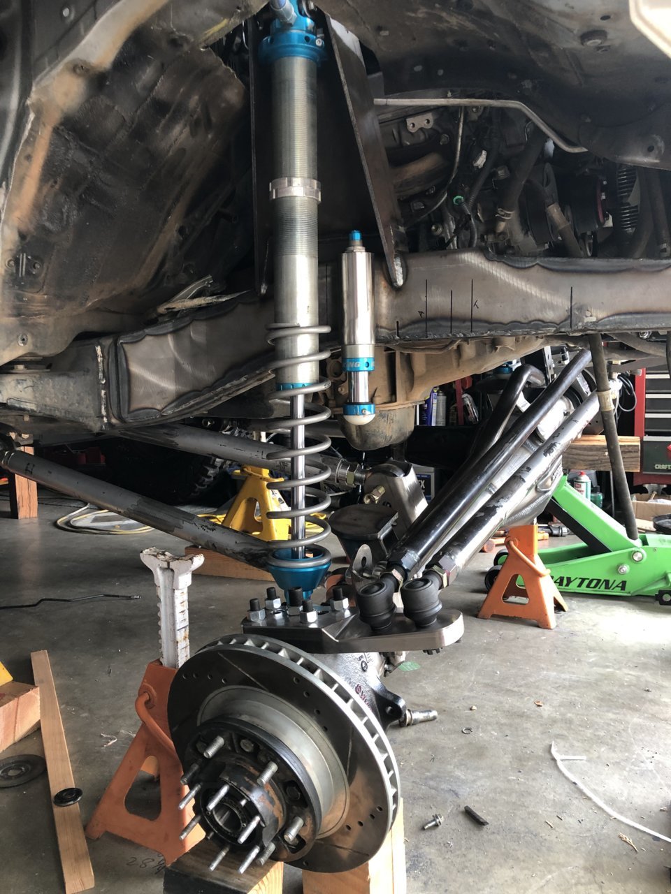

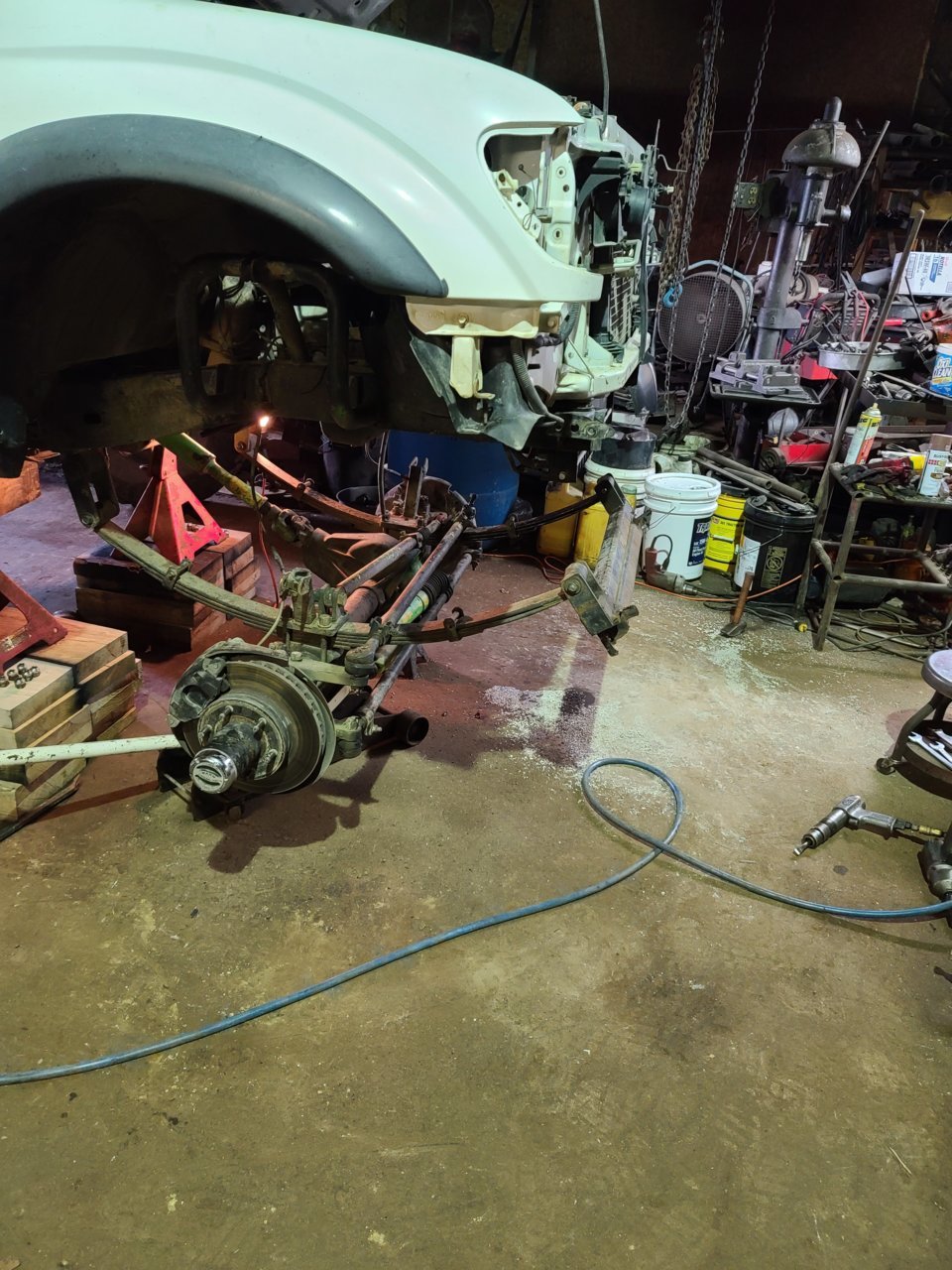

    I’m reaching the finish line. Still a bunch of stuff to do but I’ve cycled the suspension and just pulled the housing out and welded everything. 4ACF23FF-AD42-4841-94BF-CF60D2F705A2.jpg 3C793BD2-997C-42A8-BC26-9FC99CF81613.jpg

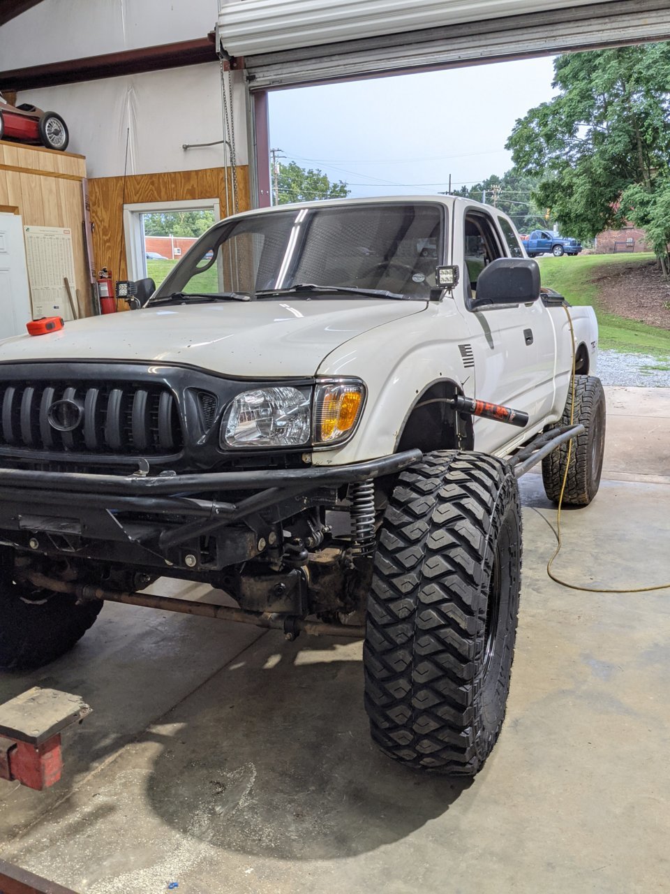

    Put the tires on, charged the shocks, set the preload.

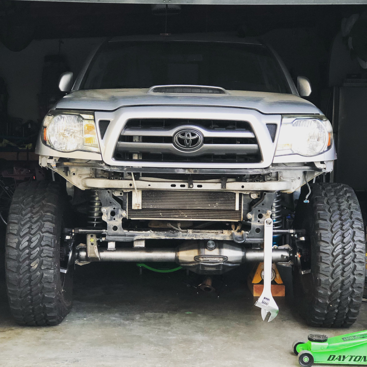

    Sunnyvale California
    3 link solid axle 2011 Tacoma 4x4
