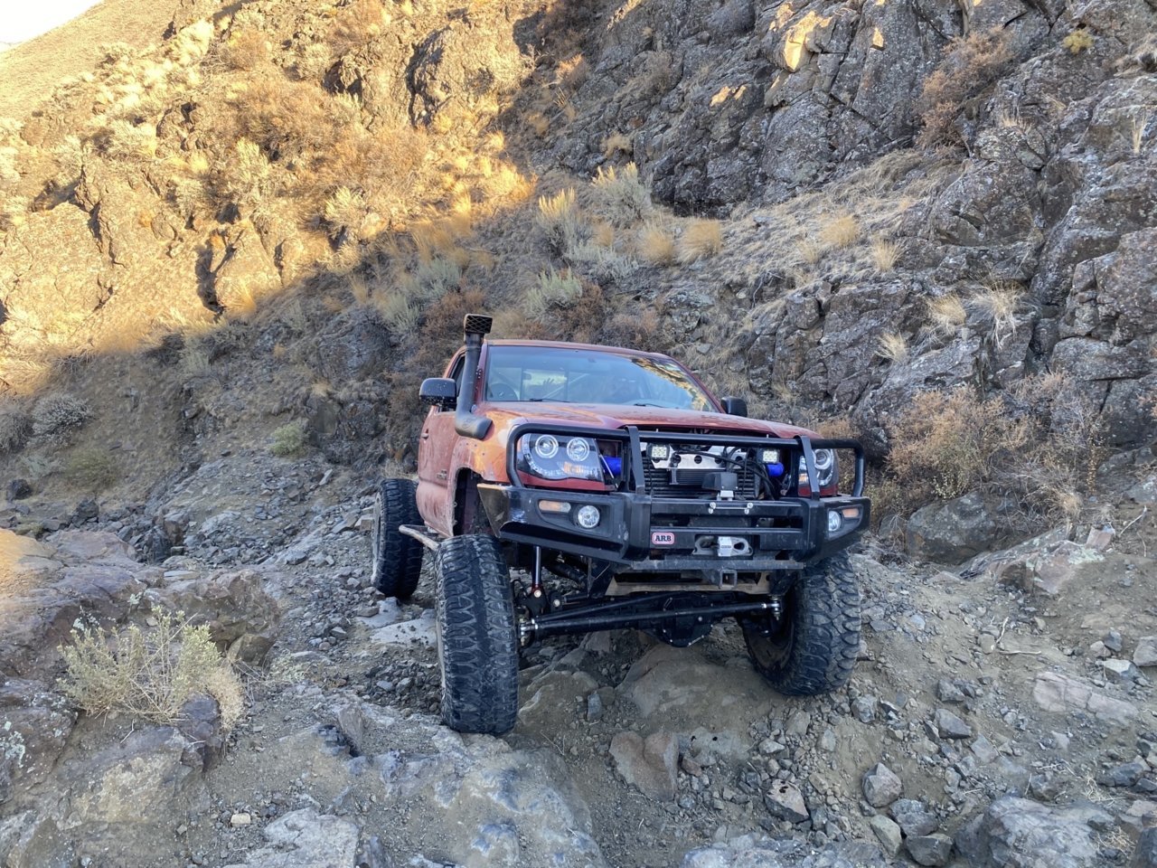

  18. Sep 25, 2021 at 9:50 AM
    Bloodytaco208
    Bloodytaco208 Well-Known Member
    Apr 6, 2019
    #289329
    439
    208
    Twisted steel sex appeal reg cab tacoma
    Bunch of built and bought mods
    Had the first shake down run. Things need fixed lol
    Airmain, Pdugan6, CedarPark and 5 others like this.
