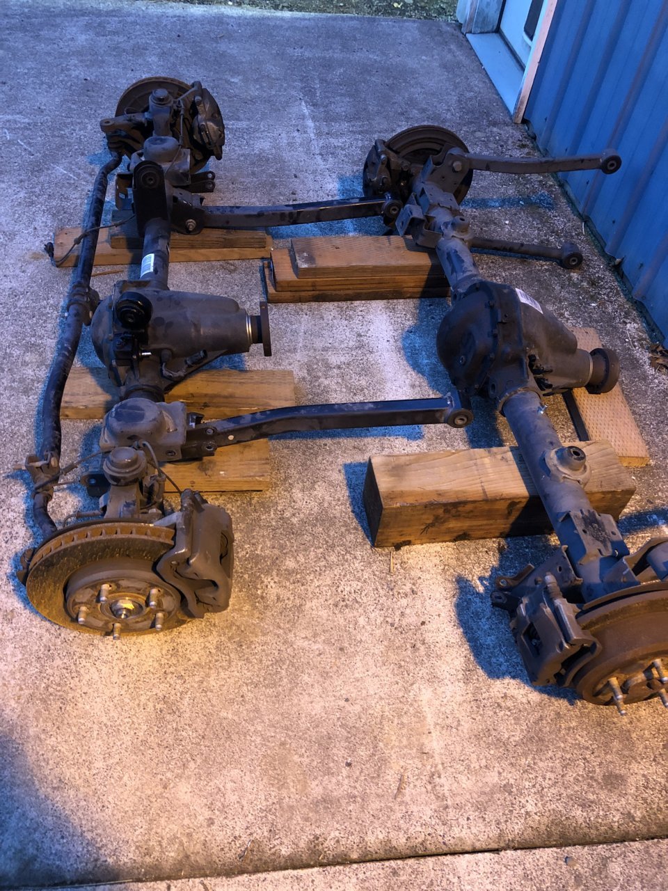

    So apparently the price was incorrect... i figured it was too good to be true given i've seen front rubicons being listed for $4,000 +. I ended up getting both for $3,900, not 3,000. I was prepared to spend $2,000 on a waggy 44 fully setup (low pinion, Probably needed some work). Even though it's a large chunk, overall i think it's one of the best routes to go without going tons or custom housings. The axles are complete hub to hub, had 50,000 miles on them, never used off road. They come with all the factory steering arms and control arms which i will sell. Obviously i'll sell my factory taco e locker axle to help offset costs. Goal is to wire the rear e locker to work with the tacoma switch/indicator. Front locker will be on a switch next to it and just control on/off without the indicator. ABS will be made to work, which is great considering the waggy 44 would be without. I'll of course need to re-gear front/rear. I get wholesale pricing from 4wheel parts and ive got a shop that will do both gear installs for $750 plus parts. I also ordered my tires yesterday, 37/12.5r17 MTZs :D

    Doing some more research on the axles, I'm very happy. The front is 8.5" ring gear with 32 spline outers. The rear is the super 44 with 8.9" ring gear and 32 spline inner/outer shafts.

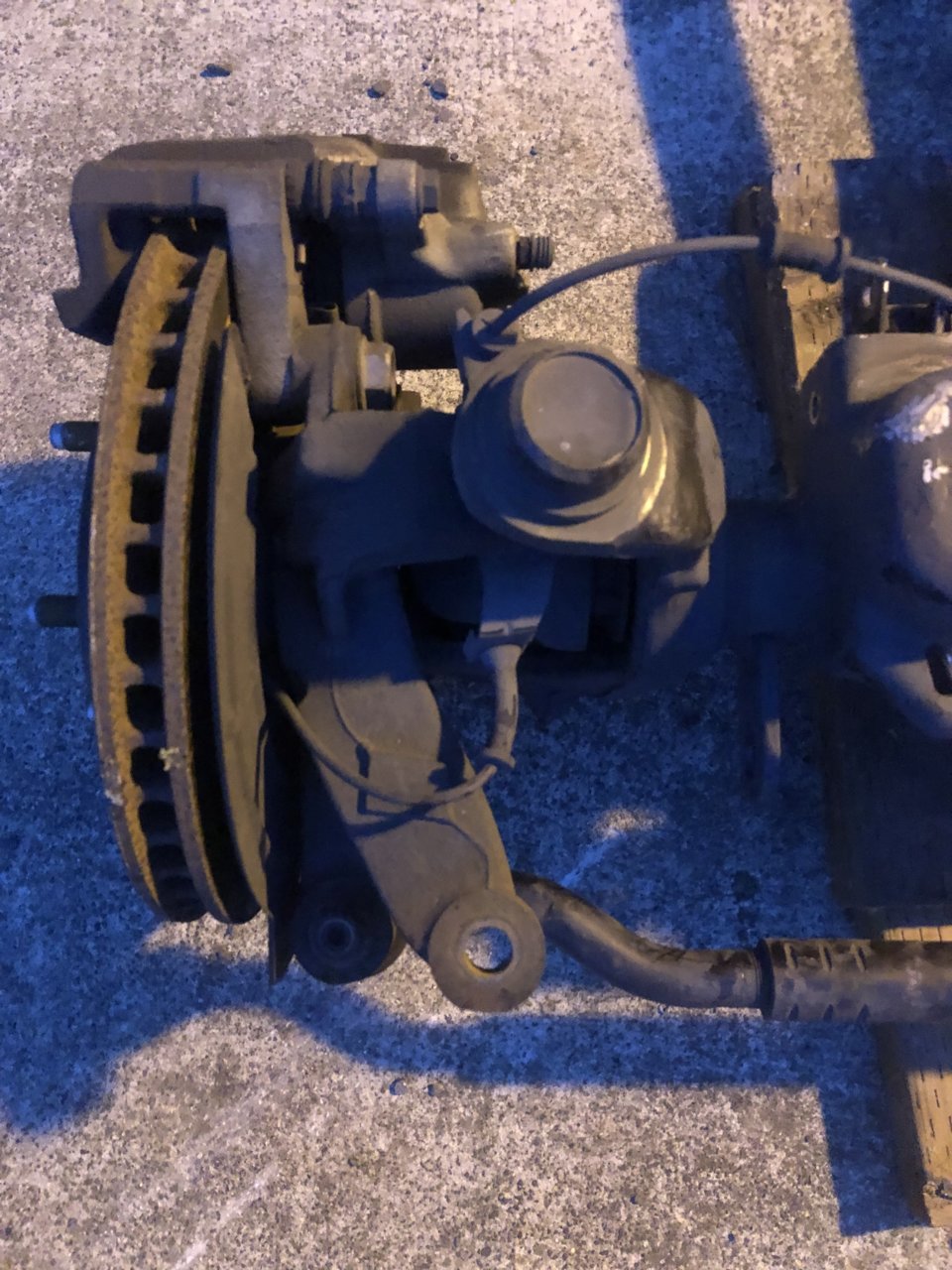

    It’s an interesting knuckle/steering setup. Factory they come with the drag link mounted beneath the arm similar to the tie rod. But it’s an easy flip to do a top mount. As you can see, lots of cutting/cleaning the axle to do. All that shit has to come off. Btw, another pair just sold yesterday for $1,600 more than what I paid for these. Makes me feel better.
