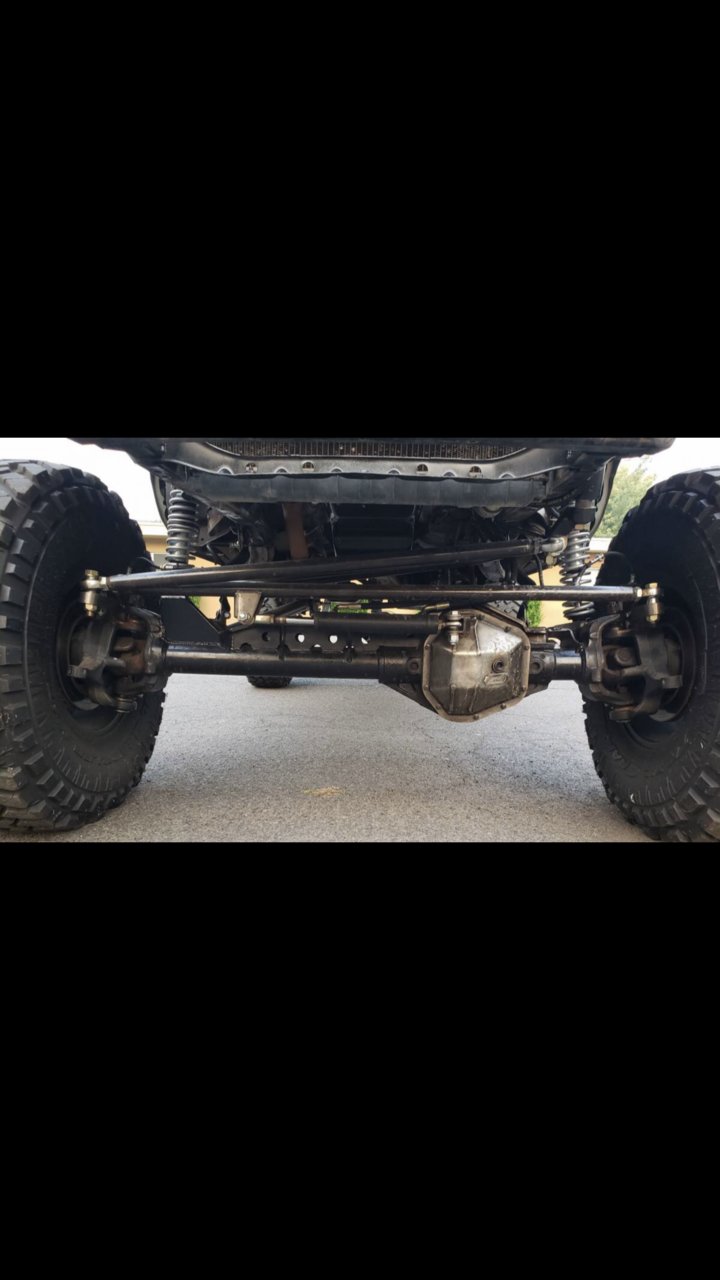

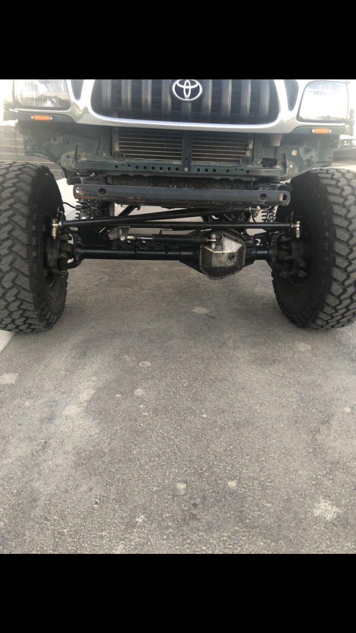

    Like this one on my truck

    idk why but i can only see the middle pic. Is that a pass upper link?

    Jason
    1 ton double cab
    When you do 1 tons obviously not worried about weight and this was tig welded on just saying

    No it triangles up by the upper link is what your seeing

    That’s a better picture

    looks nice. what is the width on that axle?

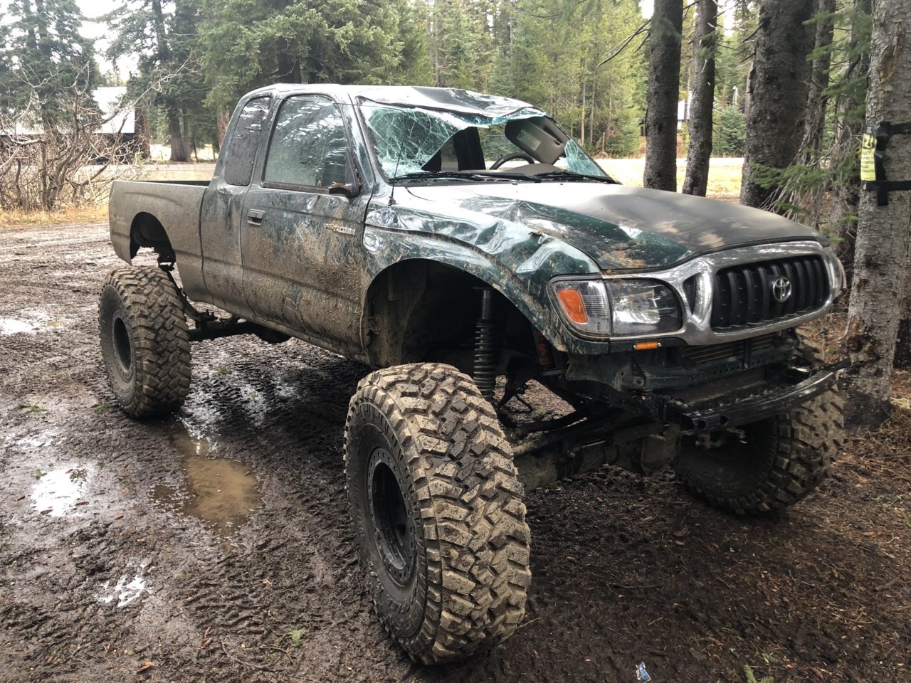

    Hopefully the last picture helps you I rolled my truck twice last week and axle isn’t bent truss is way to go

    It’s 72 inches from hub to hub it’s the super 60 05 and up is same

    That’s the damage all body super 60 front and 14 bolt full floater is good as new drives same as before I rolled it
