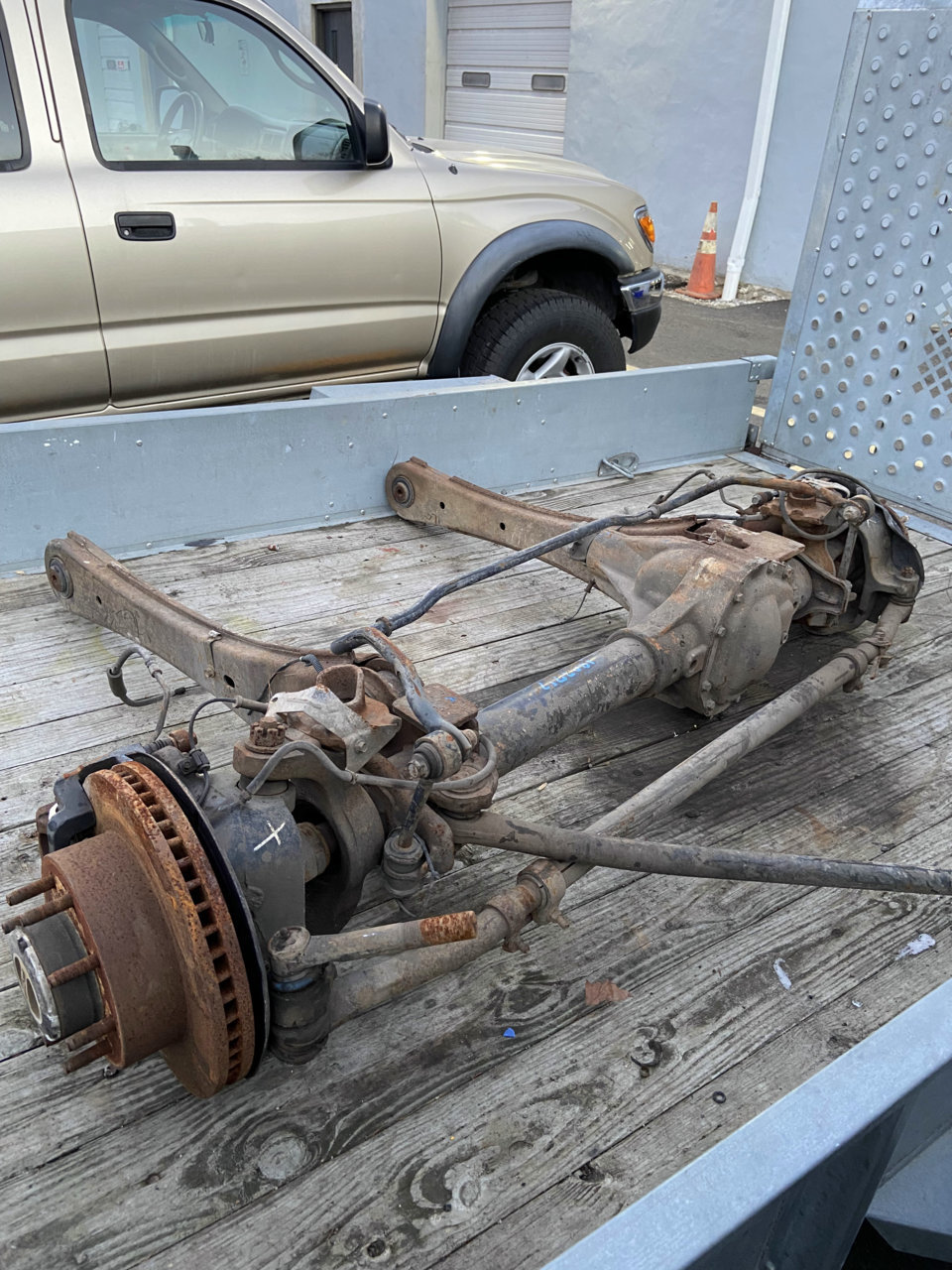

    Got my front axle assembly today.. 06 ford... Took a while to find a clean one... These things weigh more than I expected... You can't even move it on the ground... Gonna be hard to deal with..

    yeah, they are heavy SOBs
    Yota X[QUOTED] likes this.

    Yeah, for sure. I think im gonna build a little roll around stand for it or something. Its looking like 2 people, 2 jacks and lots of precaution to even get one of these things setup on stands under truck.

    Those things are monstrous. Everything in them is significantly larger than previous D60s. When I bought my kingpin D60, it was on the ground next to one of those like yours. It made the kingpin look like a D30 by comparisson LOL!
    When I got home I had to manuever the kingpin around the garage with an engine hoist.Your axle being significantly bigger will be a pain…especially while it has factory radius arms and brackets

    With an engine hoist it still took 3 of us to unload/load one in my garage

    I haven't come up with a plan to get it in the shop yet. Might just put some small as I can find 8 lug wheels to roll it and cut off the radius arms. I almost started cutting off all the brackets today but made a quick courtesy call to 4WU and thank god I didn't cause I need half of the radius arm mount for the lower links.

    are they too rusted to un bolt? lol

    I think I might need them as handles initially so was gonna keep like a foot on them to steer.. lol
