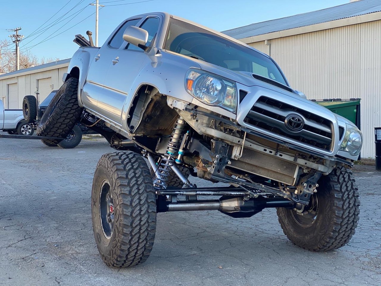

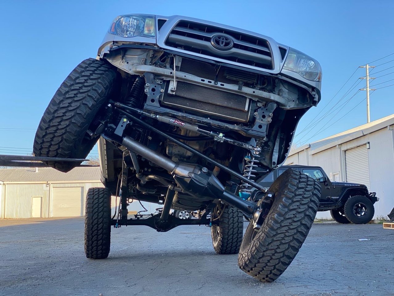

    Picking up my truck tomorrow from the shop. Had them do my hydro lines and brake lines modified the crossmember to clear front driveshaft and new leaf pack in rear. Pumped.

    Now that everything is running I have found out that my 4wd will not engage cause the sensors from the front diff aren’t hooked up anymore. Does anyone know the fix for this?

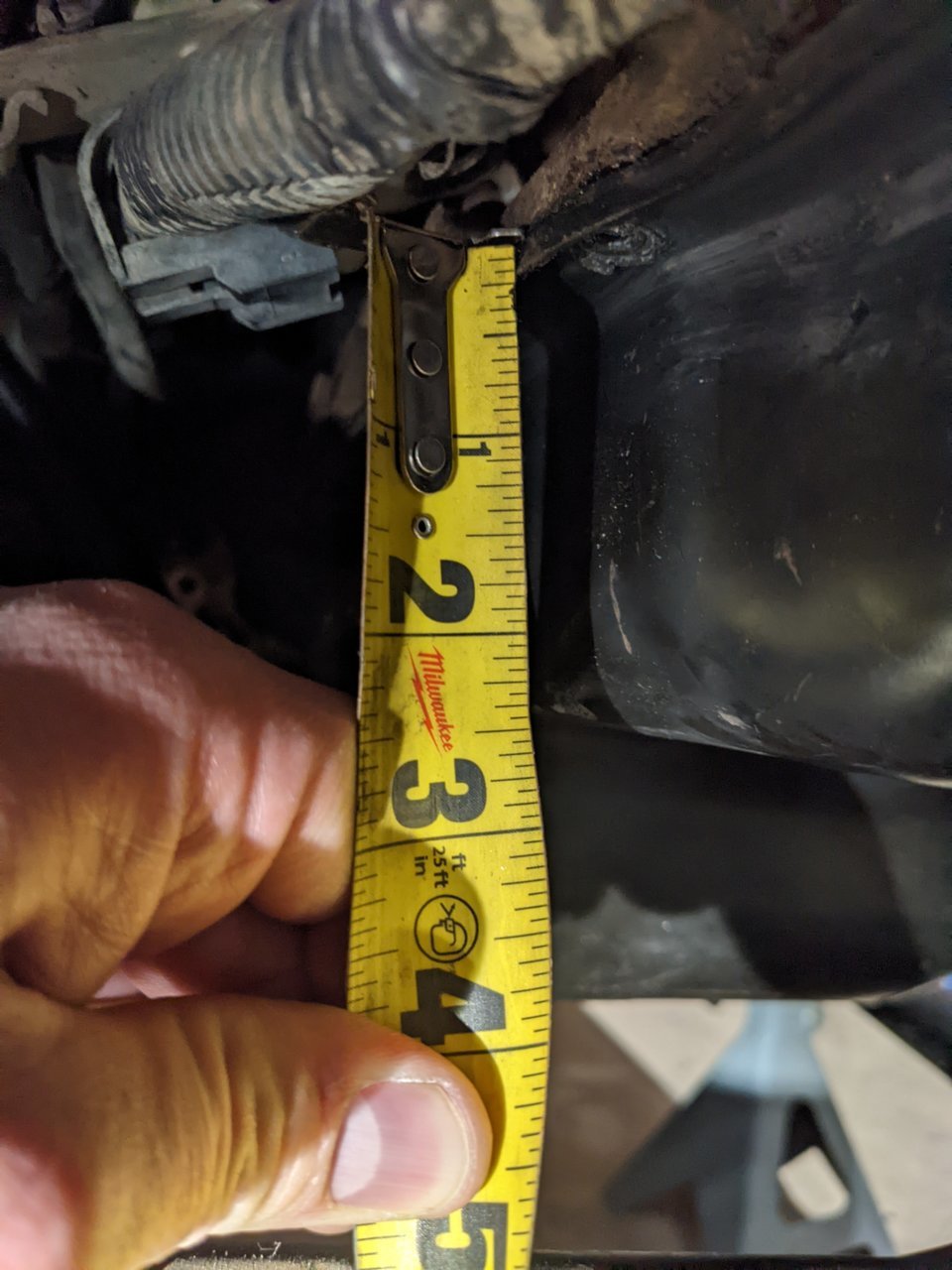

    Could someone with a 2WD V6 T100 oil pan get a measurement for me? I'm looking for the distance between the mounting flange surface and the large flat surface directly above a solid axle. Thank you![​IMG]

    Maybe a little hard to tell here, but it's about 2.75" -ish

    Awesome, thank you so much!!

    Check out the wiring for the add delete. You can delete the 4wd ecu with that mod but I think you may need to bypass the wires for the add in the front diff. Not sure how that will play with the stock 4wd switch though. So you may need to also do the fj case swap.

    I got my 4wd working by grounding out the 4wd ECU to the frame. Can’t get lo. I have duals so I still have a lo but not double now. Prob do a atlas down the line.

    Atlas would be the best. Would be curious how much of the floor would need to be massaged to fit it.

    Why not do the fj swap? So much easier and cheaper then changing the setup that you already have...

    Fj case and Northwest Fabworks Ecocrawler. Way cheaper than an Atlas setup. IMO
