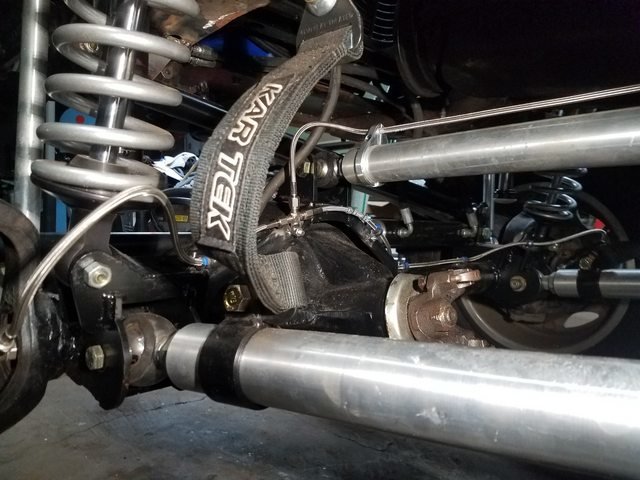

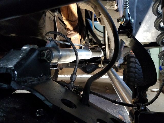

    Don't drop your air line down from your engine bay for the front axle. Run your axle breather line, air line, and brake line with your upper link.

    what do you mean? Like zip tied to it? Have a pic of yours?

    Not home to snap some pictures but this is the concept.
    Weld the tabs on the upper link and run the all the lines (brake, breather, air) and zip tied them to the tab. This gives a much cleaner look vs having them all run up towards the engine like those on leaf spring.

    Ooh. That is nice! You got all the fancy shit! Those sleeves are sweet! Yeah that is smart. No stretch at all! I have been worried about that in the rear. Wonder if they have dual tabs. Run the air line w braided.
