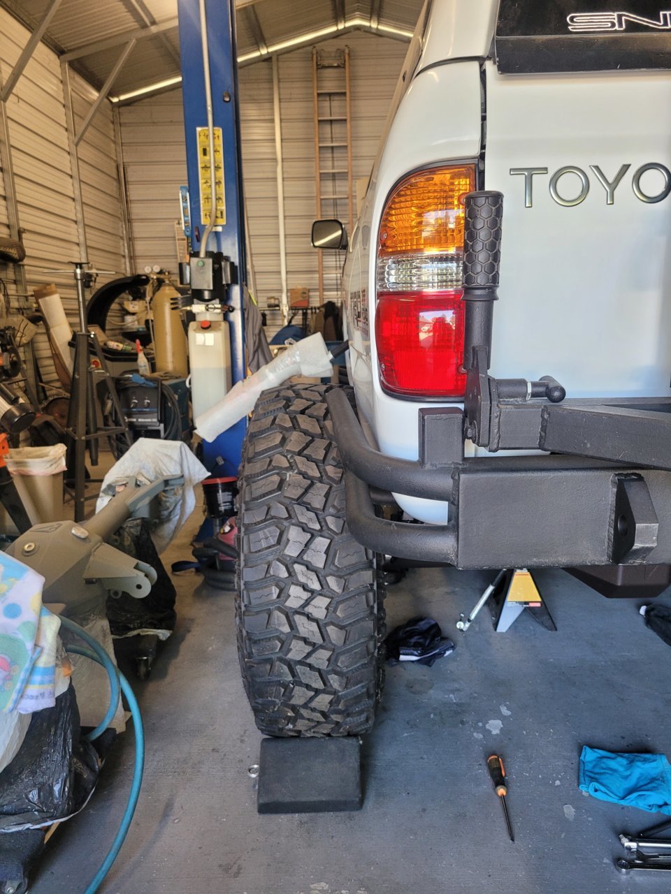

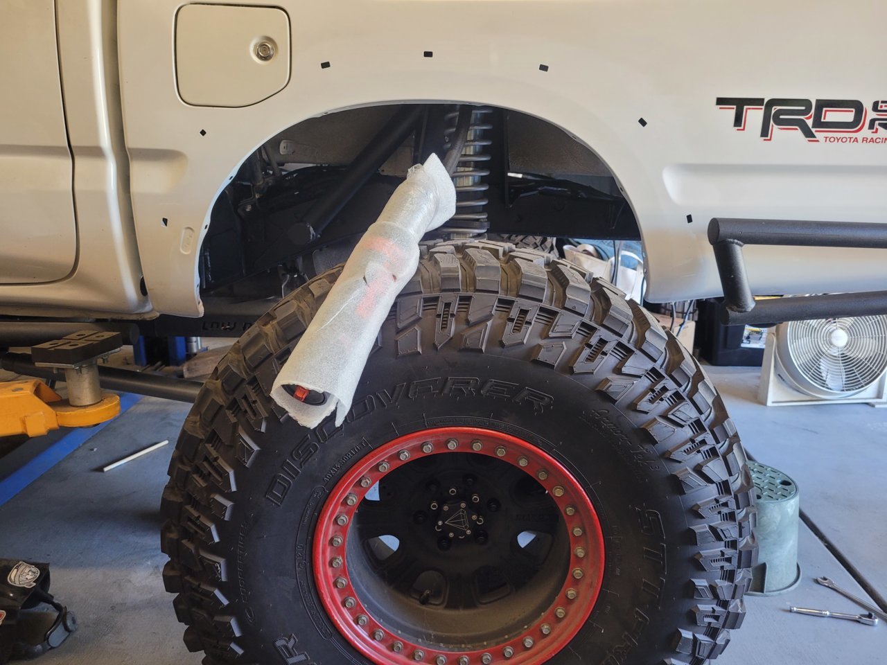

    At first, it took me a while to get used to the rear stretched (though mine was a relatively small stretch). I trimmed the rear end of the wheel well a bit and it balanced things nicely visually (to me). A little bit goes long ways, but you might be pickier than I am with these things lol

    Might move it forward an inch but will see. In the meantime, I tac on a brace for the front tower. The brace will serve two purpose: a support for the tower and a tube to clamp the CO reservoir. Need to check for clearance before doing a full weld but I think the tire will clear lock to lock.

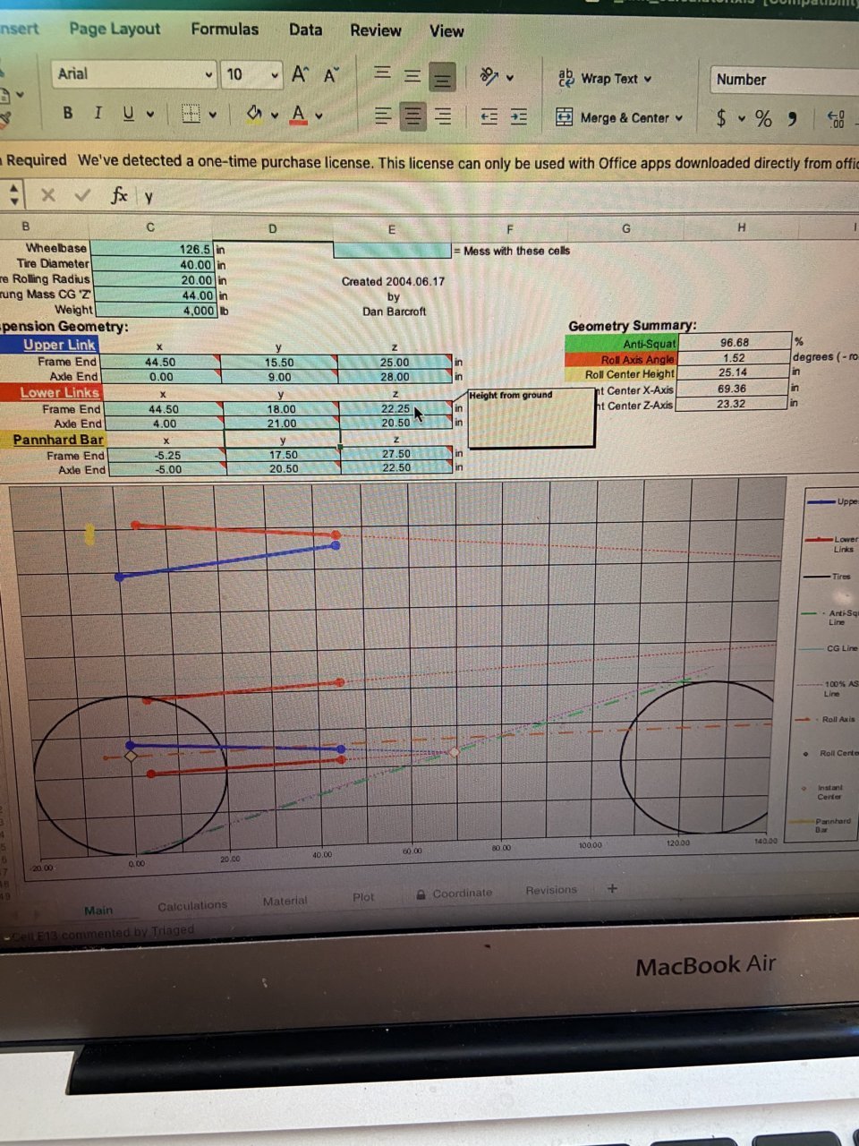

    Those numbers are decent. I would shorten that upper link to keep your caster more consistent throughout the range of travel though. A longer upper link has a tendency to roll the pinion up as the suspension drops out, this good for pinion angle but bad for steering geometry.

    Ok. Cool. The atlas is gonna force it up anyway to clear so I’m gonna have to redo it a little. Thanks for the advice.
