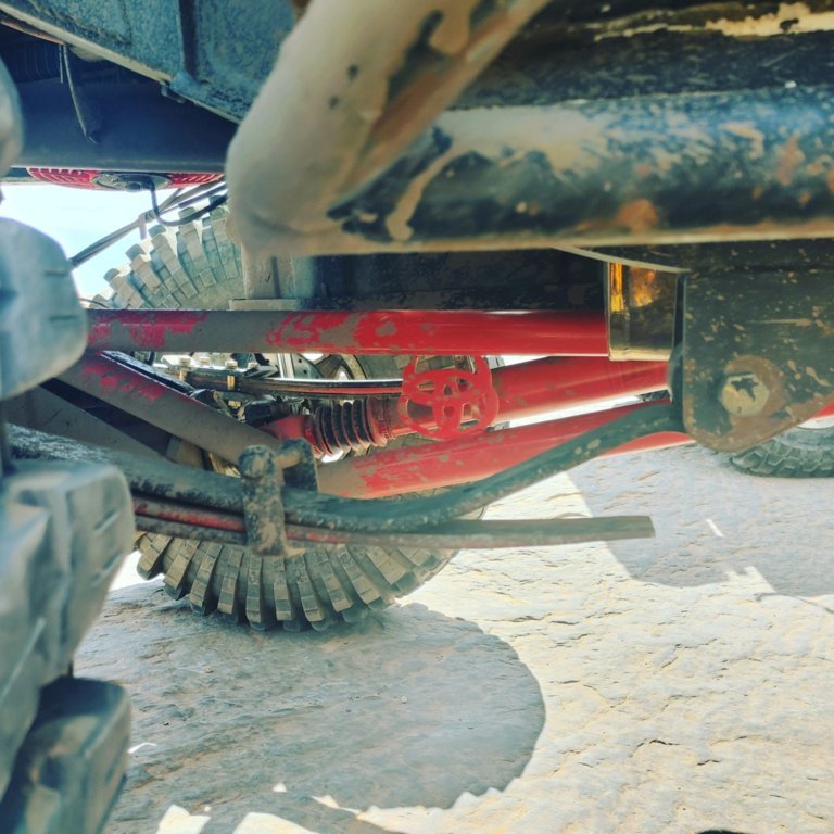

    This fucking LS2 wads up one more set of leaf springs and im linking the back
    sparkystaco, jubei, Wulf and 2 others like this.

    rock raisin
    damn, even with the traction bar?

    We in the Toyota world are so used to underpowered engines with low torque :D.
    Buddy of mine had to the link the rear as well after doing an LS swap. The torque was just destroying his leaf springs like in your case.
