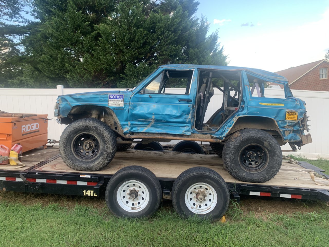

Solid Axle Swap BS Thread
Discussion in 'Solid Axle Suspension' started by Supra TT, Feb 20, 2012.
  1. Sep 9, 2022 at 8:12 AM
    Van-go
    Van-go Well-Known Member
    Dec 25, 2019
    #314162
    186
    David
    Greensboro NC
    2009 Tacoma
    Dana 60 F&R
    It’s for sale. Without stickies for $1800

  3. Sep 9, 2022 at 10:02 AM
    Dayman Karate
    Dayman Karate Well-Known Member
    Dec 18, 2017
    #238838
    4,722
    Clay
    Central Alabama
    JKU Rubicon
    https://www.tacomaworld.com/threads/daymans-karate-class-but-you-wont-learn-nothin-4-link-lt-and-previous-iterations.755134/
    I’d ask how well the cage was built but judging from the body it seems to be working fine haha
  4. Sep 9, 2022 at 10:35 AM
    Van-go
    Dec 25, 2019
    #314162
    186
    David
    Greensboro NC
    2009 Tacoma
    Dana 60 F&R
    We bent that thing up in a weekend and it’s been holding up great. Welded to the sliders which are welded to the uniframe.

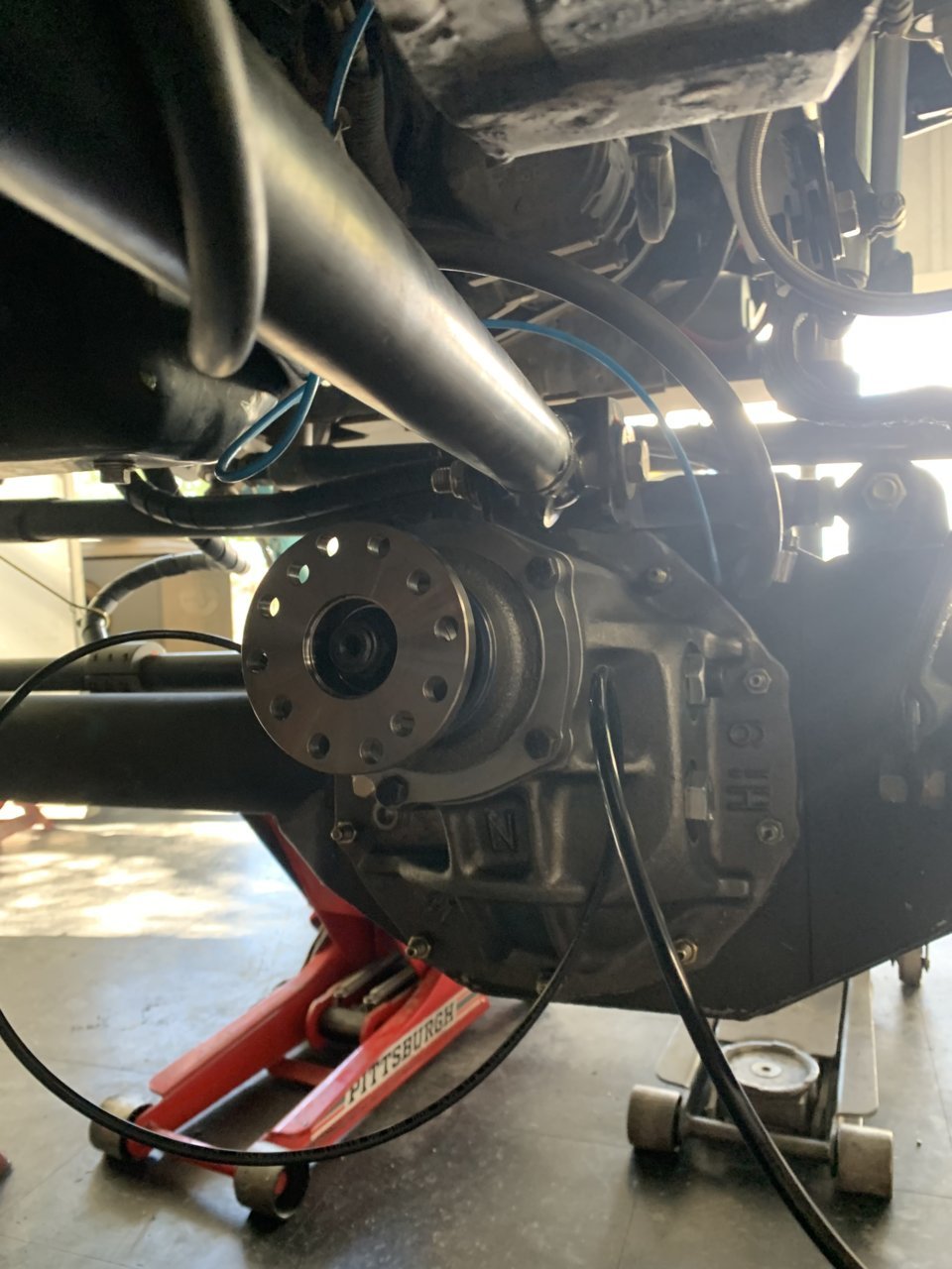

  19. Sep 15, 2022 at 4:38 PM
    malburg114
    malburg114 Well-Known Member
    Dec 26, 2012
    #93766
    3,819
    Las Vegas, NV
    2001 Toyota Tacoma TRD

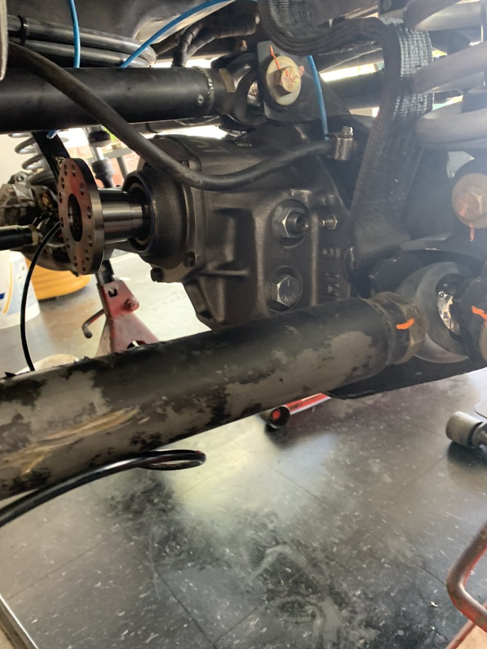

    High pinion eye candy B1A84123-62EB-43A3-9E94-28FA65857A77.jpg49B4267D-D9E5-4F10-B347-0AFB2E354FC3.jpg1F3CF0D8-D795-47A2-A8CC-B4BB5259AF49.jpg
    Buttskevin21, jubei, la0d0g and 9 others like this.

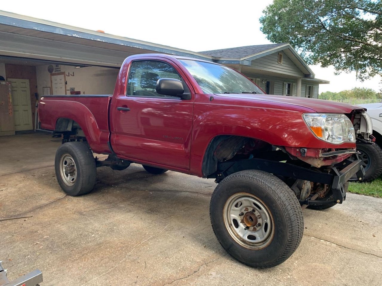

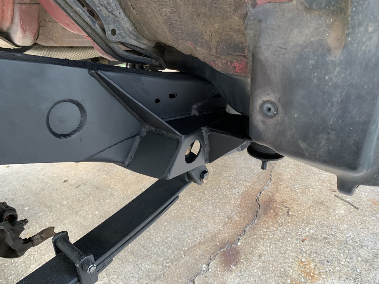

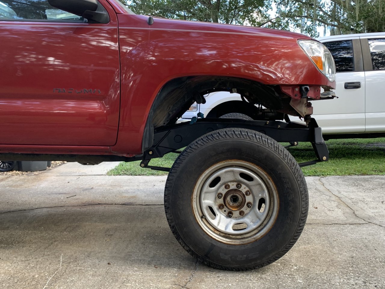

  20. Sep 19, 2022 at 3:23 PM
    allenfab
    allenfab I hate everything
    Oct 23, 2014
    #140913
    2,657
    Todd
    Lakeland, FL
    08 5-lug on one tons
    got my poor people leafs under the truck. 21" frame height as of now on 31s. Will be a little lower once the engine/trans/tank/everything else are put in
