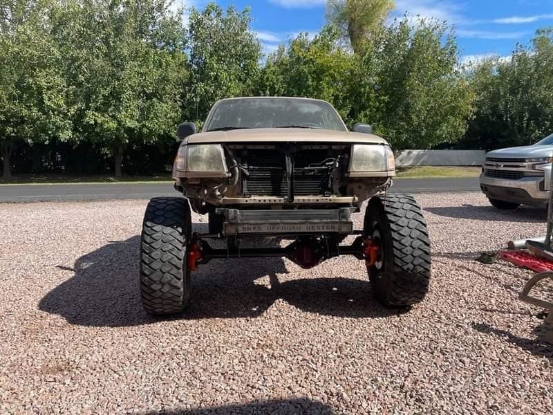

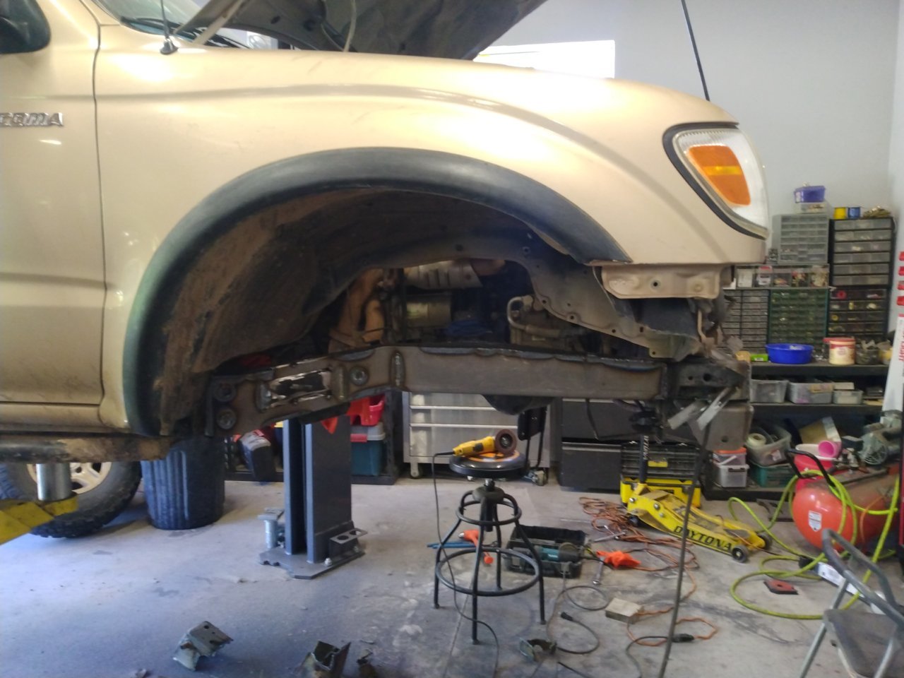

    2000 Tacoma 4x4 Prerunner TRD
    Gettin started on my first gen
    Fernando, suttonkb, ToyRyd04 and 8 others like this.

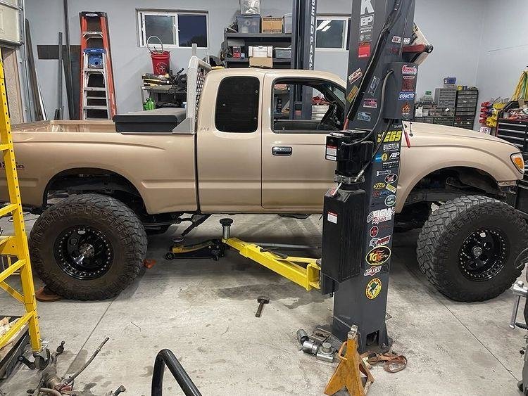

    Progress!
    one more pic

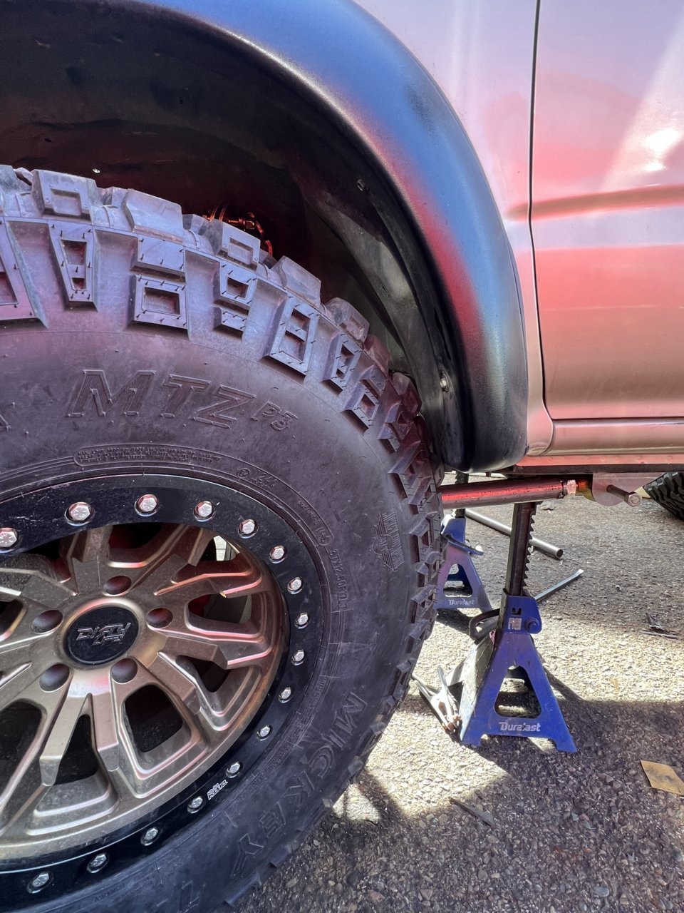

    02 D.C. TRD
    Clicko BUILDo
    Full bump and turned with no rub

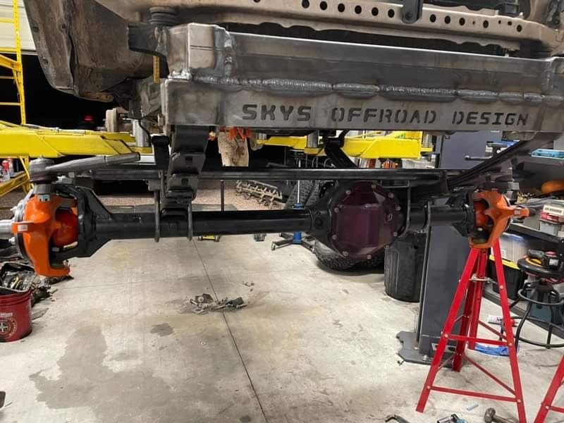

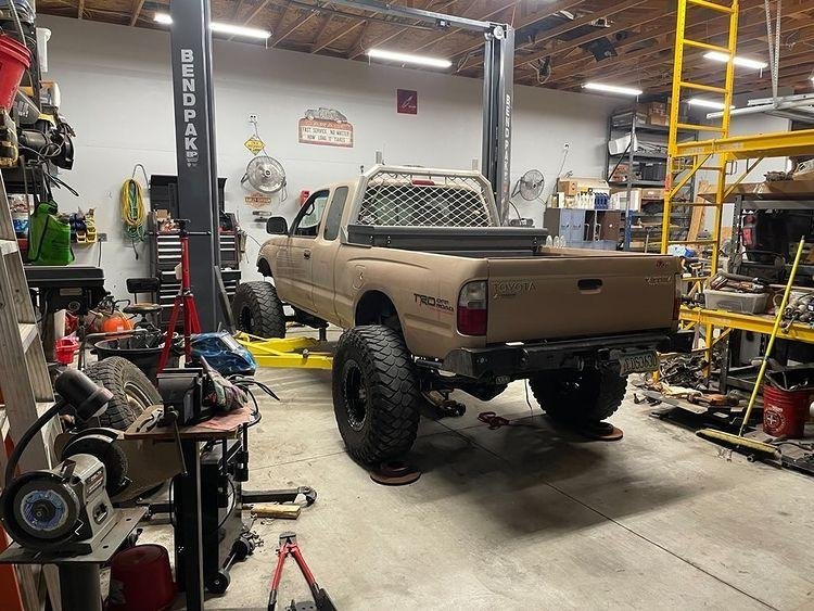

    slowly but surely :sawzall:

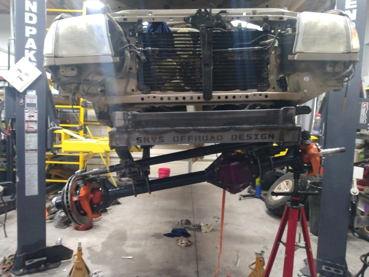

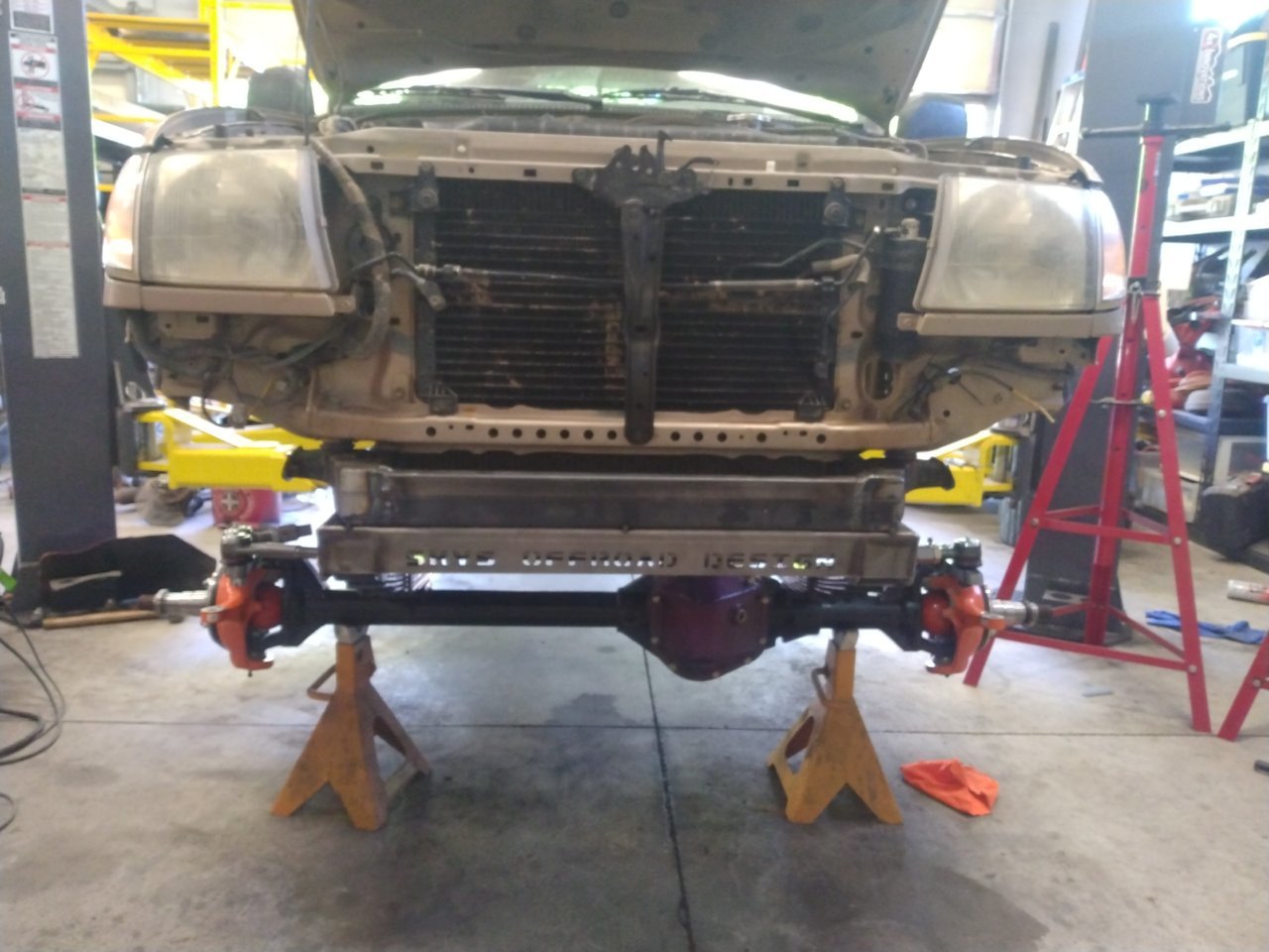

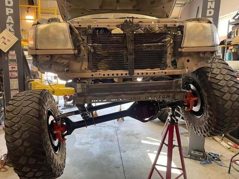

    139
    Gilbert, Arizona

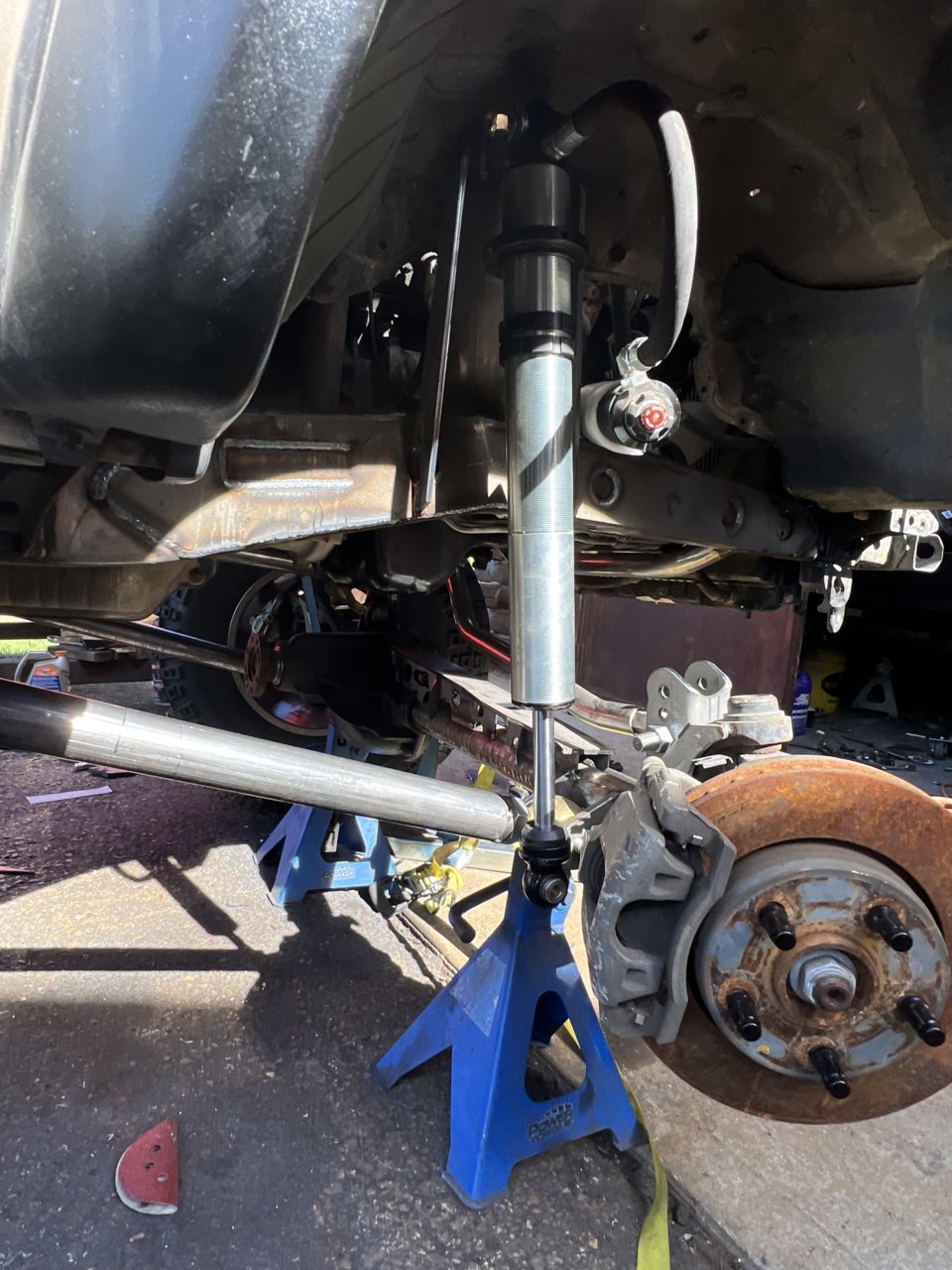

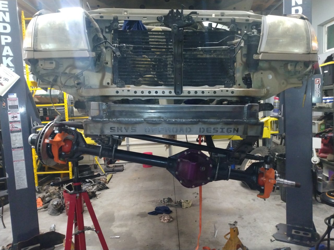

    Definitely a lot taller than ifs, but not super tall, about 25 inch frame height. good progress today.
    IMG_20221008_185425_570.jpg IMG_20221008_185448_131.jpg IMG_20221008_185441_934.jpg IMG_20221008_185429_266.jpg
    jubei, Wulf, allenfab and 6 others like this.
  12. Oct 9, 2022 at 8:17 AM
    slander
    slander Honorary Crawl Boi
    May 10, 2013
    #103909
    8,964
    Hickory, NC
    02 Tacoma, fixed with curse words.
    Nice!! After building a low rider SAS I wish I went a bit taller. With how long these trucks are that extra height would come in handy and wouldn't be any less stable IMO. I was at 23.5 right after the swap so it's probably a bit lower now. 25 will be nice!
