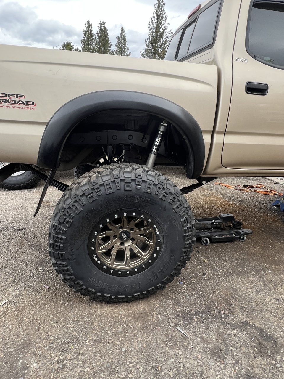

    I had the rear axle centered. Just a tall SOB with TG 5" springs...

    Cutting the perches and setting the pinion angle is the best way to avoid vibes, has nothing really to do with 2 piece vs 1 piece.

    The perches are new so i'm sure they're being set to optimal angle.

    And then pointing the pinion at the t-case output, yea?

    I go a couple degrees lower to account for axle wrap but yeah, if you have a 1 piece CV driveshaft you want to point it at the tcase (or carrier bearing for 2 PC)
