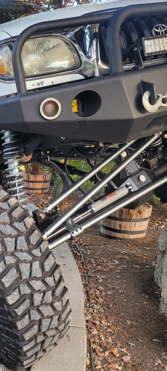

    This had me puzzled as well, given every full hydro rig i know has the ram mounted to the front of the axle with tie rods connecting to the knuckles. What other options are there.

    Maybe I was thinking of hydro assist. Don’t know. I’ve only seen full hydro on buggies and bouncers aside from a couple IFS Tacomas.

    Hydro assist still has a front ram (takes place of the steering stabilizer). One side is mounted to the axle and the other to the tie rod. Maintains factory mechanical steering. Just makes it easier to turn.

    I've seen redneck full hydro with a single 8" ram and a regular tie rod setup. Definitely not as strong or reliable as a double ended ram setup

    What he said. I haven't seen anything different. @Dayman Karate you have any pictures?
    This is a ram assist setup

    That’s what I’m seeing a lot of with or without the ram I suppose. I just want a ram mounted to the axle like I see on all the buggies. Fewer points of binding and more clearance for uptravel from the little bit of digging I’ve done.

    95% of average joe rock crawler builds are with ram assist, it's street friendly. If you plan on driving your solid axle truck on the road, I DON'T recommend full hydro. Full hydro eliminate drag link etc and will provide better travel, but not worth it if you drive your truck.
