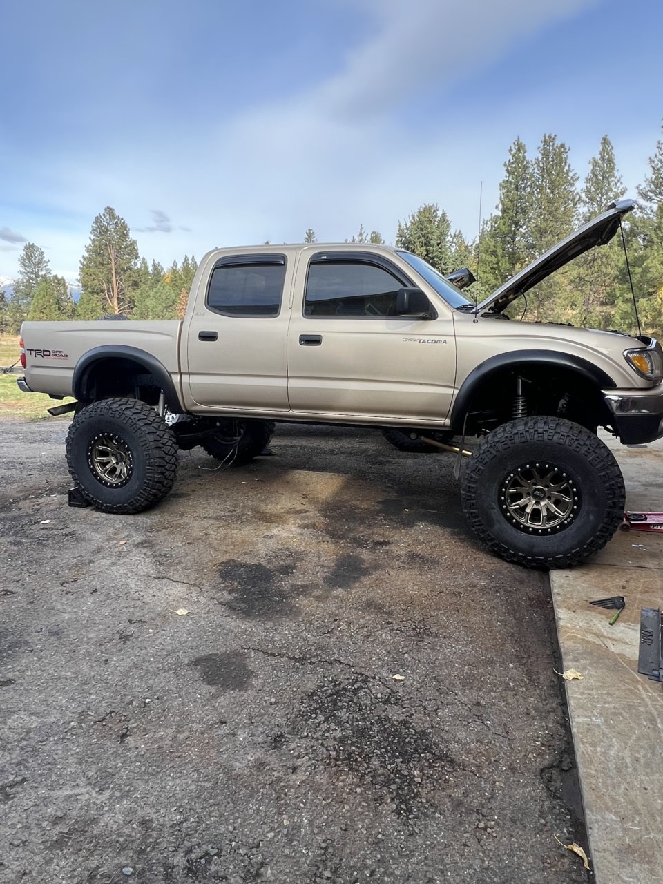

    Flipping the ram 180°? Or....
  11. Oct 24, 2022 at 11:04 AM
    02hilux
    02hilux What do you mean there’s no road, I’m here
    Sep 14, 2016
    #197244
    6,368
    Planet: EARTH
    Getting there.....

    Just having the ram push towards driver, vs the picture you posted having the ram push towards passenger.
    Calling Tom Woods drivelines today to see what they recommend for the rear. Hydro assist is on :yay:

    Makes no difference on placement. I preferred the cylinder end on the axle side, look nice that way imo. More flush, flat and inline
