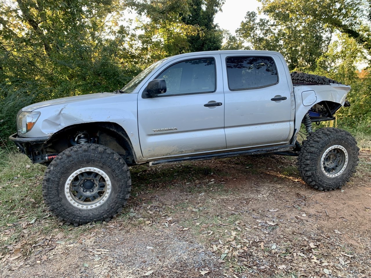

    Various shops told me that single joints allow for the steepest possible angles and explained that double joints, on the other hand, allow for smoother operation with steep angles but not as steep as single joints. Dunno...just saying what I was told.
    For my application, I opted for single joints for the front shaft. Going with a double joint would have required me to tilt the pinion of the D60 up quite a bit, which would have caused the caster angle to go into negative, which would have required the inner C's to be cut and rotated to bring the caster back into positive, etc. Way too much work just to accommodate a double joint.
    I have a double joint in the rear shaft though.
    This is from Tom Wood's website:
    "Many people mistakenly believe that a double cardan or C.V. type drive shaft will allow for greater operating angles than a conventional 2 joint or single cardan drive shaft. This is not true. Some types of C.V.'s will actually incur a binding interference at less of an angle than a standard two joint drive line, again depending on the individual components used."
    Nice runner!
    True. Never seen a kingpin under a grand. Mine looked like it came from the bottom of the ocean :D. I got a good deal on it locally, so I went for it. Interestingly enough, SD axles tend to be quite expensive in AZ thanks to the Jeep crowd. They do lots 1-ton swaps on the JKs, and SD D60s are the axle of choice. So finding cheap ones like in other parts of the country is difficult "Supply and demand" I suppose.
