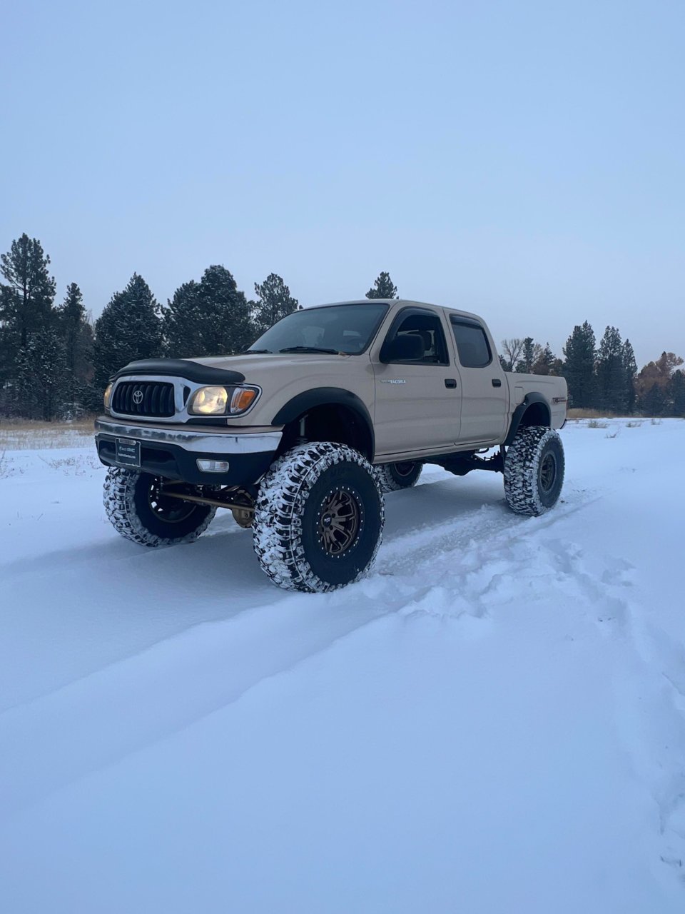

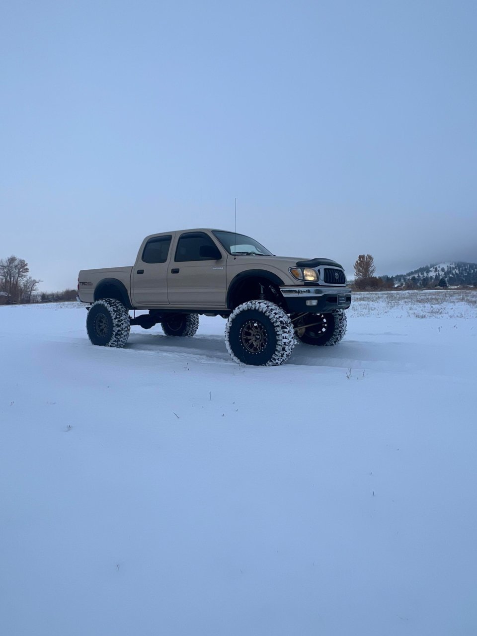

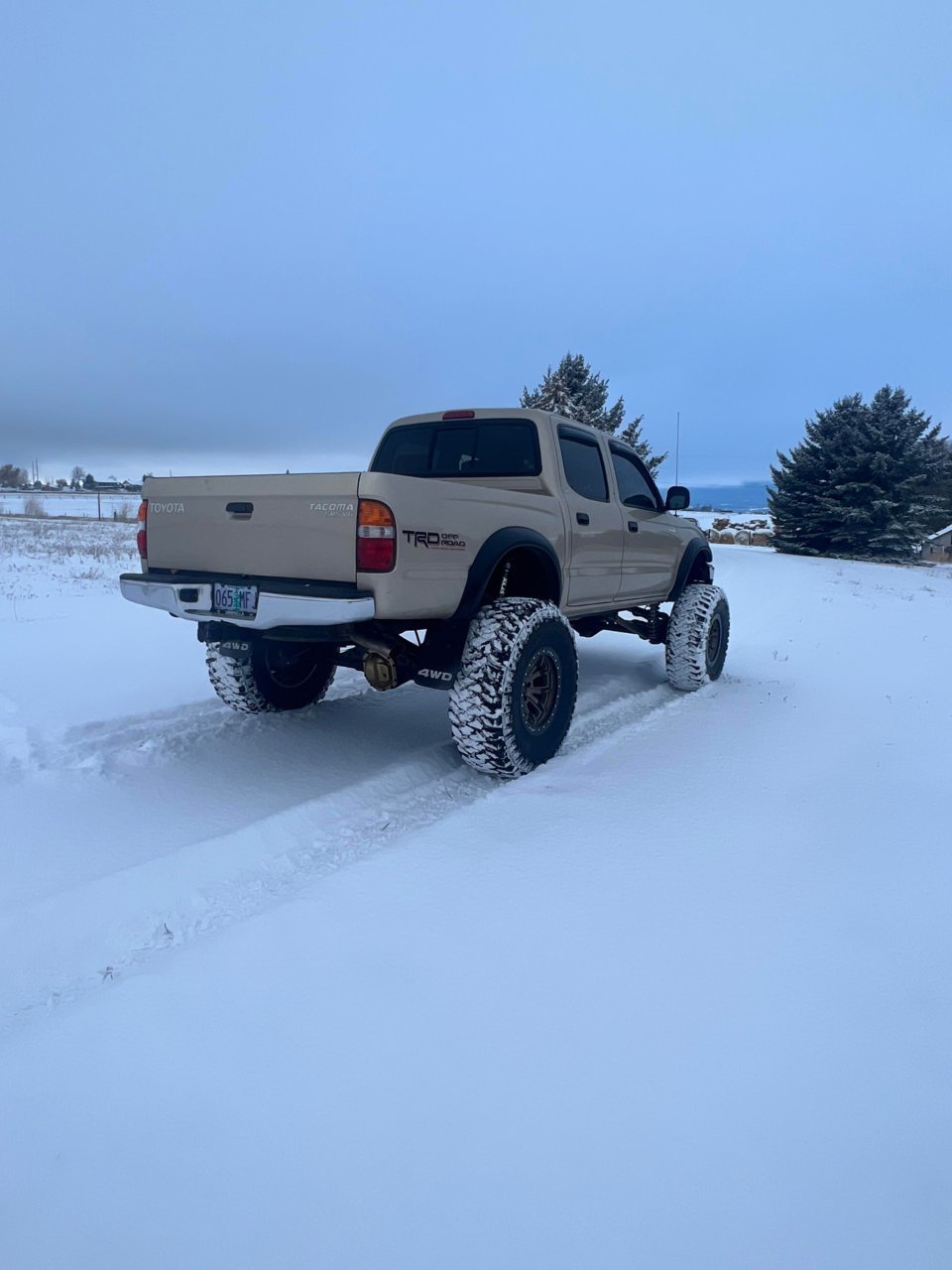

    In the testing phase. 314691404_531178351786303_4281885536192122547_n.jpg 314527909_667595731748179_7588381493994265933_n.jpg 314505089_499433698791056_8810159024659285128_n.jpg

    6,393
    Planet: EARTH
    Sweet

    I'll get better pics shortly

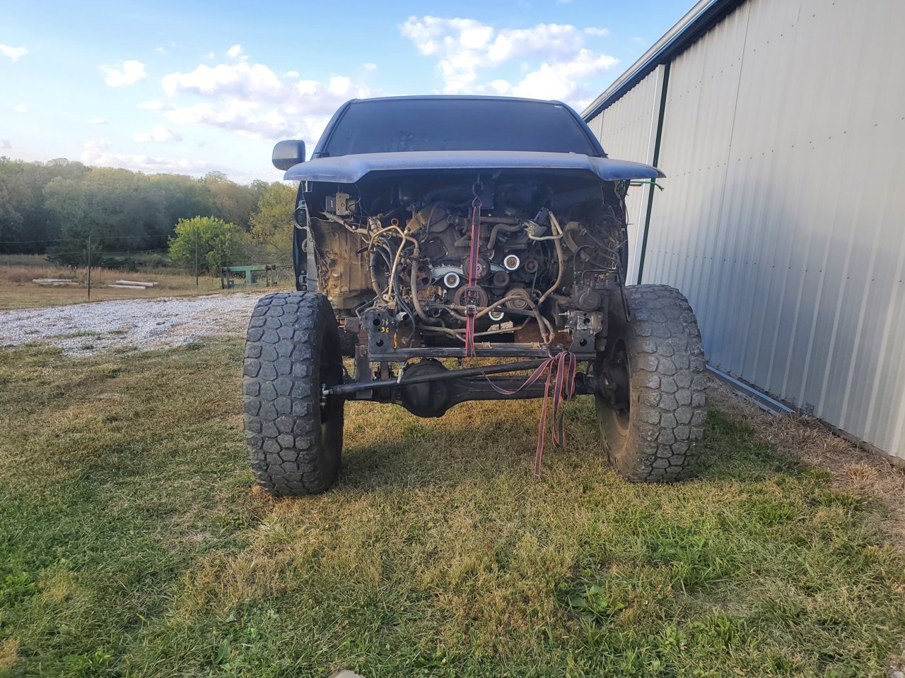

    New here in this thread but just completed the majority of my SAS on my 08 tacoma. I did the unconventional and used axles front and rear out of an 80 series LC. My only gripe is if i was confident enough I would have flipped the axle tubes around to make it a driver side drop axle. But i plan on using doubled up rf1a's so passenger side drop will work fine. Truck is taller than i wanted it to be so that will be my big adjustment. I have to clearance my oil pan and mount my shock towers when my shocks come in. Everyone says the 2nd gen tacomas are too heavy but a lot of that weight is in the front IFS. Change that from sprung to unsprung weight and you're similar to a 2nd gen 4runner so not worried about the tcases.
    And yes i know its ugly. The truck got cut off by an idiot on a county highway at 65. Frame was fixed and now its the dedicated crawler

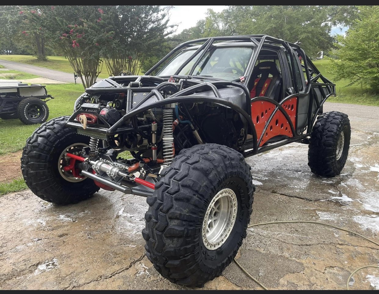

    There are four link Tacomas out there if that’s what you’re referring to. Here’s a first gen from a Georgia group. Link placement will be similar for me. Small gain in uptravel especially with full hydro, but far less flex steer than three link.

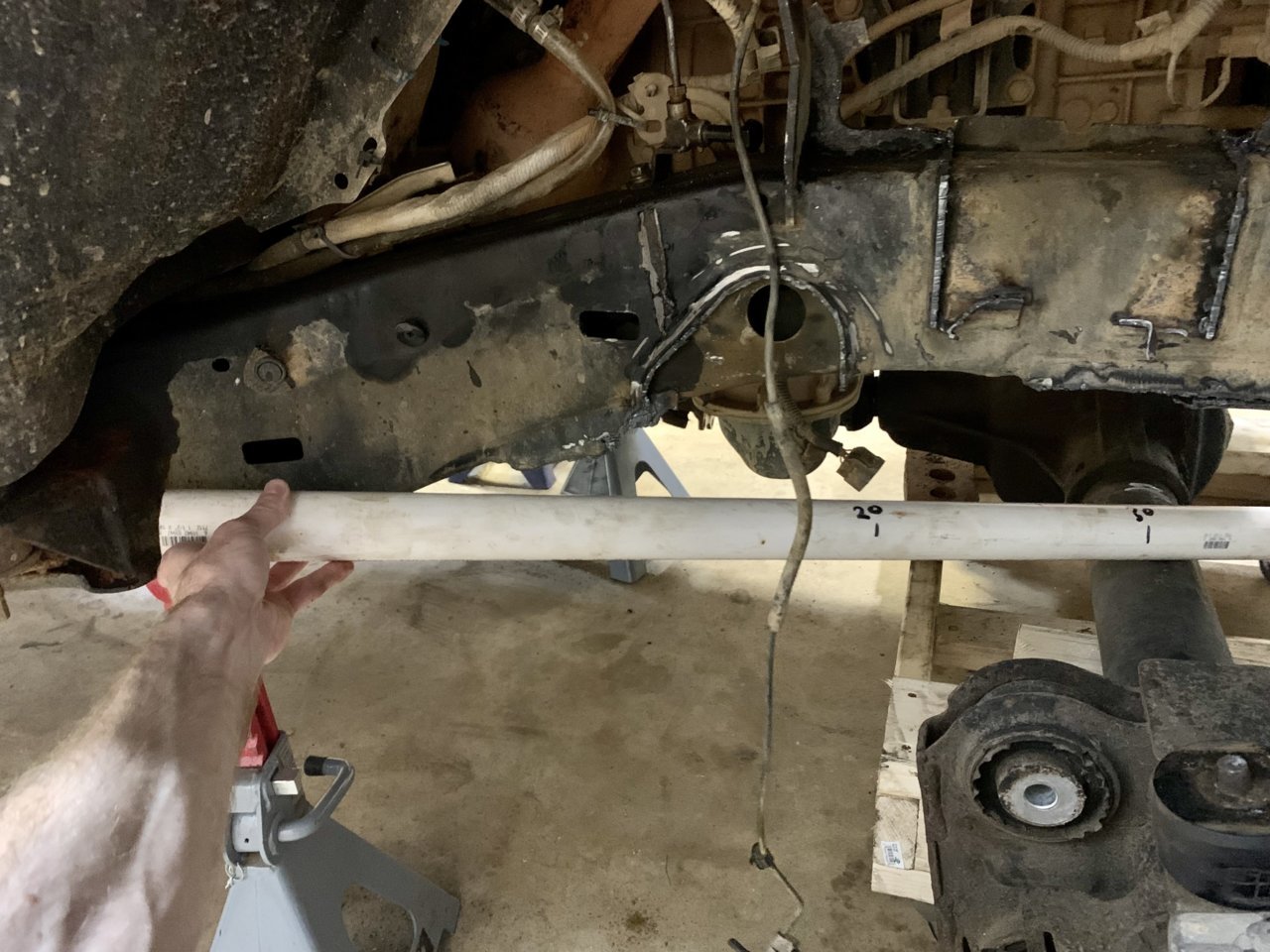

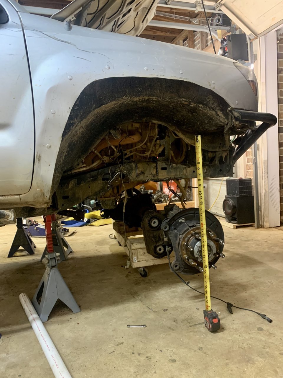

    Here’s what I have come up with so far before trussing the axles- 136-138” wheelbase. Fully triangulated upper and lowers. 32” lowers, 40” uppers. Artec low profile truss should allow a decent link separation at the axle while allowing the best uptravel possible. Top of the tape measure is the height of a 43” tire. Possible upper link placement in the other picture. Will likely notch the frame.

    3-link vs 4-link has nothing to do with flex steer. That is 100% a function of link length and with short links like you are planning, you will have flex steer.
    You do you though. I'll be curious how it turns out when you actually start cycling the axle and landing links.

    Probably more dependent on triangulation for four link and length for three link if comparing the two, but yes longer links help. Either way with lowers around 40” and cycling 14” coilovers it will likely be negligible in the real world. We will see what’s what when everything is cycled. Axle truss and axle centerline might get in the way. I don’t think a four link is impossible to do correctly though. What length links were you able to fit?
