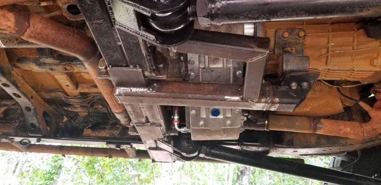

    That's what I did, brought my lowers in a bit more. This is the only picture I have of the mount, in it early stages. I've since added a mount for the altas case incorporated into it and clocked the atlas a bit more.

    Very cool. I bought one of the front range mounts and I’m going to try to figure out a removable lower link mount. Maybe thick DOM or square tube.

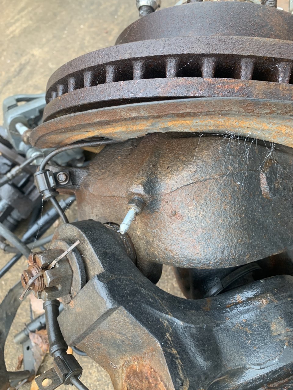

    What in the world do I do about these vent things? Haha

    Put a plug in them. For the factory vacuum actuator to lock the hubs in

    So they will stay locked plugged up and the hubs engaged?
