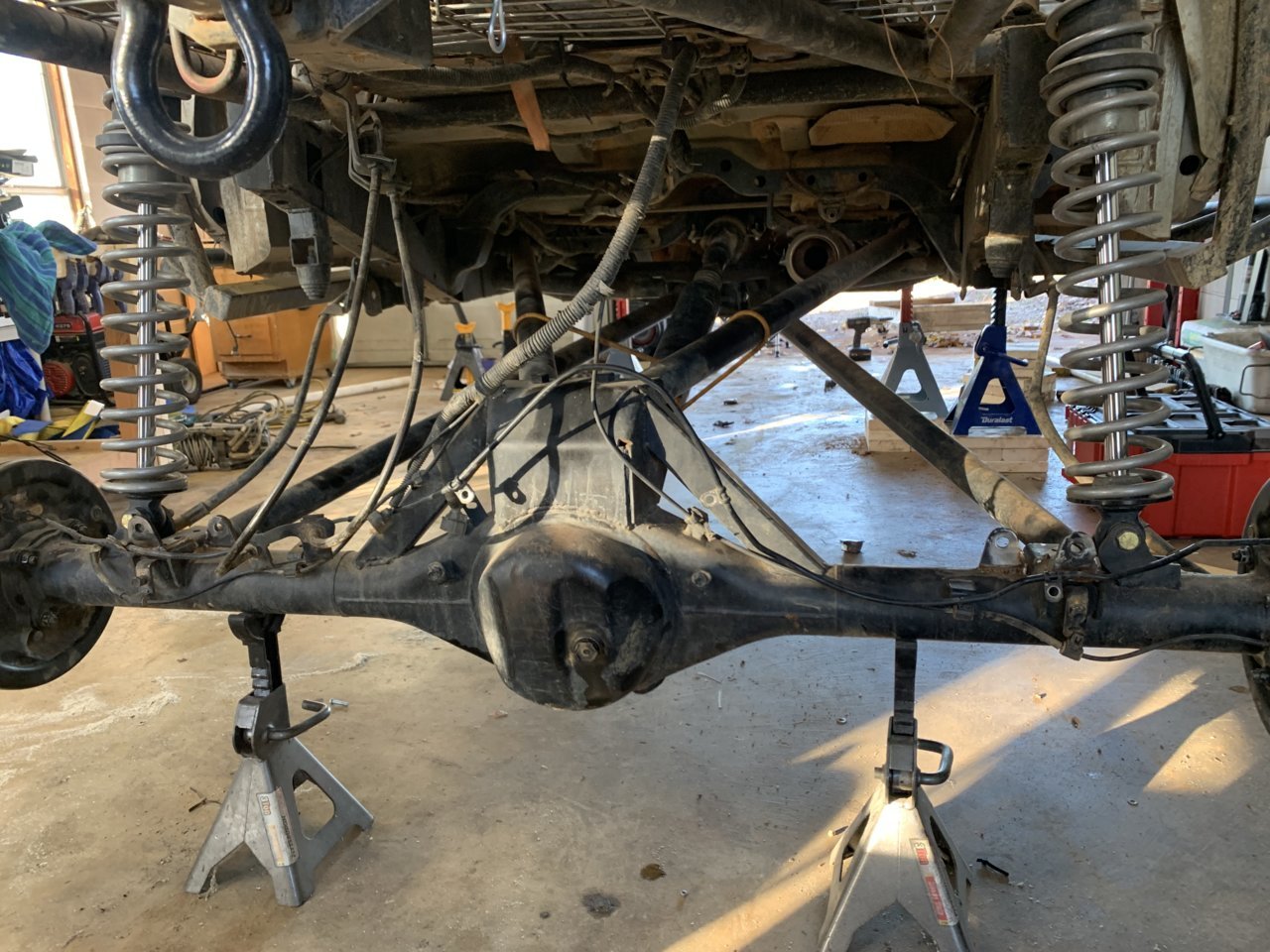

    2019 f250 6”lift 37s deleted 1997 T4r, tons and 4ds
    1997 t4r has super duty axles, 5.13s locked front and rear. 3 link front with 14" kings. Rear 63s.
    Nope. They will be unlocked. The vacuum engages the hubs.

    It’s all new to me. What needs to happen to make sure I can keep them engaged all the time? I don’t see any point to having them disengaged for a trail only rig.

    Turn the hubs to engaged

    So it doesn’t need the vacuum to keep them engaged?

    If you don't ever plan on driving it on the street, just swap in drive slugs and ditch the manual hubs.

    I don’t, so that’ll work. I don’t think the rear has the vacuum ports so it should be fine as is.

    Rear axles of any vehicle typically don't have selectable rear hubs

    I welded those holes shut. I kept the locking hubs, even though mine is a trail only rig, sometimes it is nice to be able to drive around where we are offroading without the constant fight of the wheel. But if you're full hydro then that would probably be negligible. Slugs would be a solid option

    Good deal. I think the ECGS slugs are $200, so I may just do that while everything’s torn apart for piece of mind.
