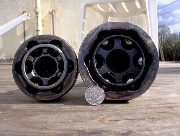

    What's the strength difference on mini outers vs. fj/fzj80?
    I'm not super concerned about needing a spare third. It'll get trailered to parks if I'm doing "hard" shit. If I drive it on trips then I'll be easier on it.

    actual strength, unknown. but here's the size difference.
    mini vs 80

    I'd say it matters. FJ80 outers definitely steer tighter than mini's and are substantially stronger. I've seen John break 2 birfs with his FJ60 front under his 3.4 swapped second gen in the last 3 years and I've broken one too. I'd call the outers the weak point in my drivetrain at this point.
