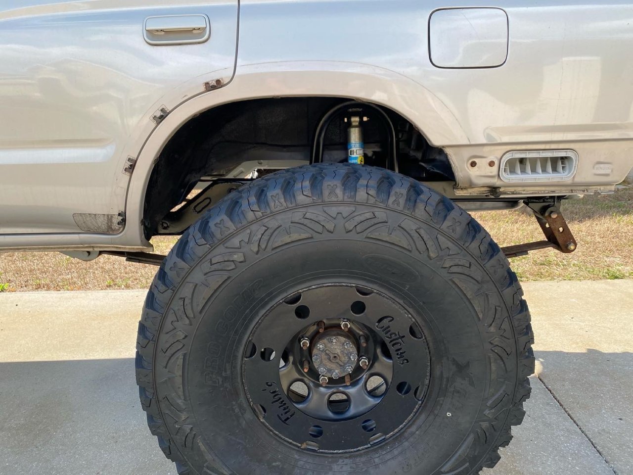

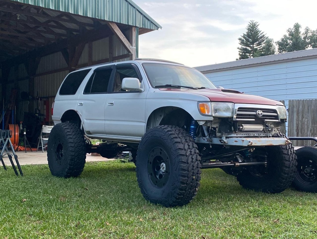

    1997 t4r has super duty axles, 5.13s locked front and rear. 3 link front with 14" kings. Rear 63s.
    This one is on superduty axles and 37s. Kinda wish I didn’t stretch my wheel base to fit the 40s. Front fenders were trimmed for the previous setup

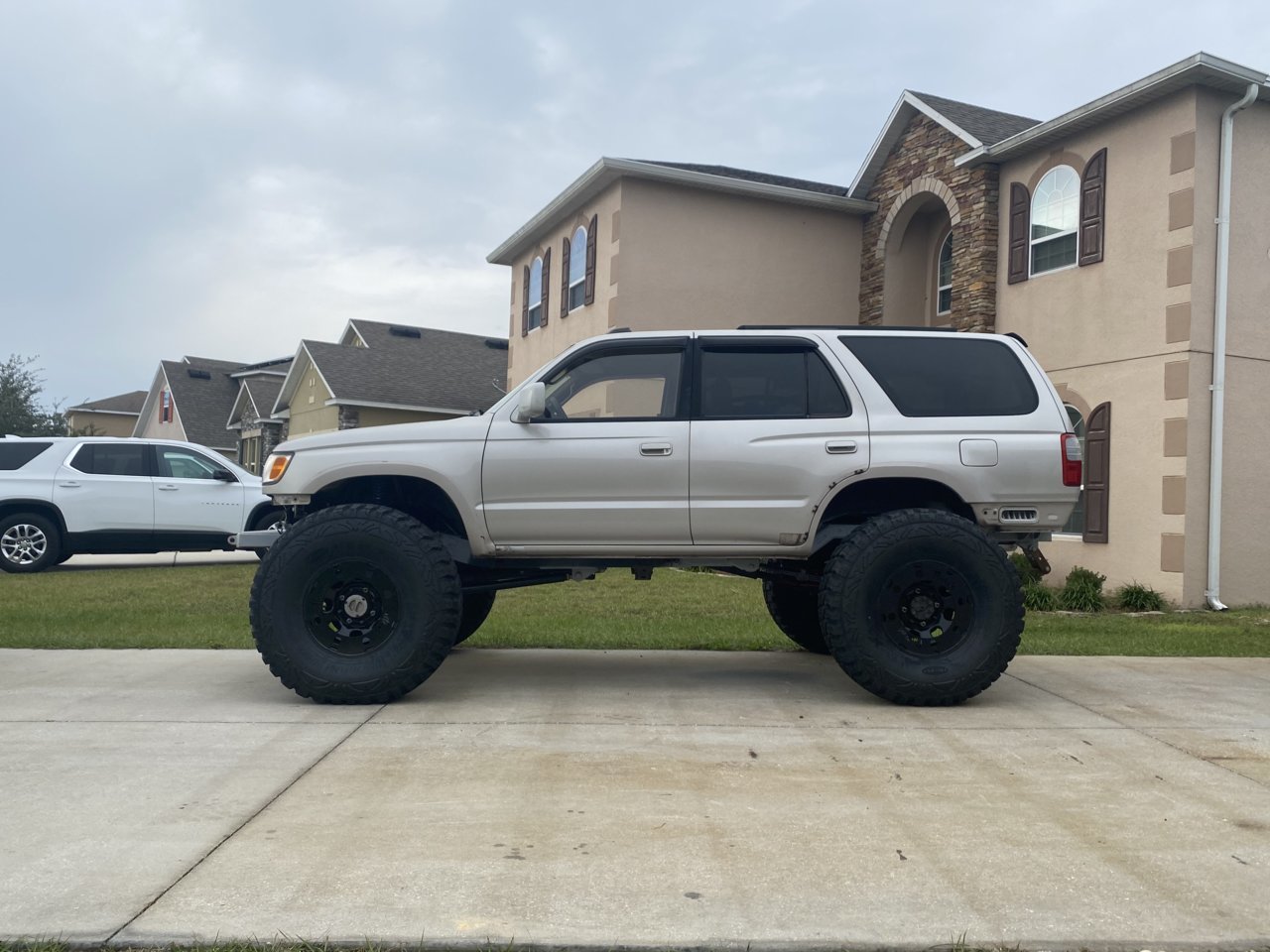

    Can we see some full pics?

    Great stance. I used to get a lot of hate for sitting down on my 49s...was leaf sprung. Everyone wanted to bring up "up travel" with me. Id post pics but that was almost 20 yrs of phones ago..
    Do u have any suspension pics?

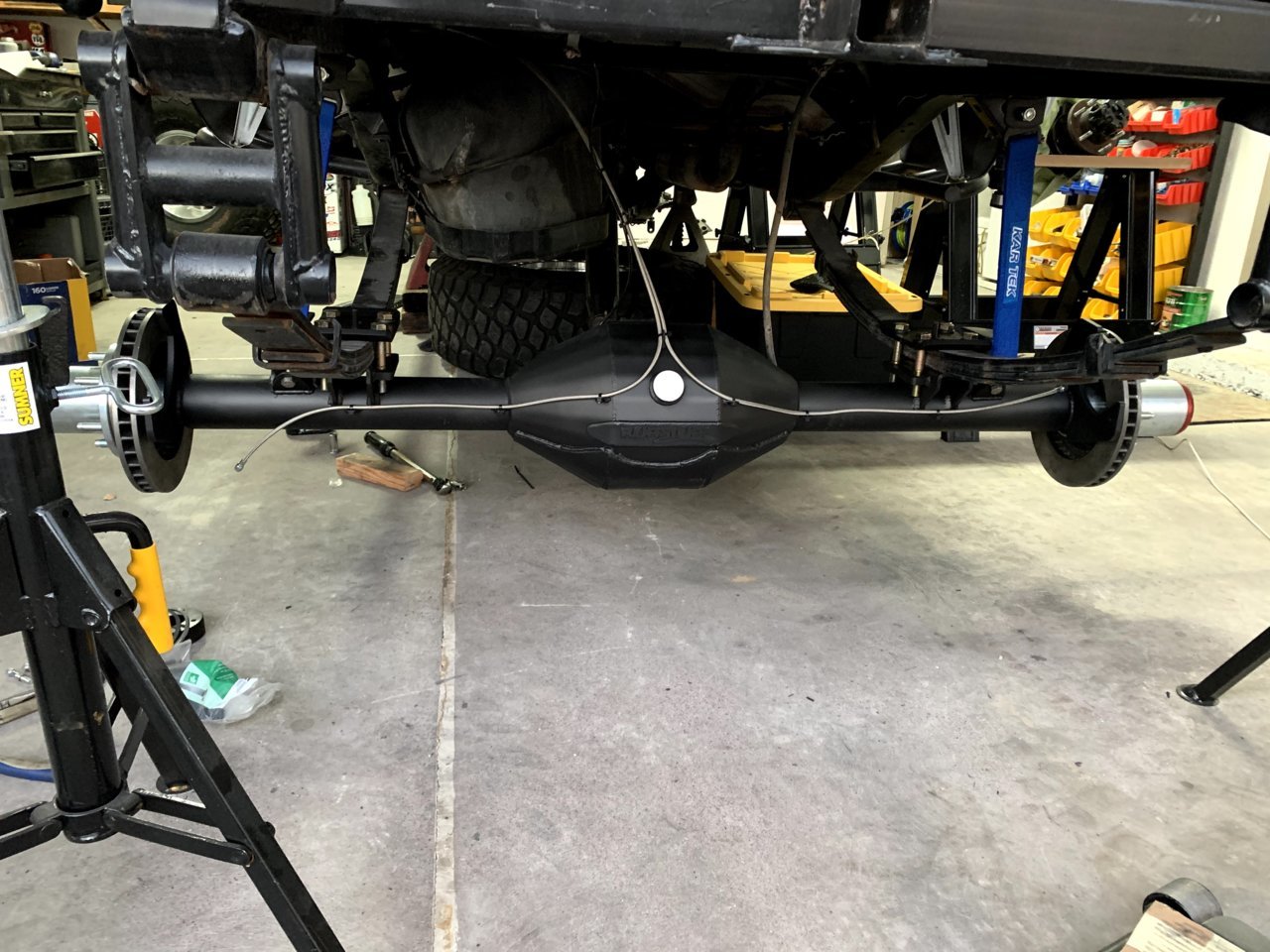

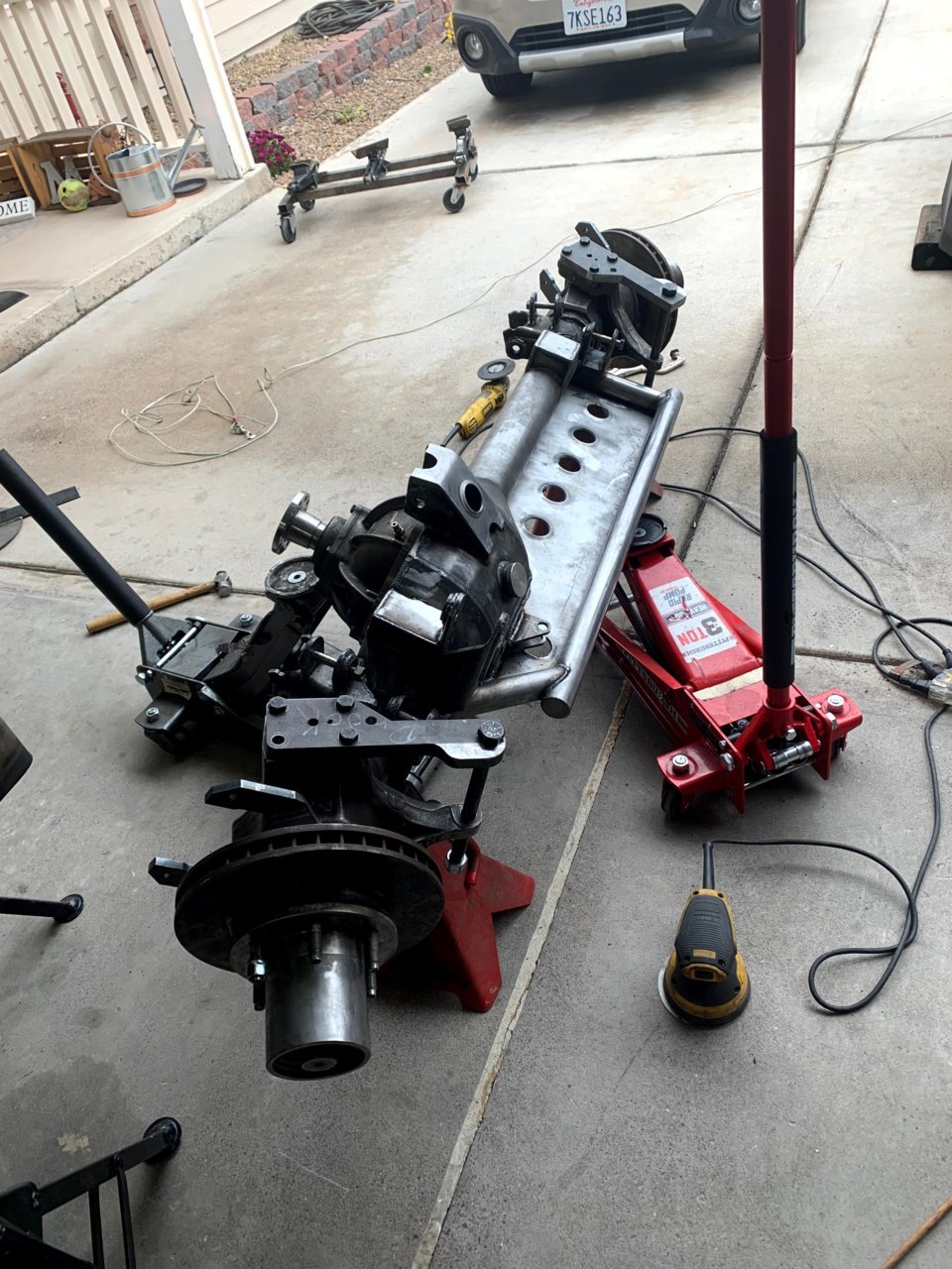

    Heard we where talking about fabd housings… you know my answer. Ruffstuff 609s… I’d consider the trail gear housings as well. They’re roller kits are great price point. If you don’t have to run a high pinion front and can source used inner cs and knuckles, the front axle comes out close to the same as building a junkyard 60 in my experience. Of course that’s doing all your own fab work. 00E6D9FA-3824-4A3D-83FD-B7B74BFD147B.jpgA8FB3504-9465-41FB-B32C-71A00047B4E0.jpg

    I have some in the build thread
