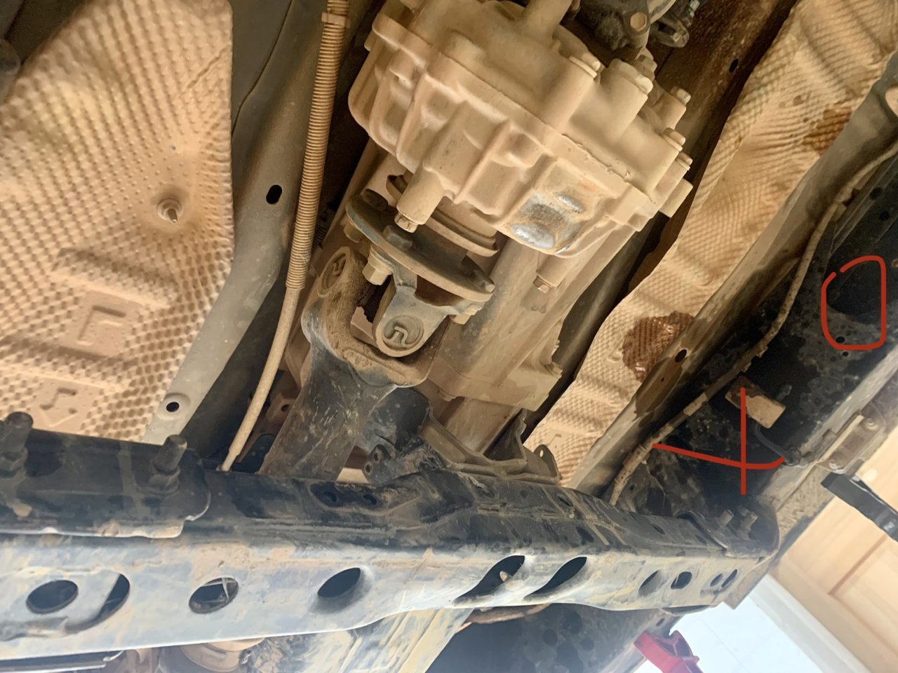

    I’m debating doing a solid lower link crossmember right underneath my tcase actuator. This would allow for slightly longer links and a more rigid connection. I was originally going to make a removable crossmember underneath the driveshaft. I wonder how much of a pain it would be to get the tranny out if you had to pull the tcase out first? I’m paranoid about locking myself in and having to cut tube if the trans ever had to come out…
    terrible picture, but proposed removable lower link crossmember at “x” or proposed permanent crossmember at “o”

    Maybe im not on the same page but could the mount/crossmember be made modular? Like where the link mounts could be static to the frame and the crossmember be bolted between them?

    If I could get more triangulation with the uppers that would definitely be a feasible solution. Unfortunately, they can only clock in about 6 degrees each, so I will need my lowers to be maxed out.

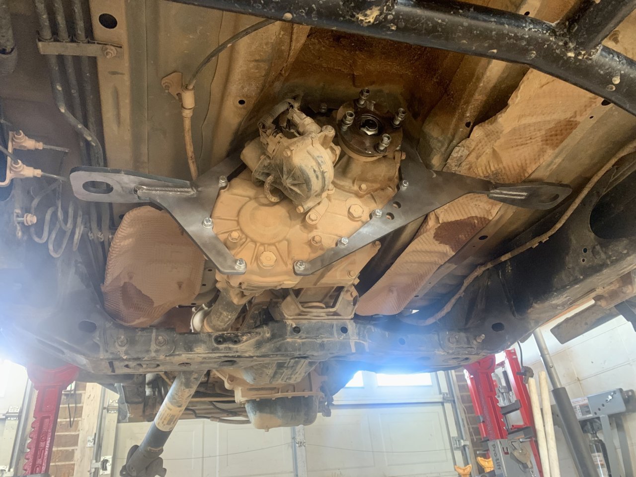

    I’ve probably laid under the truck for hours at this point placing things haha I think if the trans can still come out this may be a viable solution. Would allow me to tie in to the rear mounts and make a really nice flat belly skid like the jeepers.

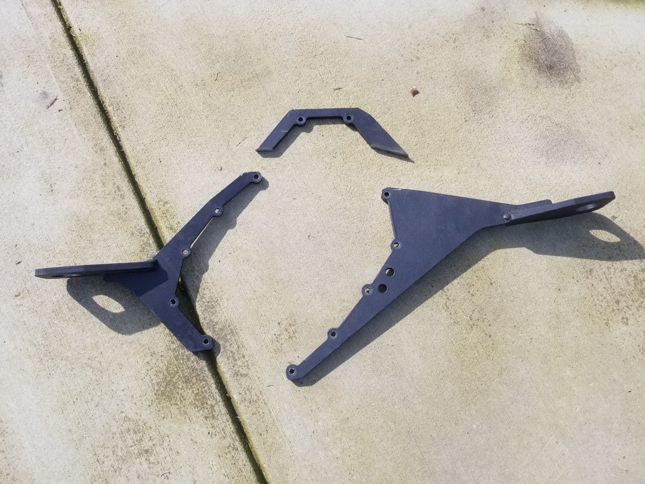

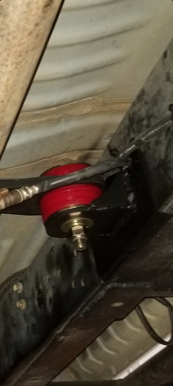

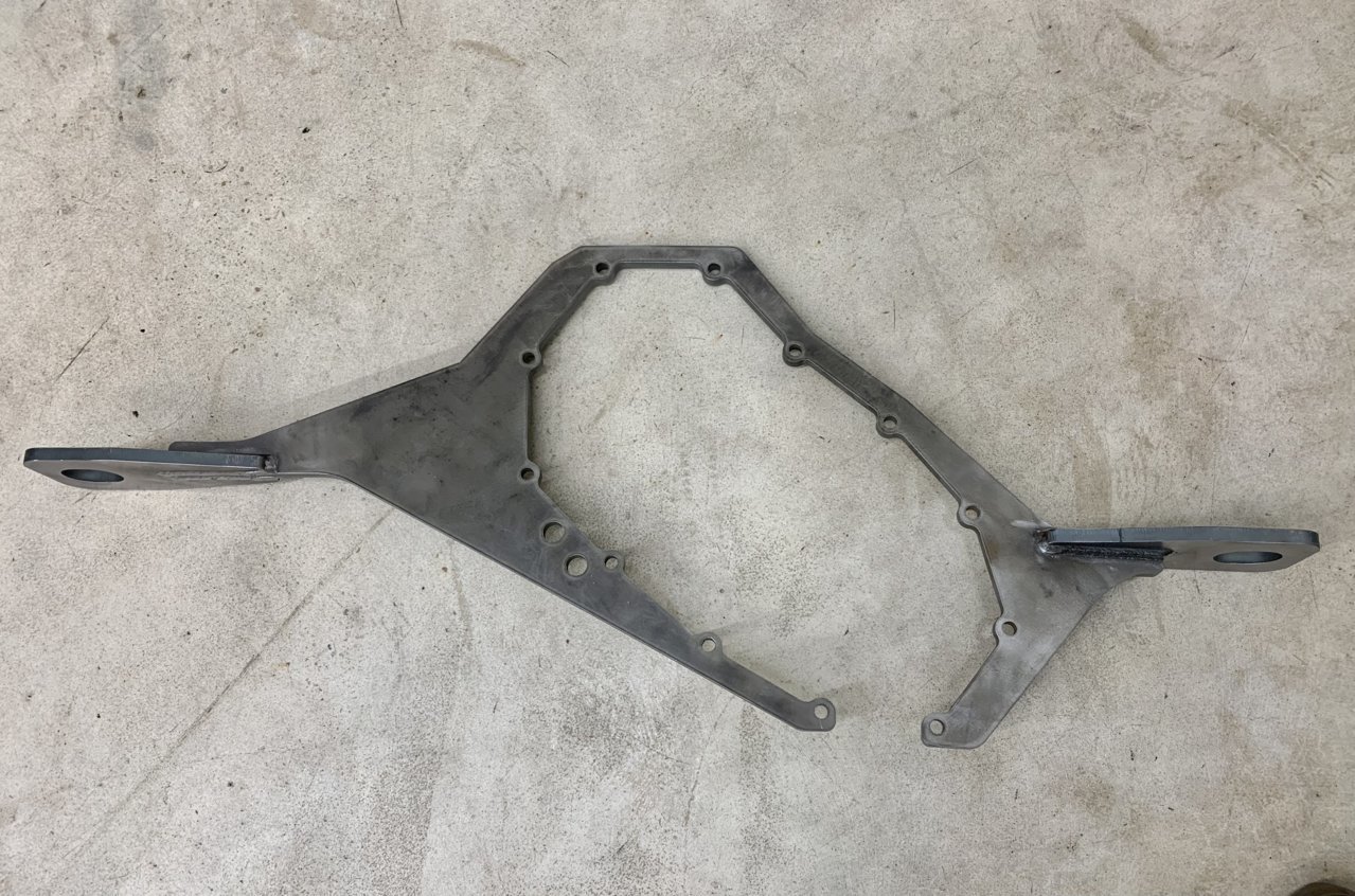

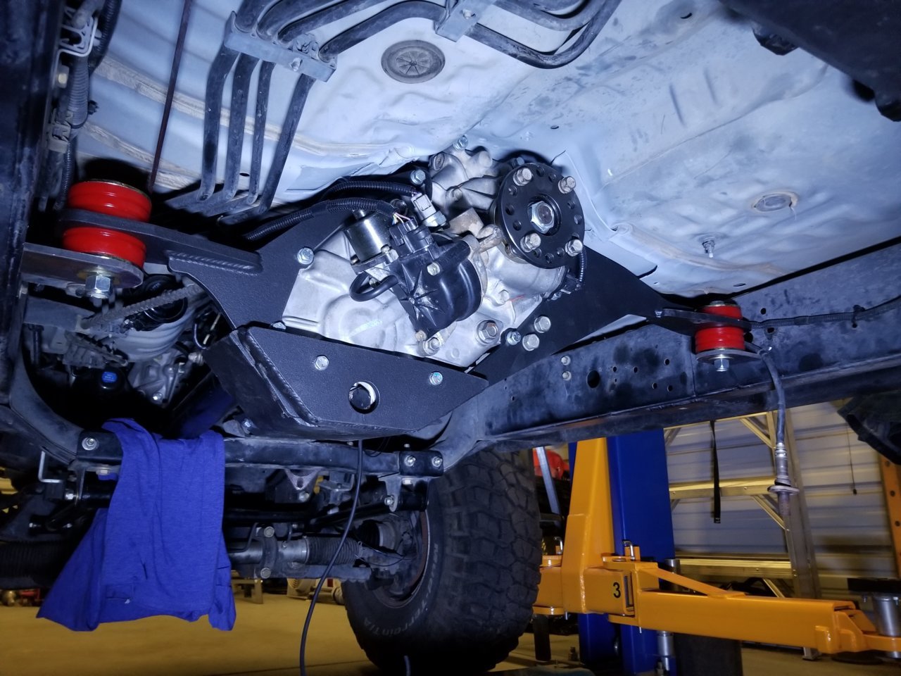

    To answer my own question, it requires some dickery. It required trimming on the passenger side and I cut out the section where the wires are up top. The bushing mounts are too close to the cab so I’ll be buying one of the removable crossmember kits from Barnes or the like and welding some .25” wall DOM to the bottom.

    Why not build your own mount ?
    Wulf likes this.
  19. Dec 18, 2022 at 5:18 PM
    Dayman Karate
    Dayman Karate Ruffling feathers and turning eagles into vultures
    Dec 18, 2017
    #238838
    4,719
    Clay
    Central Alabama
    2001 4Runner, JKU Rubicon
    https://www.tacomaworld.com/threads/daymans-karate-class-but-you-wont-learn-nothin-4-link-lt-and-previous-iterations.755134/
    Thought about it, but liked how tucked up and further back this one is. Was going to build a removable link/trans mount all in one, but decided the links would be further back and it seemed risky having both mounted “together” even though it’d be isolated with a bushing.

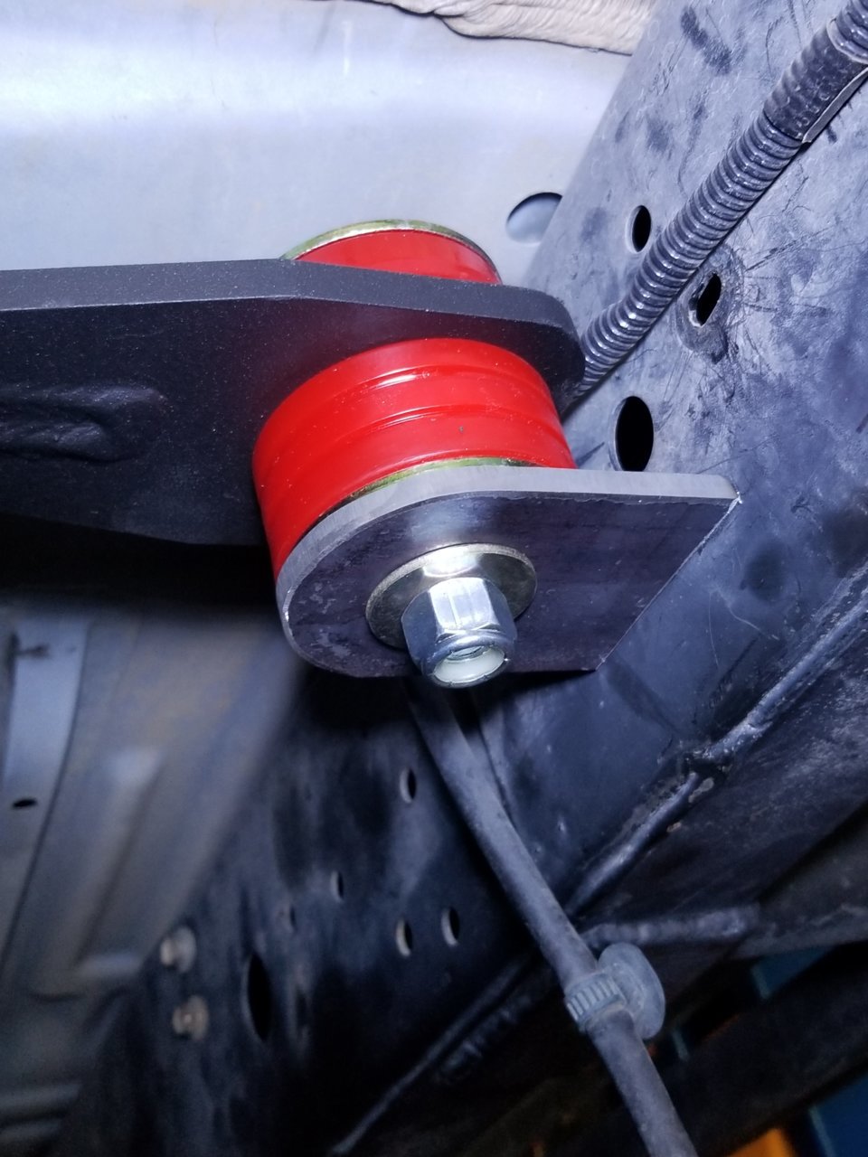

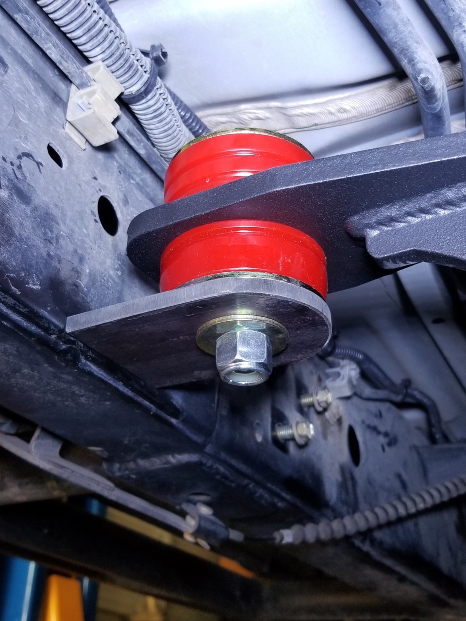

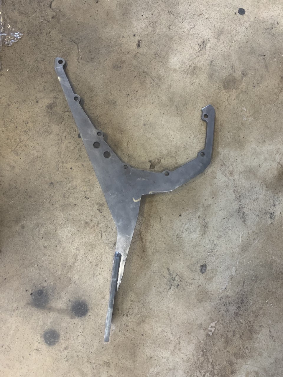

    Damn... that's way off. Mines not like that and the flat mount they provided for the frame is effin short as f#ck. Made my own. Braced both side for support and as you can see, there's barely enough room for the poly bushing, for the passenger side.
