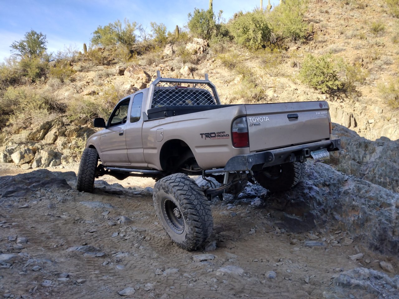

  16. Dec 20, 2022 at 8:15 AM
    Wulf
    Wulf no brain just damage
    Jan 30, 2015
    #147523
    61,983
    rock raisin
  17. Dec 20, 2022 at 8:17 AM
    02hilux
    02hilux What do you mean there’s no road, I’m here
    Sep 14, 2016
    #197244
    6,312
    Planet: EARTH
    That's the same image toy brolanders use... :D
  18. Dec 20, 2022 at 8:21 AM
    Wulf
    Jan 30, 2015
    #147523
    61,983
    rock raisin
    02hilux[QUOTED] likes this.
