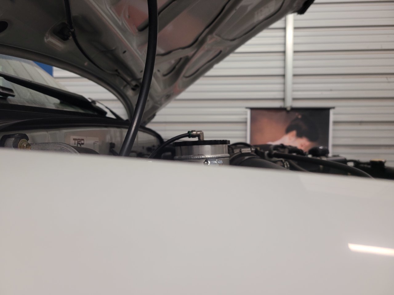

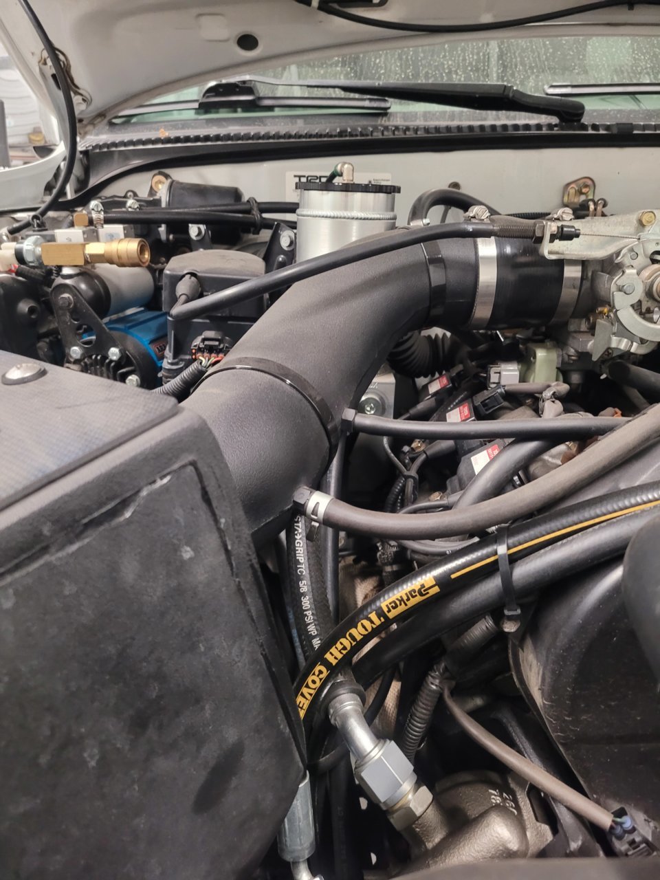

    Yeah I had to do some digging to find out why the PSC res was all that. They don't advertise much about it for the price but there's a reason why I guess they're the standard for full hydro setups
    mounting it up high enough is slightly problematic. I think i recall seeing one rig where it was poking through the hood lol

    Yep. Mine's not protruding through the hood but it is as high as possible, barely clear the hood. It is above all engine bay components.
    I definitely like the size of the reservoir, changeable filter, and fitting location designed.
