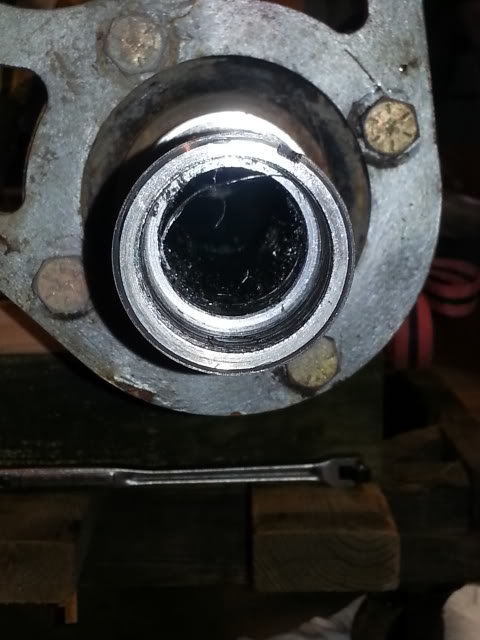

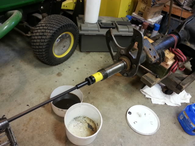

    Started boring the spindles on my D60 rear:
    You can see how little you actually need to enlarge them for 35 spline :D
    1-9/16" hole saw with a 1-3/8" hole saw mounted inside it as a guide.

    Holy shit! I just had flashbacks of doing that myself LOL Did I post that idea somewhere on the internet? I could've swore I came up with it but I can't remember exactly. What a pain in the ass, time consuming job!

    Actually I ran across it over here:
    http://www.naxja.org/forum/showthread.php?t=933793
    And I found by adding a few more chip relief holes on the inner holesaw I didnt have to stop and clear chips as much. I could cut almost and 1/8" at a time before clearing chips. I used the old gear oil from the diff for cutting oil, and am still on the first hole saw.
