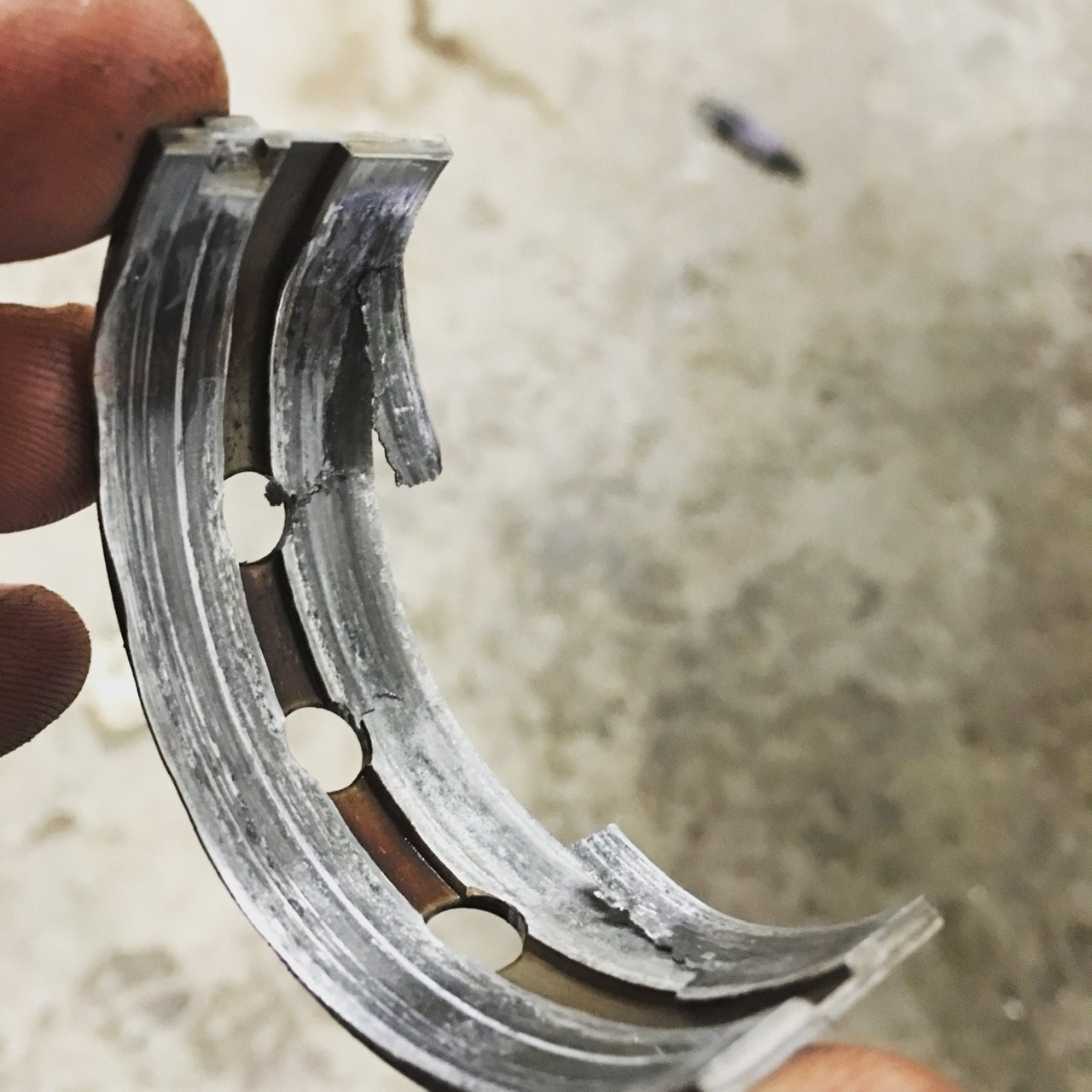

    Mains largely. First block/crank was trashed by the time I caught it. Second time I caught it early and rolled new bearings in it. Balance shaft oiling is garbage on the 3RZ on angles so cutting the balance shaft chain is mandatory to me now
    First time #1 main:
    Second time #1 main:

    I could see the first time making plenty of glitter in the oil, but that second set doesn't look terrible as far as toasted main bearings go.
