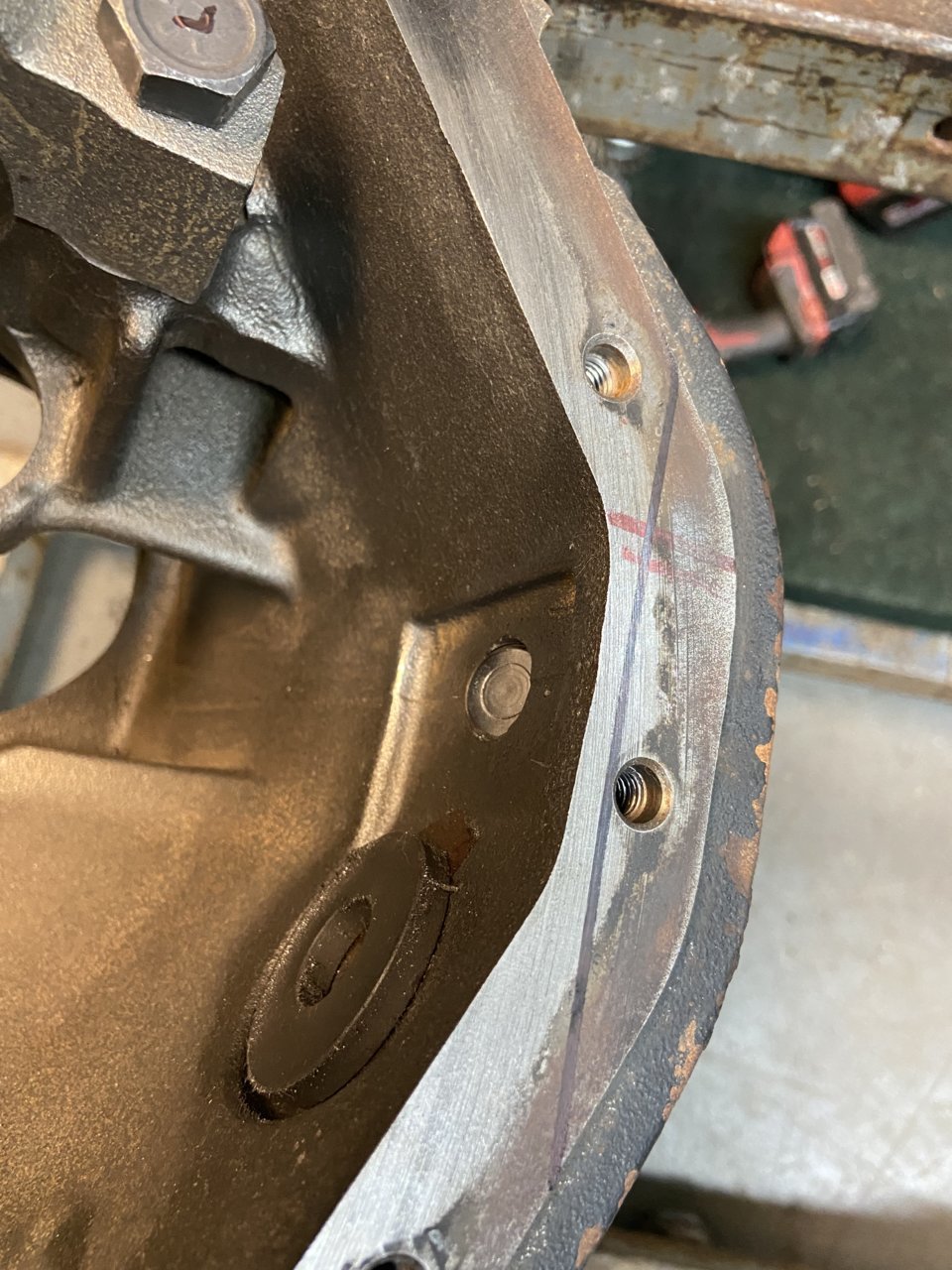

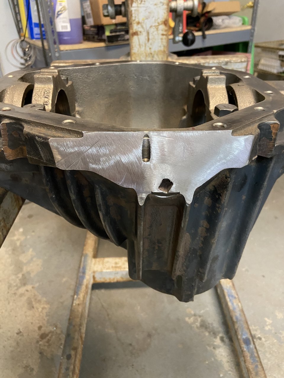

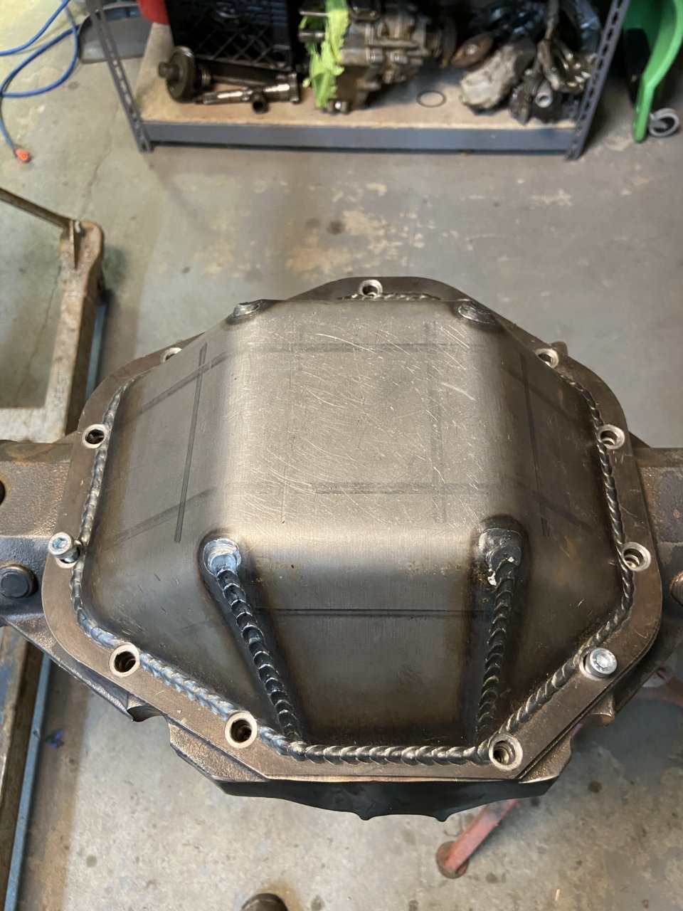

    14 bolt is easy to shave. Took about an hour to cut, weld and smooth out. I think I got the cover from Barnes and just cut that shit 1/4" below cover w band saw at the angle my diff was gonna be (cut is level w/ ground). SD not even in the same universe to get usable.
