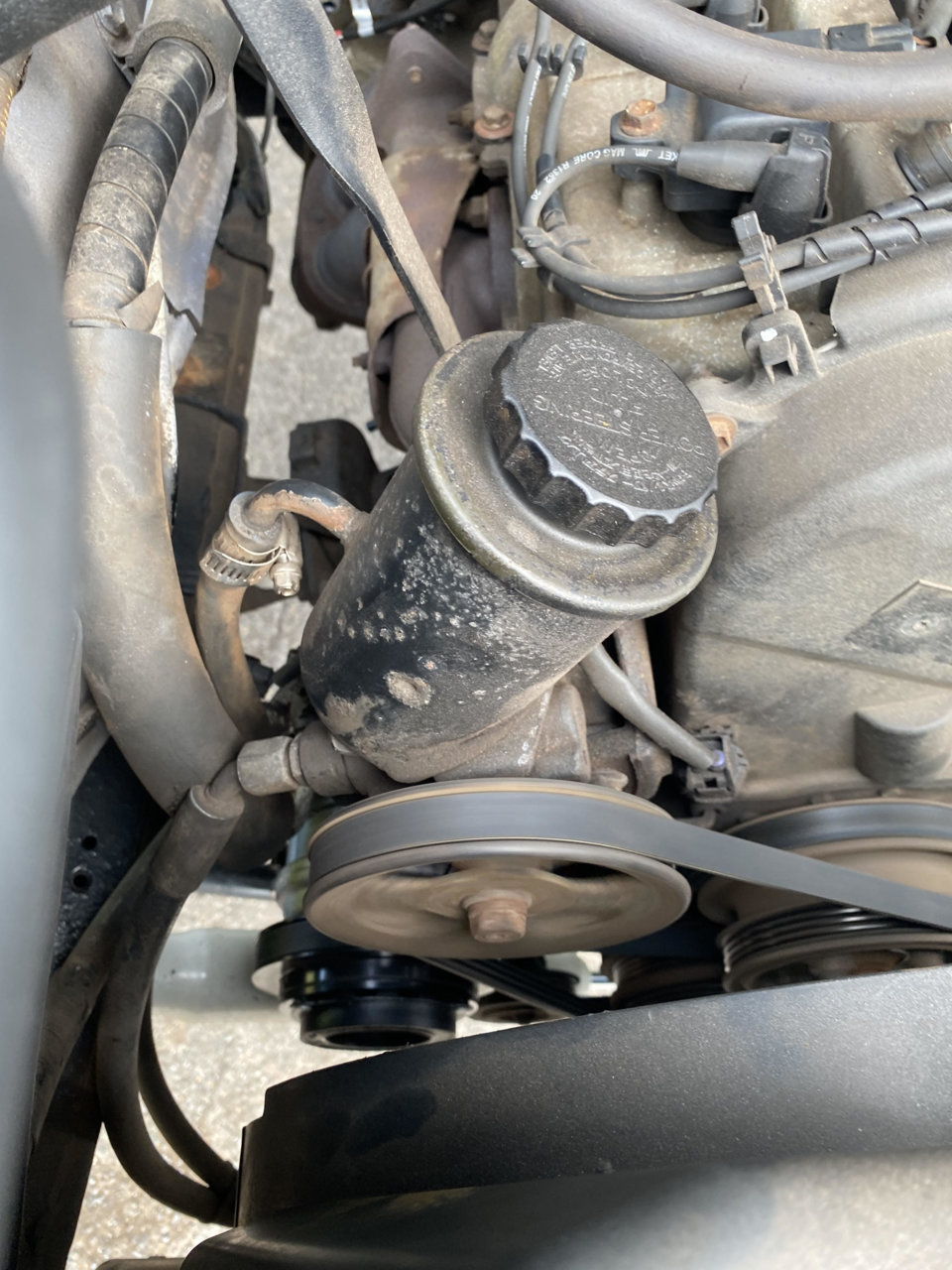

    Steer kit have nothing to do with the power steering components.
    You're on 31 and having issue? Weird. I know folks with 35/37 on stock pump and no ram without issue with in town driving. Pump going bad.and not providing adequate pressure?

    Stock Pwr Str pump?
    What fluid?
    How old is the fluid?
    Screen clogged?
    Rubber hoses swelled decreasing volume?
    Rubber hoses cracked absorbing air/water?
    Installed hydro assist?
    Bubbles/calvatation?
    What fluid?
    Steering cooler?
    Air pocket in hoses?
    Aftermarket steering pump?
    Wulf likes this.

    factory 3.4 pump + res? remove the res and clean the screen at the bottom

    I messaged one of the dudes who worked on the truck, it’s the stock res and pump, I think I need to upgrade, fix geometry, and I need to do tie rods too.
    I’ll post pictures tomorrow in the day light and we can all talk about it

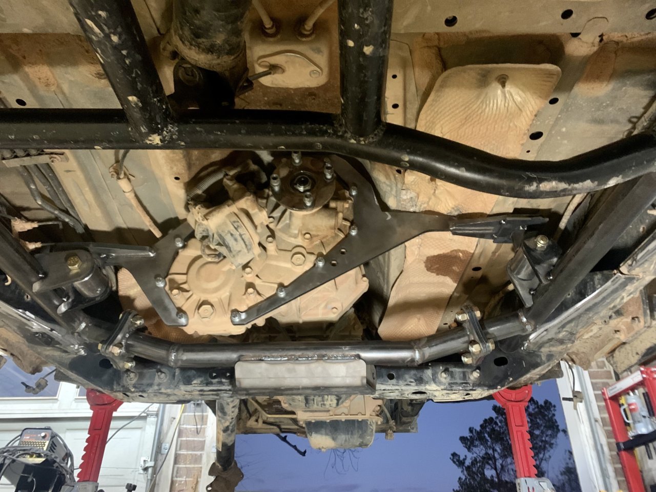

    Dayman Karate
    Dayman Karate Well-Known Member
    Dec 18, 2017
    #238838
    4,722
    Clay
    Central Alabama
    JKU Rubicon
    https://www.tacomaworld.com/threads/daymans-karate-class-but-you-wont-learn-nothin-4-link-lt-and-previous-iterations.755134/

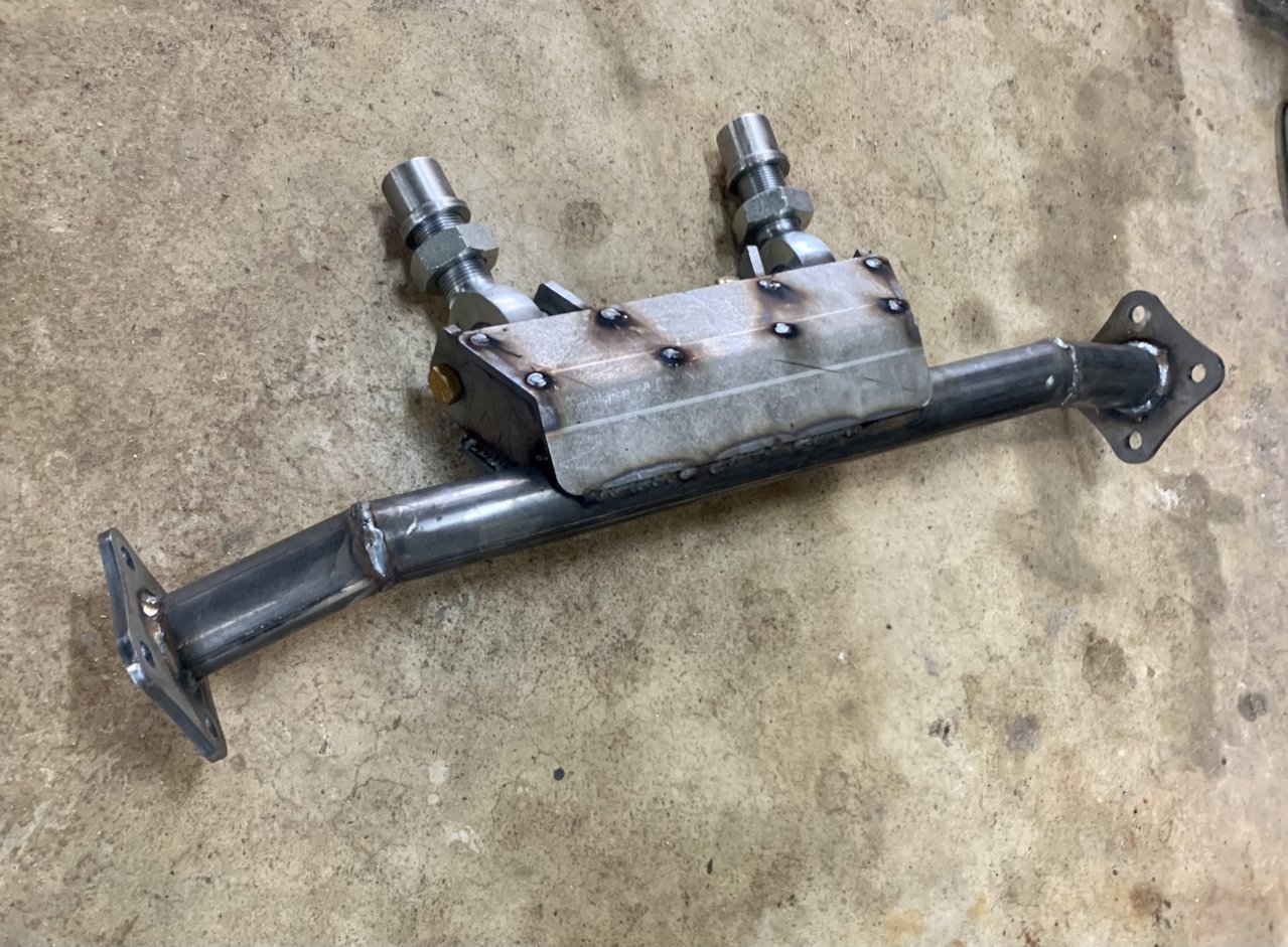

    Man the curves on the frame make things super difficult. Tube city is much easier. Got half my lower link mount and trans mount tacked on. Will likely box everything in once all the tube work is done. Definitely the tube running along the frame rails.
  18. Dec 31, 2022 at 10:04 PM
    Yota X
    Yota X Some say dresser, I say dryer.
    Jul 11, 2019
    #298961
    5,268
    NW New Jersey
    1st gen
    ls turbo, tons, 40's and a partidge in a pear tree
    I feel stupid for asking but what are the hiems going to?
    Dayman Karate[QUOTED] and Wulf like this.
  19. Jan 1, 2023 at 3:18 AM
    v5ensx
    v5ensx CARB legal is not CALI legal
    Sep 19, 2014
    #138656
    1,805
    4 link
    Dayman Karate likes this.
  20. Jan 1, 2023 at 5:26 AM
    Dayman Karate
    Dec 18, 2017
    #238838
    4,722
    Clay
    Central Alabama
    JKU Rubicon
    Lower linky poos. I just bolted them in to finish welding it up.
