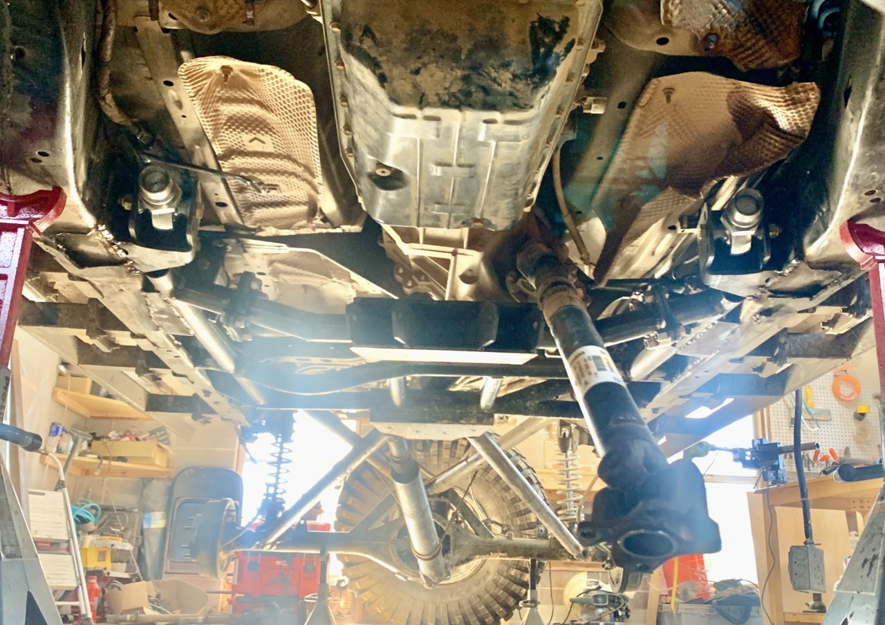

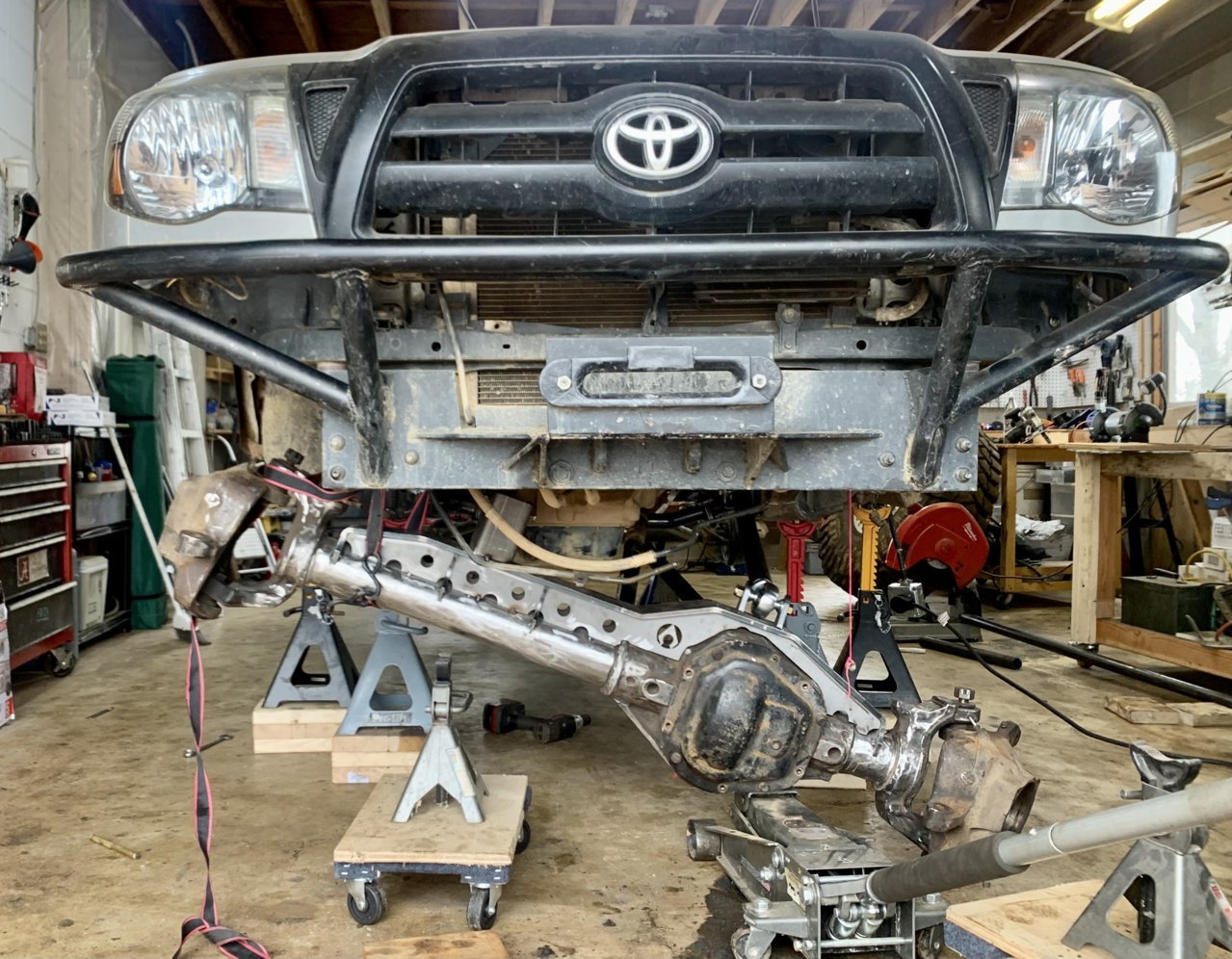

    Upper link mounts tacked on and factory crossmember removed. Need to tack on the axle side stuff then I’ll be ready to cycle things.

    Gotcha. That pic looks diff. It looked like the driveshaft would hit them in the first pic. Looks nice.

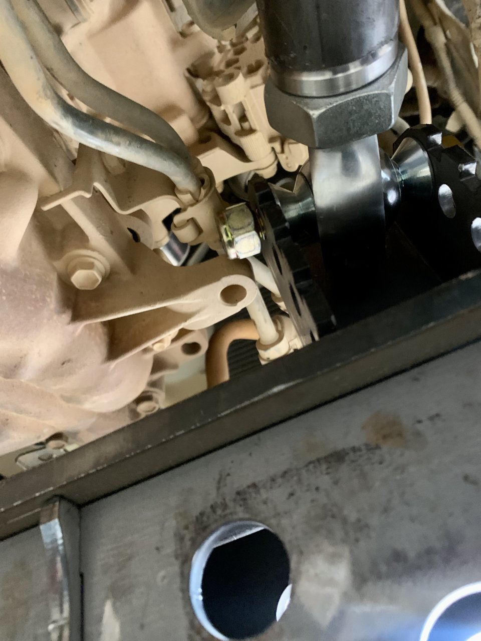

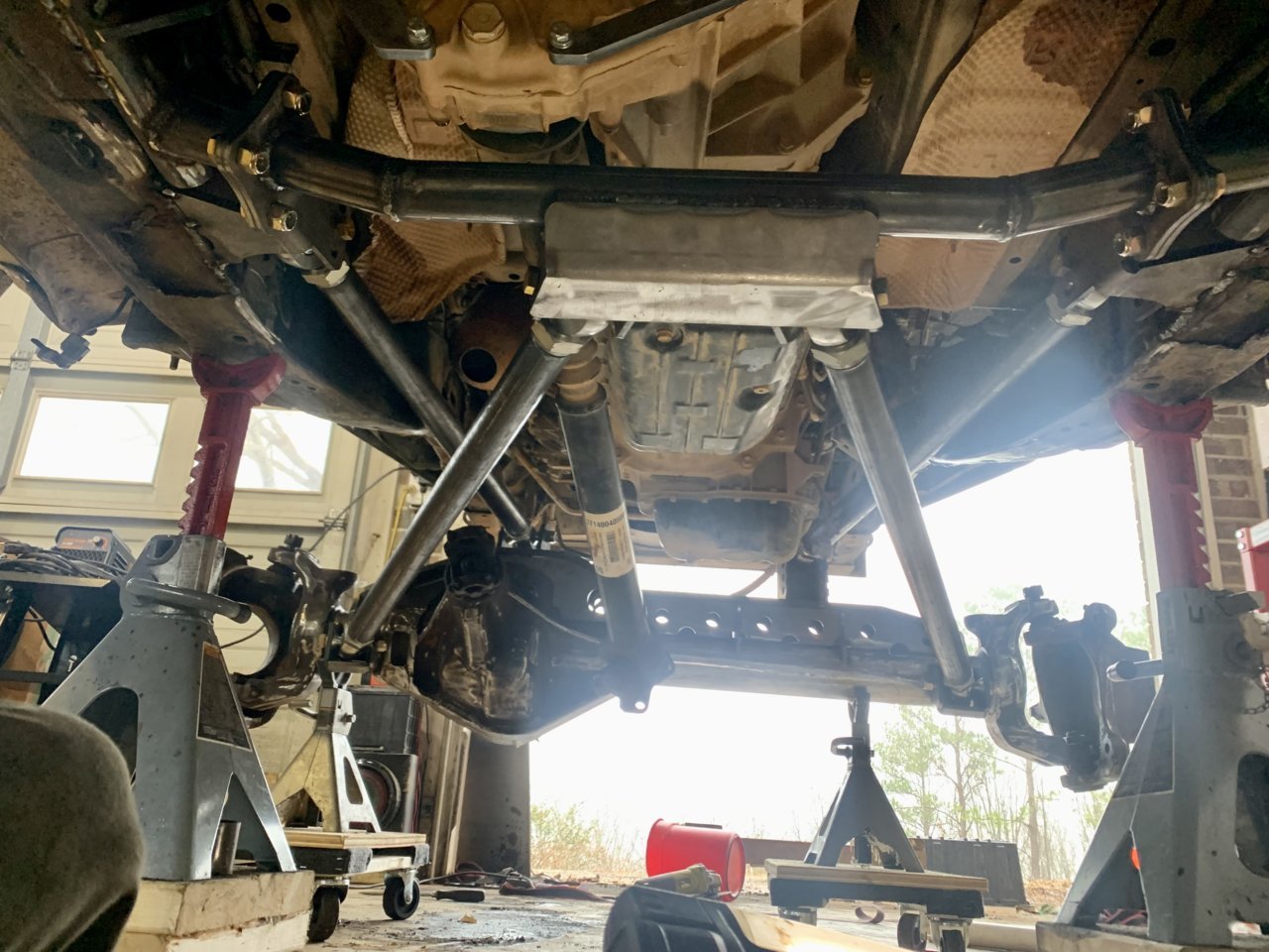

    Four linky cycled smoothly. Need to notch the weird bolt hole off the engine block. I could rearrange the first cat passenger side and maybe get a bit more uptravel but I’m limited by the alternator (edit: not the alternator but whatever is under it lol) on the other end. At 26” frame height it’s 5” uptravel which is alright with me. Before anyone asks yes the lower link mount is getting a lot more support added lol

    1997 t4r has super duty axles, 5.13s locked front and rear. 3 link front with 14" kings. Rear 63s.
    Should have plated the frame where everything is being mounted. Hard to tell if you did

    Yeah everything is plated where a mount or tube connects.

    Exactly! Personally, I would always always encourage people to go wider and skip wheel spacers when possible.
    Well, I was going to ask about the lower link mount lol.
    That main tube piece you used for the crossmember...why not just bend the tube instead? It seems like bending the tube would better preserve the integrity/strength of it vs cutting and welding the end pieces.

    Good question. I didn’t want to bend it because I plan on boxing it in. I’m going to build another removable crossmember about a foot behind it and I’ll run tube from the middle of those junctions straight back to it and box it in similar to an all pro LT lower control arm if that makes any sense. A bend would be extremely difficult for me to box in haha
