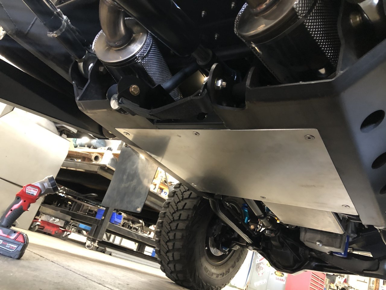

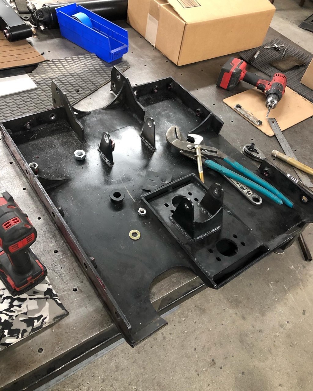

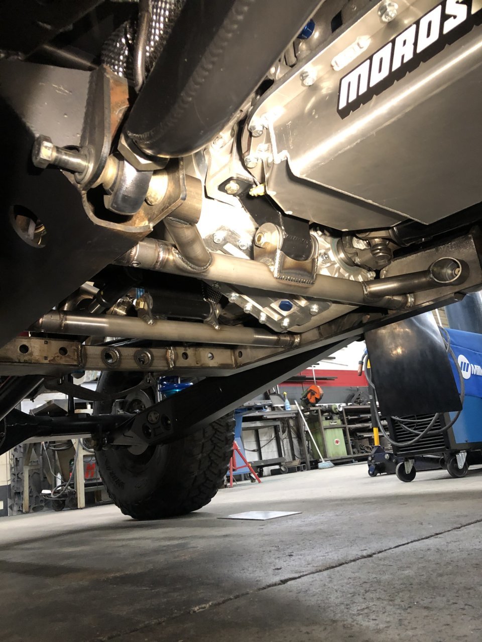

    I had a one piece for years and it was a nightmare… I finally ditched it for removable tubes and 1/8” aluminum skid

    The setup this local guy was quite similar to what you posted. So you agree those "1-piece" designs are a pain!
    But what you have now...wow...what an amazing design. Seriously man, that looks really good. Love the combination of removable tube and plate.
    You're giving me some good ideas. I do not need crossmembers to hold any parts of the driveline necessarily (though I could add some support to the Atlas case), but I do need underbelly protection. The combination of removable tubes and plate could do the trick. I have left over material from the exo cage, so might as well use.
    Thanks for posting those pics. Great fab work.
