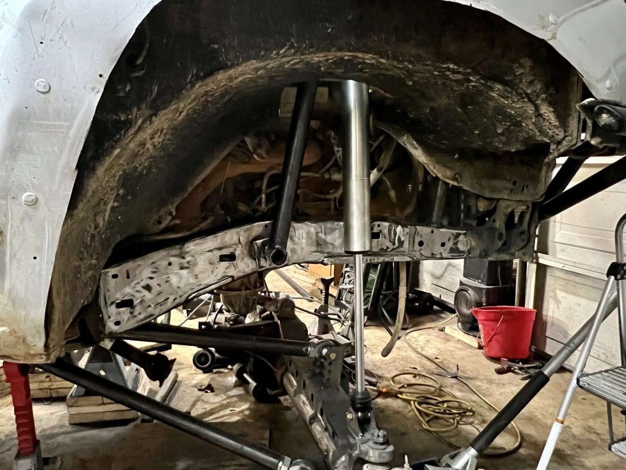

    I’ve got some rearranging to do if I want to keep all the uptravel. Shocks will poke up about 8” through the inner fenders where the top of the tape measure is. I think I can extend a few wires and clock it sideways, but does anyone have suggestions for relocating the fuse box completely? Other side is wide open since I ran the intake to the cowl.
    C4AD4F2F-9CB7-43D6-B881-143495761F68.jpg 552F2F59-F77F-4601-8DE3-8603CFF8B8DE.jpg
    might could mount the coil overs behind the axle right above the lower link mounts. That would lower the amount into the inner fenders, but not sure of the trade offs.

    Nvm, probably going to make a mount above the lower link mounts. That’ll move the shock down to where I’m only 2” into the engine bay and can use the Barnes shock towers I bought. Those little inner c mounts are cute, but not a great fit for the taco.

    Hopefully I won’t have to move it more than what the slack it currently has allows if I move the shock mount behind the axle and down. I’m about to go find out. Really don’t wanna relocate it haha

    Well the inner c mount is the only way to go. If I mount lower behind the axle I can’t go wide enough to clear the frame and the calipers. Can’t notch it because that’s where the engine mounts are. Going to build an engine cage and mount the shocks off of that. Only way to not have the shocks go inverted on full articulation. Anyone else mounting coilovers into the engine bay?

    I moved mine as far as the slack allowed without having to cut/clamp any wires. I know it's a different truck and setup than yours, but maybe you'll get lucky too.
    I think it was very common to have to mount coilovers into the engine bay...at least with the 1st gen Tacomas. With mine at least it was the only way to keep the truck "low" (still not the lowest riding one but good enough for me). This is also the reason why I had to move the fuse box out of the way to make room for the coilover.

    Yeah that’s the only way for me, too. Took a couple hours to figure out where to send tube through, but I shouldn’t have to relocate anything. Still gotta add a lot more bracing, but got a good location where nothing binds and the shocks don’t go past inverted throughout the range of travel.
